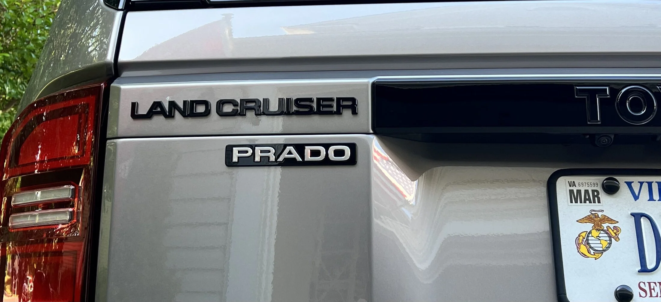

Prado badge for those who want one. Sourced from the Middle East.

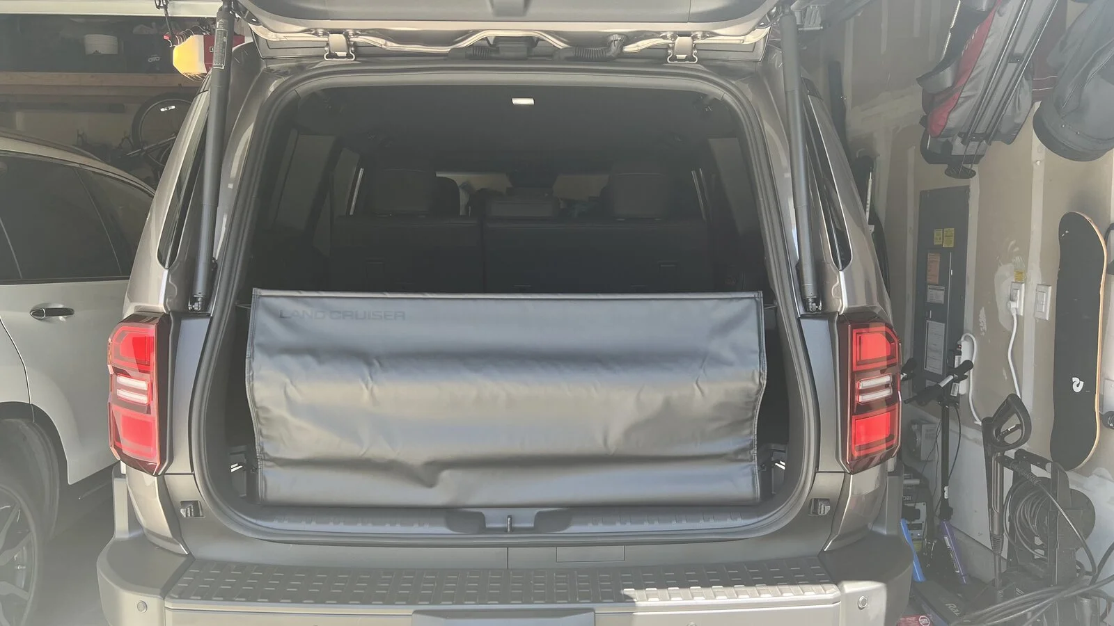

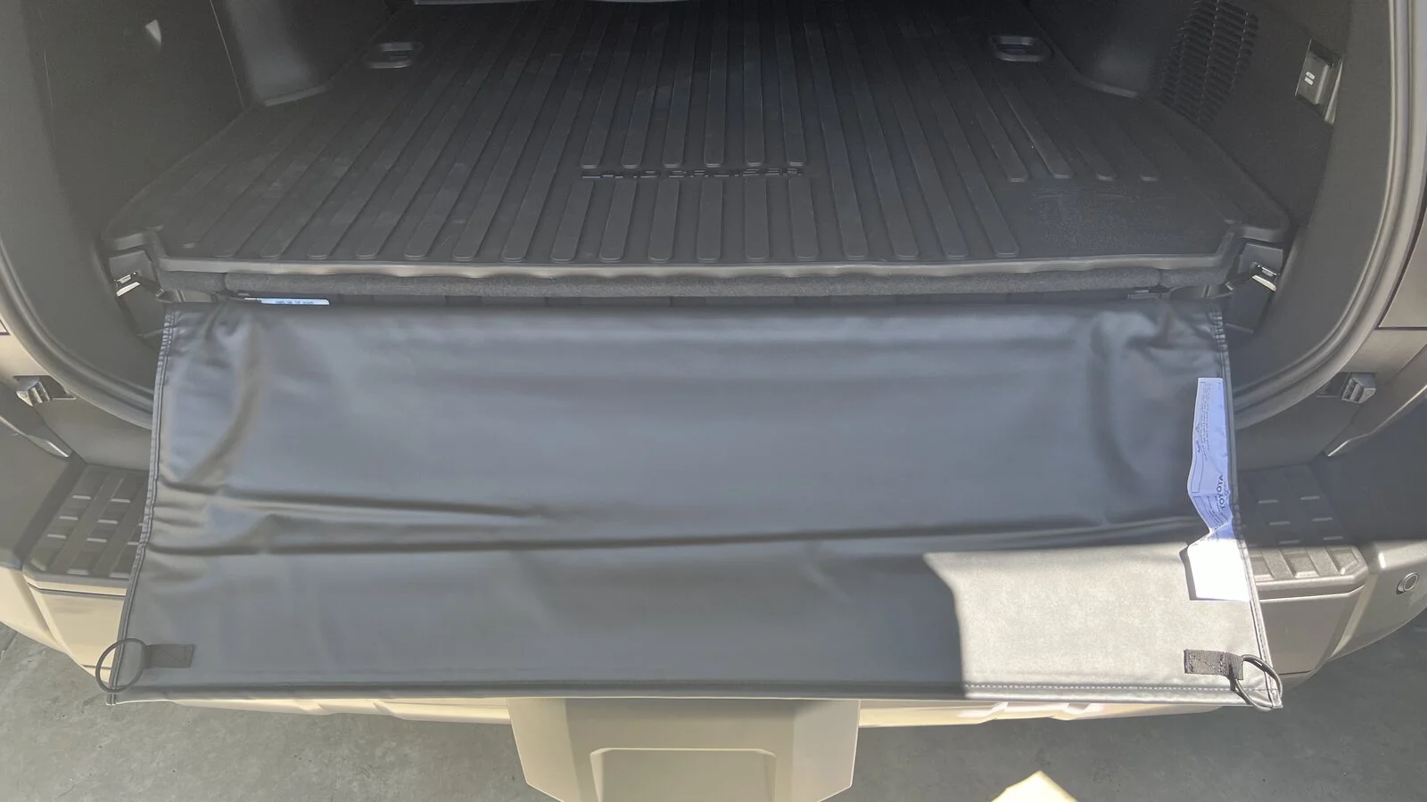

This will do wonders to keep the dogs from hopping out before the leash is attached.
That's what the lower tailgate on the 80 is for.
That cover would just be a pain in the a** to deal with on a daily basis.

Accessory PZ317-60013 isn't to be used on a daily basis, its for people who are traveling and storing "large loads".... :rofl: Its pretty cool and will come in hand on long road trips

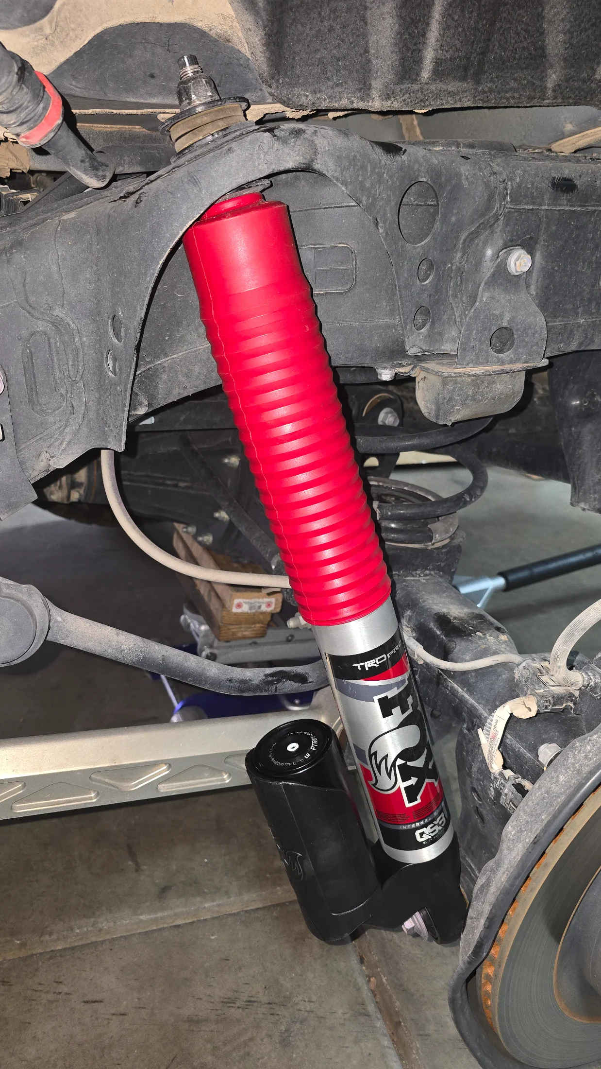

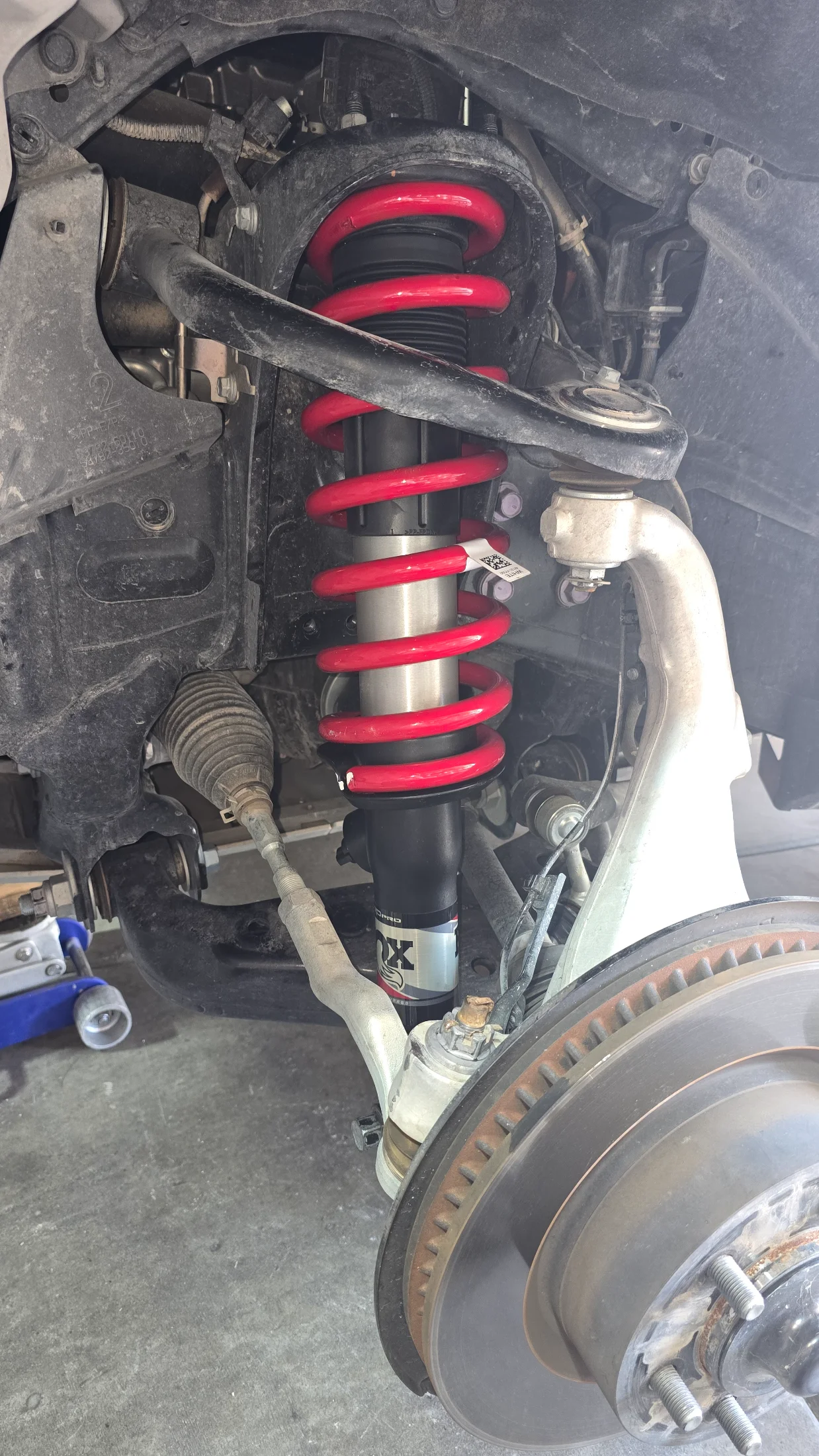

Received the front shocks. Upper and lower mounts are the same. Shock is a little longer, which was expected. Oem shock is from a GX550 OT. I'll be attemptimg to install these on the 250.
Well they fit, but the stock bump stop interferes with the adjusting knob.
Looks like I need to make a new bracket for the bump stop.
They ride much better than the stock shocks.

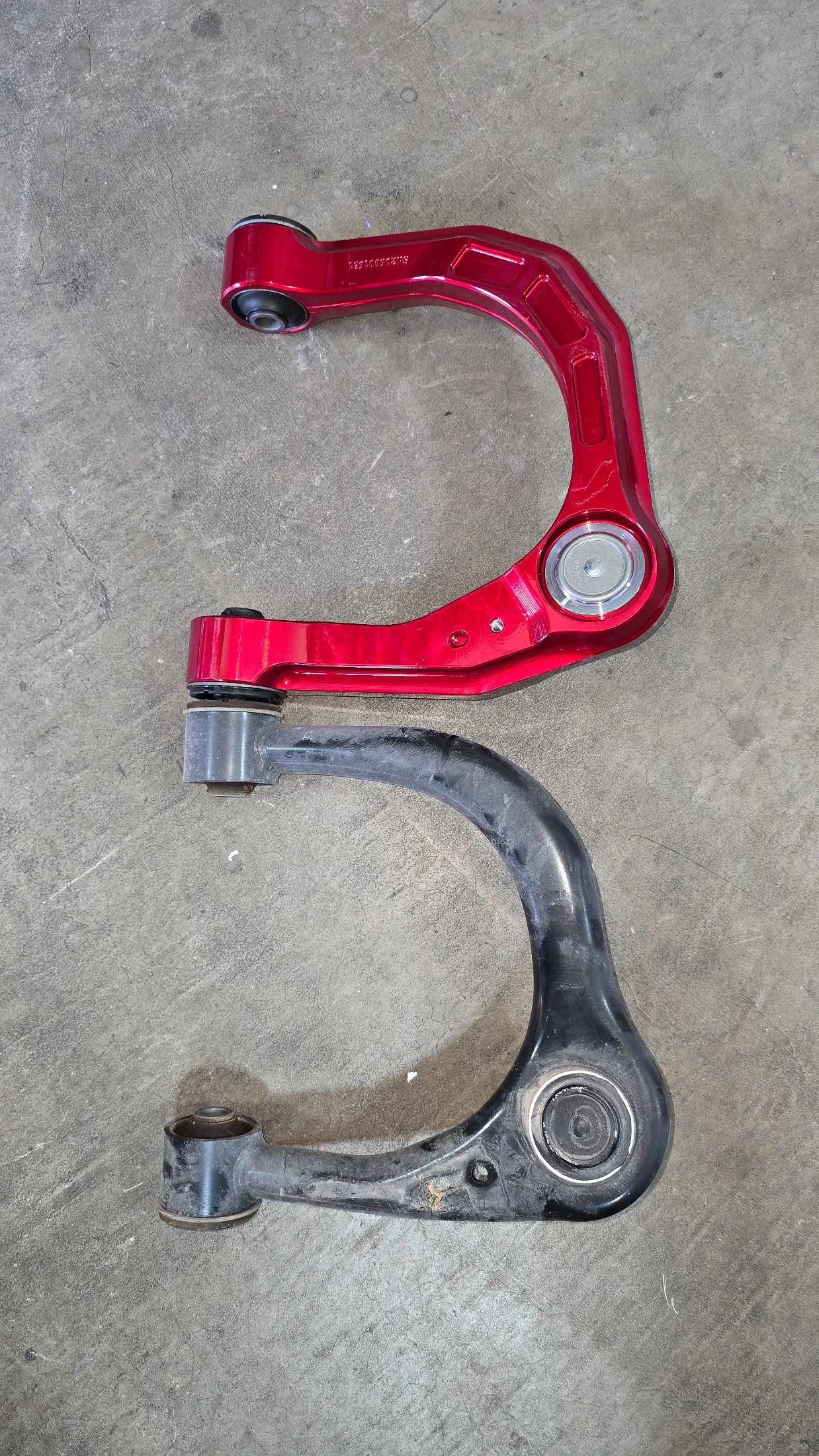

Upper arms and rear shock went in without issue.
