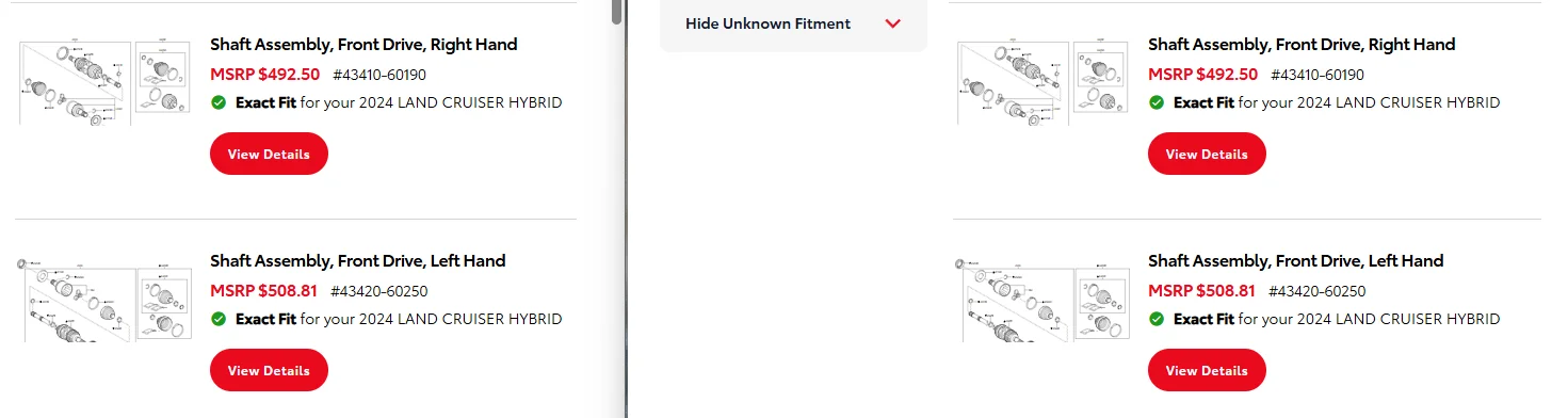

any plans on installing trd pro cv axles?Ih8mud is the Land Cruiser forum.![]()
I'm showing the TRD Pro 4runner uses the same CVs as the LC250any plans on installing trd pro cv axles?
I think the Tacoma TRD has the high angle cv shafts.I'm showing the TRD Pro 4runner uses the same CVs as the LC250
Probably why the Taco sits 1.5" higher.I think the Tacoma TRD has the high angle cv shafts.
Probably but it also is piece of mind knowing the lift you put in will not cause the cv to bind and ware out. CV shafts are expensive buy once cry once.Probably why the Taco sits 1.5" higher.

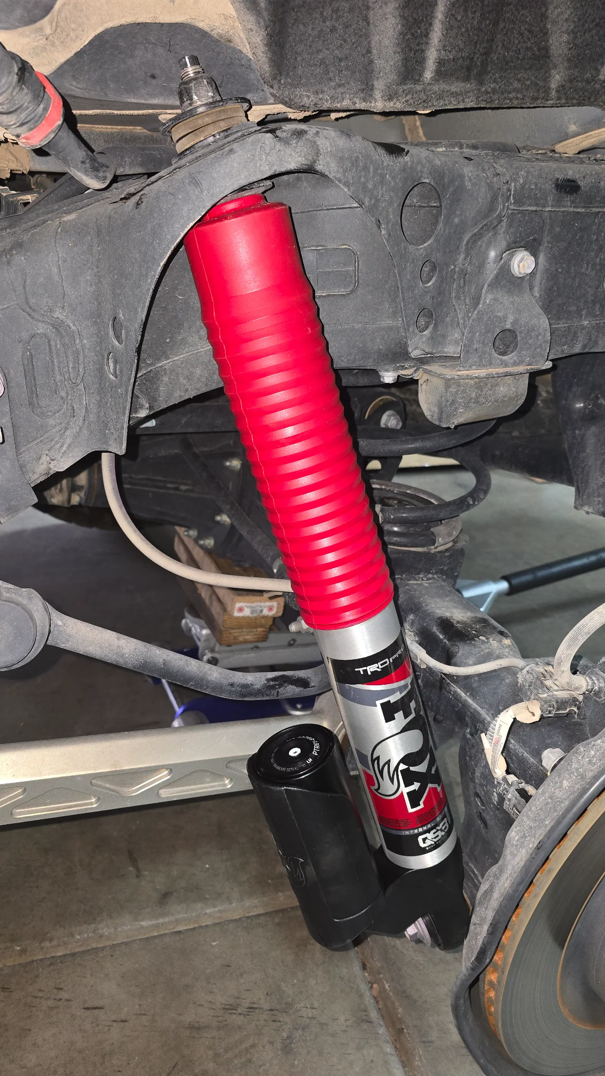

Front Fox shocks
PTR61-89250-RF
PTR61-89250-LF
Rear Fox shocks
PTR61-89250-RR
PTR61-89250-LR

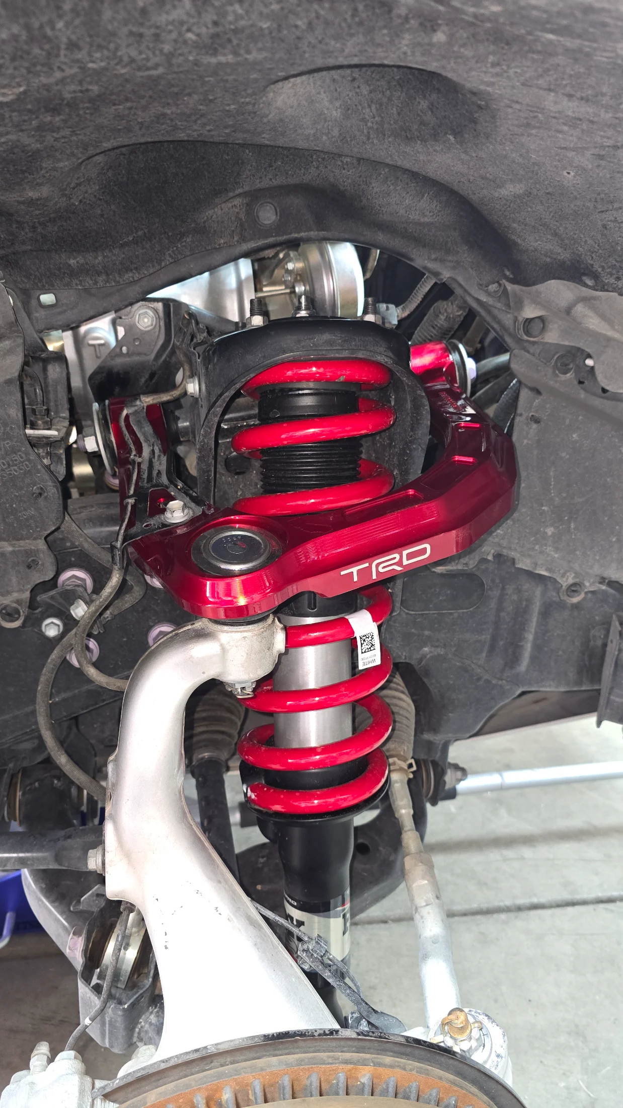

Front TRD upper arms
48630-0W010
48610-0W010

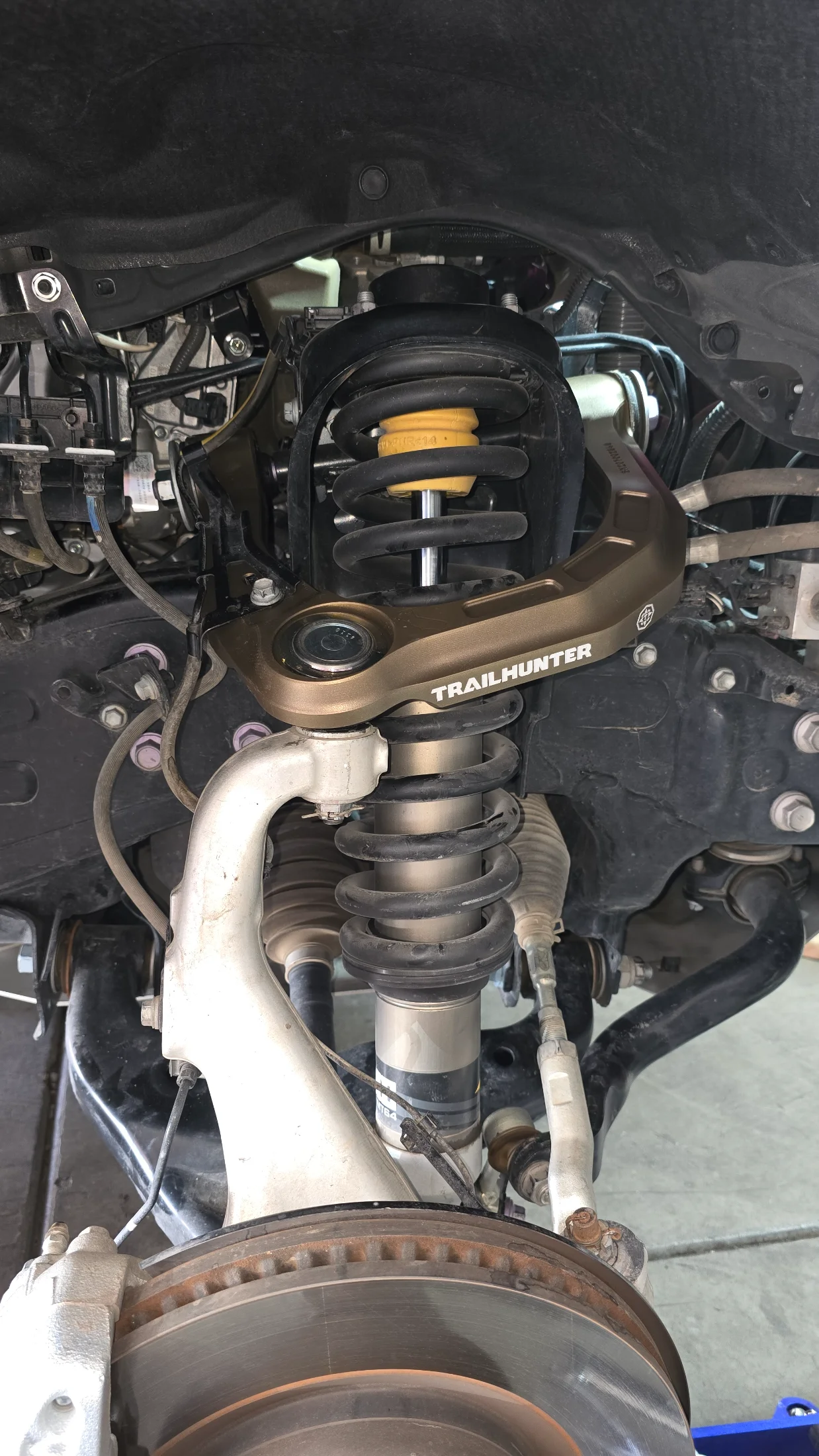

Front Trialhunter upper arms
48630-0W020
48610-0W020

I watched Tinkers "subjective review" that was one of his rant highlights. The LC250 not having the same CV axles as the TRD Pro. Along with the lc250 steering not having the same twitchy feel as his FJ cruiserProbably why the Taco sits 1.5" higher.
to name a few...Have you confirmed if there is more caster built in to the UCA. Never found any official confirmation.Trailhunter arms from the 4runner bolt right in for the GX as well. They are identical to the trd pro arms except for the color and logo.

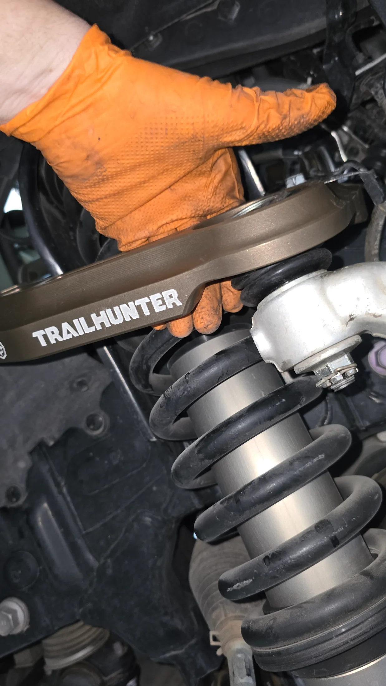

Both arms have more clearance for larger shocks/springs. Stock upper arms were making contact with the MT64 springs at full droop, I can now get my fingers between the two.View attachment 3967418View attachment 3967419

If you were able to get the alignment checked, any difference?Doubt it, balljoints and bushings appeared to be in the same spots. My GX aligned fine without the arms, but that does give me a data point for when I take it back to check the alignment. I might do that this week.
Not yet. I didn't notice any difference while driving, so I doubt anything changed. I'll get around to it soon, just to make sure.If you were able to get the alignment checked, any difference?
