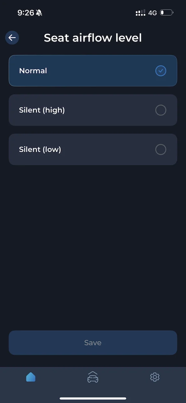

The ventilated seats in the car that I test drove were significantly worse than what I got. But you can change the settings via Carista or similar, I didn't have to change the settings on mine.

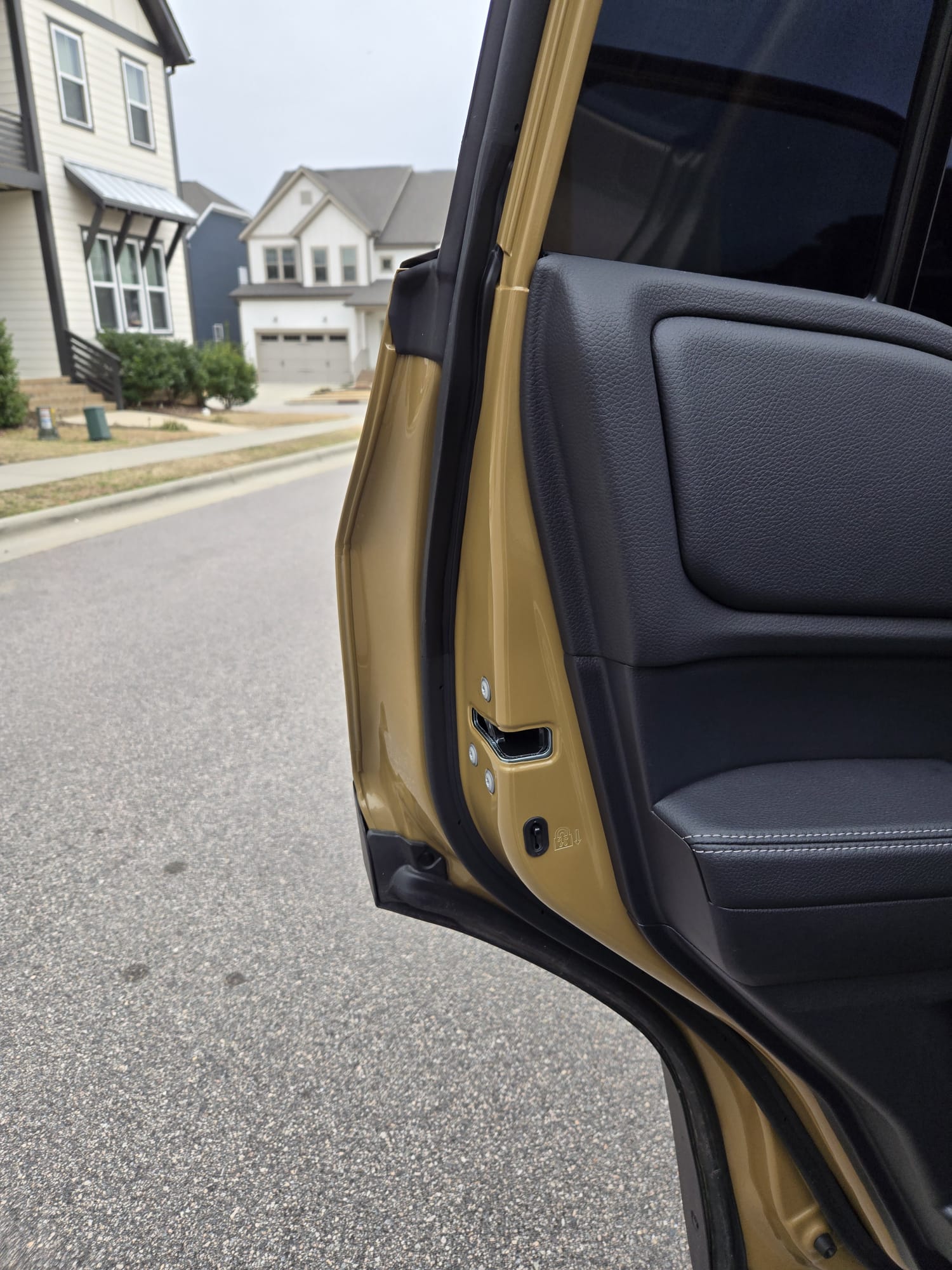

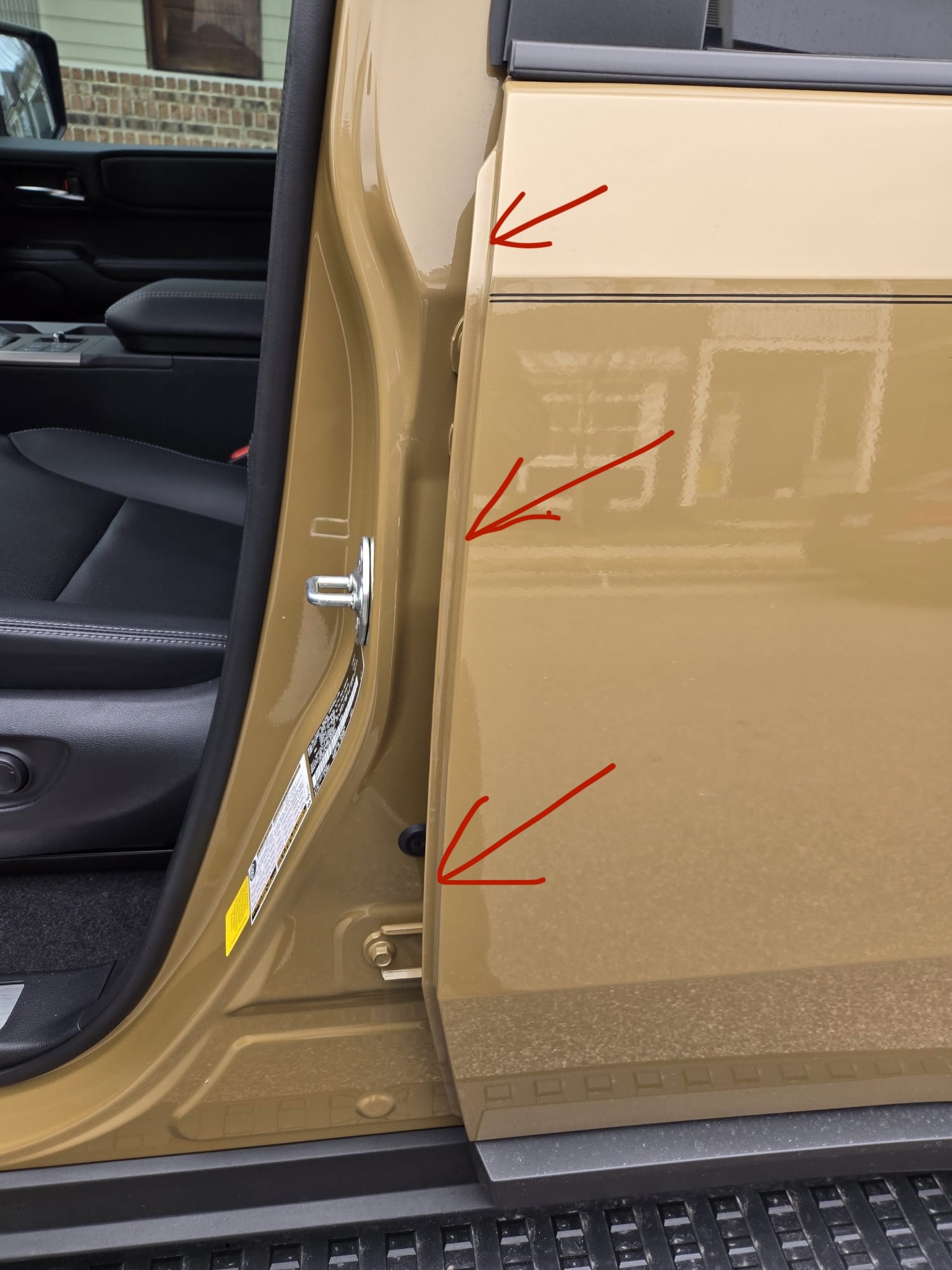

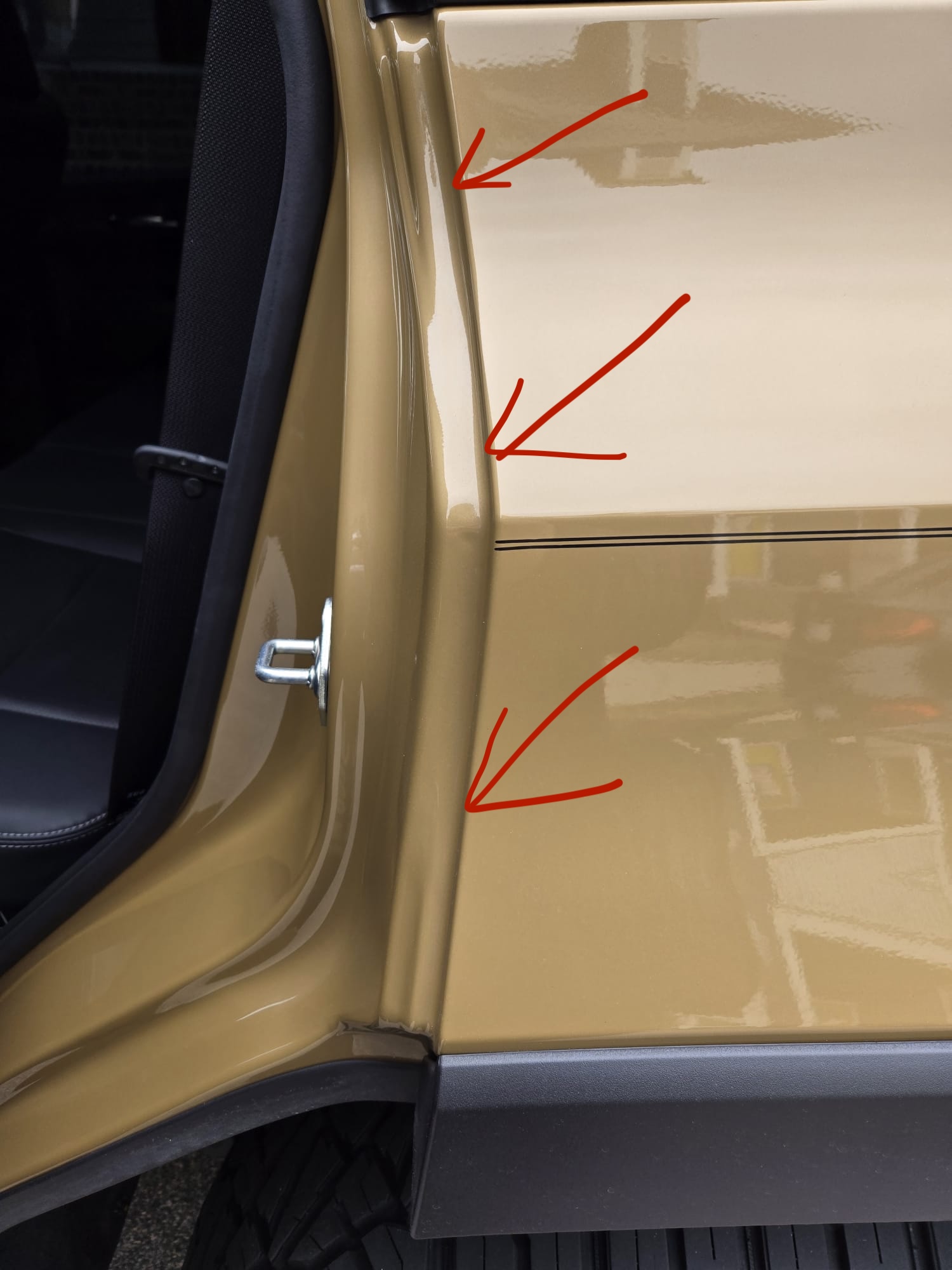

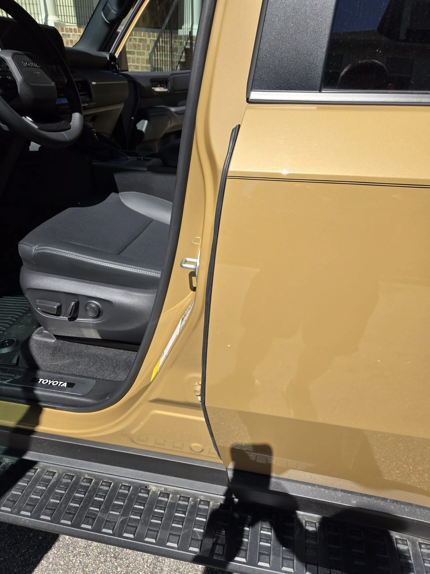

Considering adding additional weather strip in the following areas as a first step to improving door thunk and wind noise:

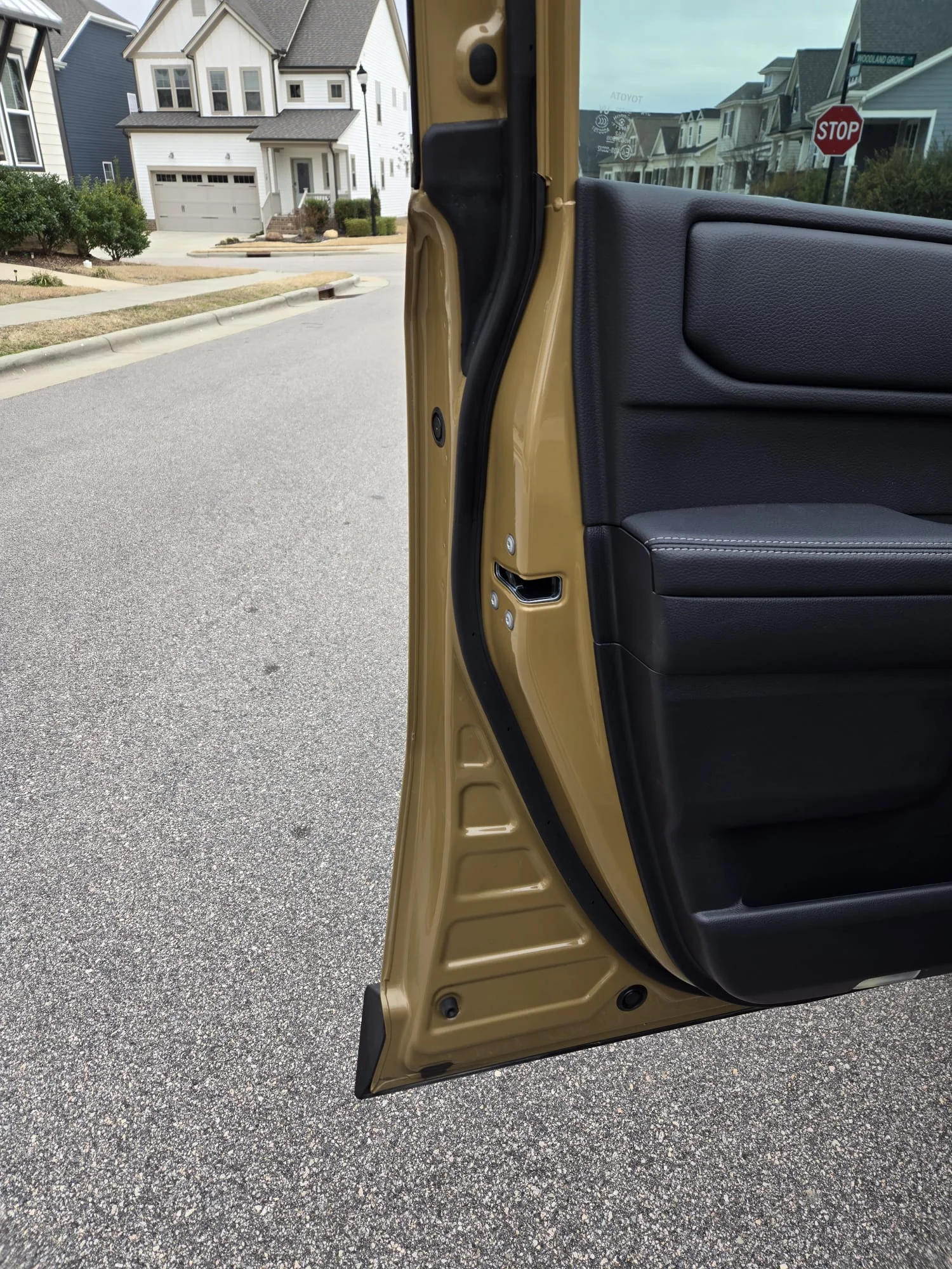

...and possibly also on the doors as well:
If there is no marked improvement the next step will be Dynamite Extreme or similar of the doors.

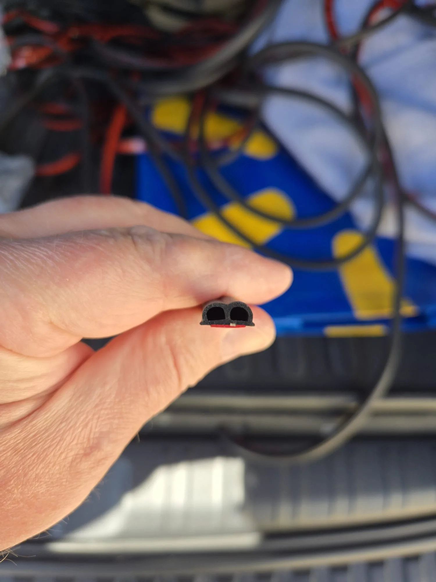

Anyone have recommendations on high quality adhesive weatherstrip? Thinking the double-bubble stuff many have used on Tesla Model 3's etc.

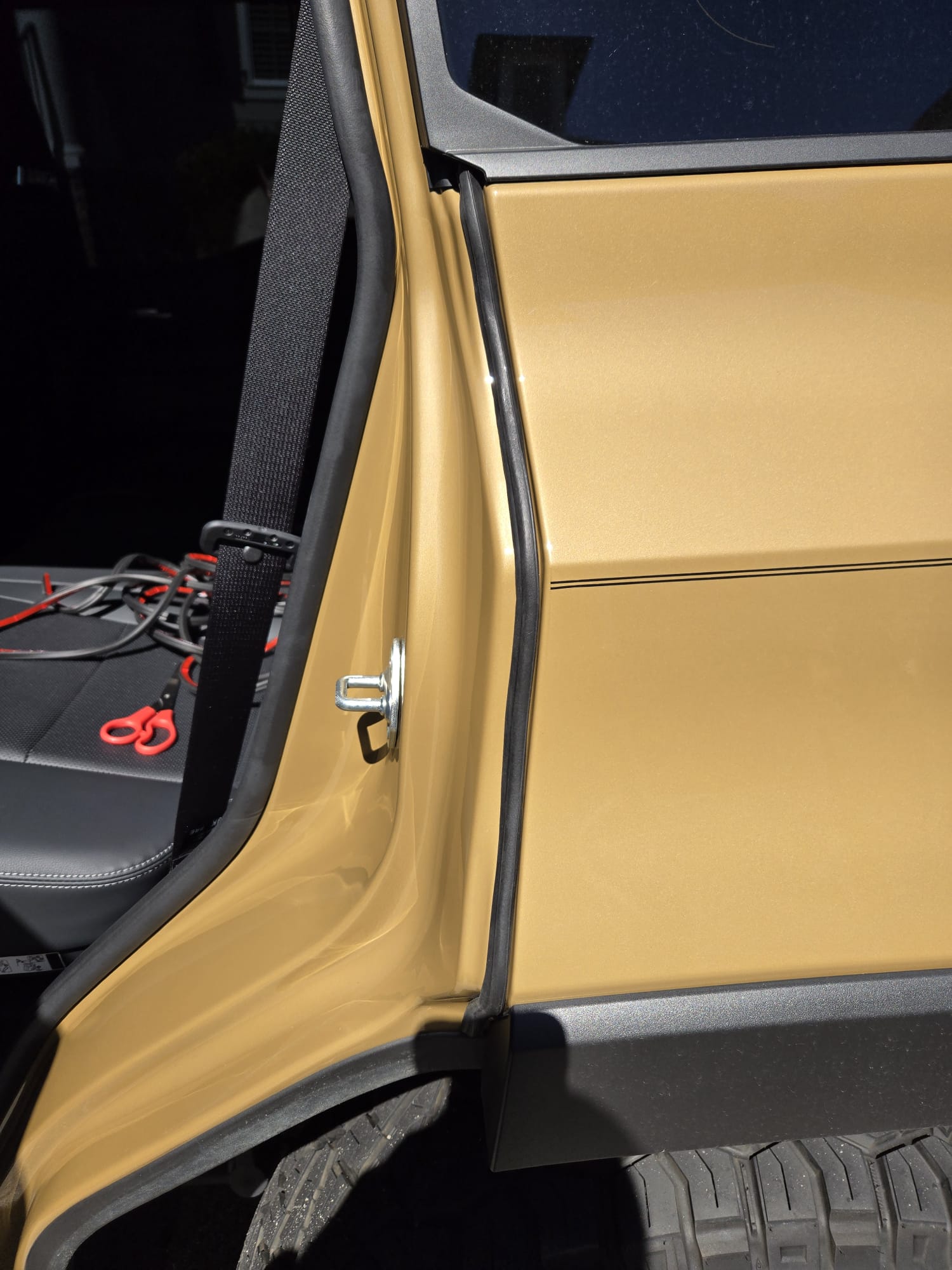

Made the thunk somewhat better for front doors, noticeably better on rear doors. Tin-like noise still exists at front doors when slammed G-Wagon style. Looks like Dynamat Extreme will be ordered next.
