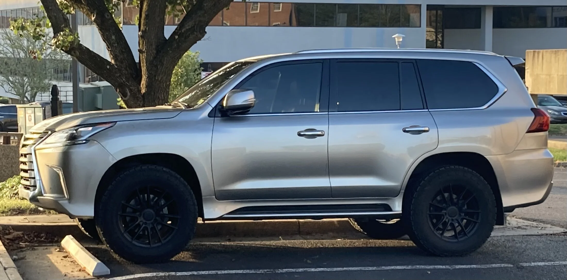

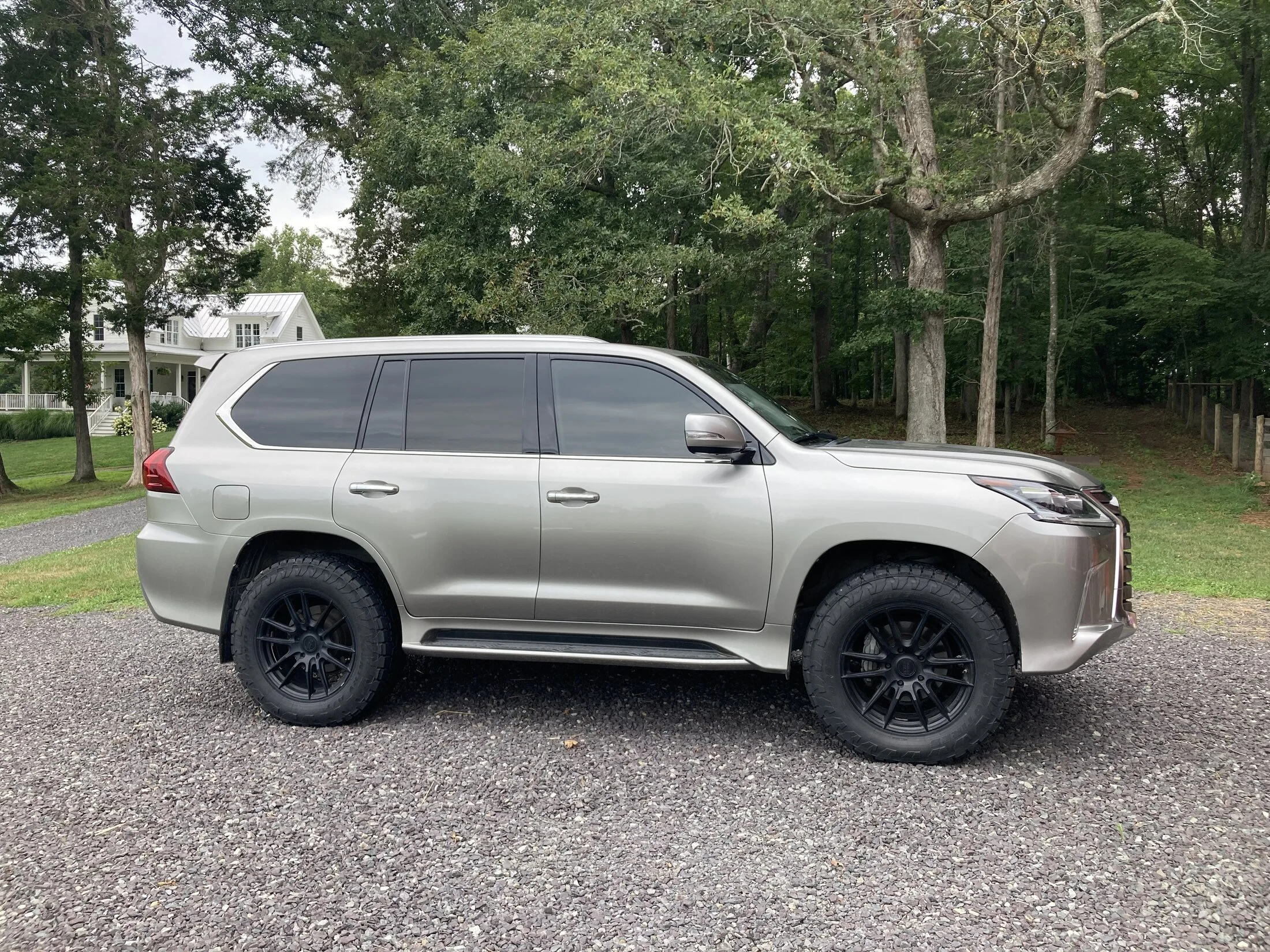

I might be as close to what you requested.
20” wheels (25mm offset)
285/65/20 Toyo AT3
NST 1” body lift
Just trimming, massaging and relocating some of the inner fender pieces.
Looks great! No adjustment to ahc? Do you know how the +25mm relates to the stock wheel backspacing, by chance?
Chris
Chris
Yes, it does have an AHC sensor lift but those pics are in normal mode. But with you 1.5” BL vs my 1”, the differential should be less since your AHC are still stock.
No rub with rear tires.
Front tires rubbed rear flap which is easily removed. No rubbing on body mount
Front tires rubbed front flap notably. I followed @TeCKis300 instructions for moving the fronts forward ~1” and frankly that was quicker and easier than working them with a heat gun.
Factory 21” wheel is 54mm offset I believe, so the different with my 25mm should be 30mm or about 1.2” (feel free to fact check me)
