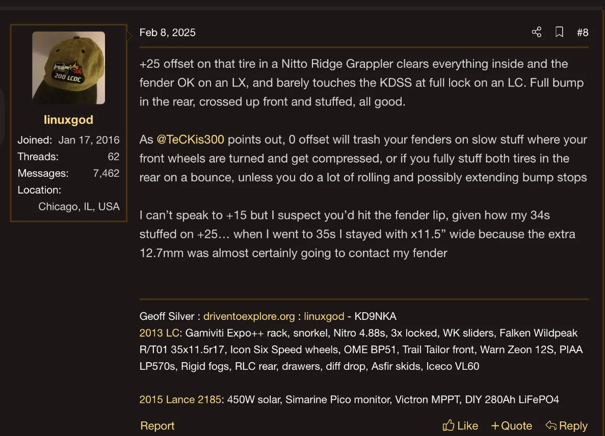

Have in my possession a 2010 Land Cruiser 200, and have recently gotten the modification bug! Didn’t want anything too crazy so I settled on an Old Man Emu BP-51 lift set at 40mm currently. Also picked up OME 2721 springs for the rear.
Would very much want to retain stock 17s and simply upgrade the tire size. From what I can find online, these 17s are 17x8 ET60, paired with 285/65/17s.
After lots of research on the forum, I understand that the safe and popular choice is to mount 285/70/17s, but was wondering if, given the slight lift, 285/75/17s would clear with no rubbing issues.
Ending my own thread! Dug through the wheel and tire thread and found this, it seems it CAN be done:
