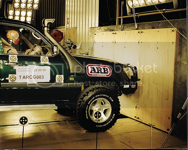

Quote I found online from a arb rep...
Hi guys, most of you will be aware that ARB was a pioneer amongst aftermarket manufacturers when we performed actual crash testing on a 100 Series LandCruiser back in 1997, in order to prove the air bag compatibility of our bars.
https://i1154.photobucket.com/albums/p526/ARB-4X4-Accessories/Misc/Crashtest_zps66ec52ee.jpg
Some 17 years on, I think most of you would be interested to know that we recently purchased a brand new Ford Ranger, fitted an ARB bar and handed it over to ANCAP for testing. You’ll be pleased to know that results proved the fitting of the ARB deluxe combination bar did not affect the ANCAP 5 star rating of the PX Ranger for occupant protection.
https://i1154.photobucket.com/albums/p526/ARB-4X4-Accessories/Misc/PHOTO-FordRanger2011withARBbullbarD_zpsb5069614.jpg
Whilst this is obviously not directly relevant to the FJ Cruiser, it certainly highlights the lengths we go to to ensure our bars meet or exceed all of the relevant design and safety requirements in Australia. As has been mentioned, this is an expensive exercise considering the cost of both the vehicle and the testing.

OK.
We agree on that.
But neither are 40 Series or 70 Series, and we don’t chide drivers of 40’s as being irresponsible or foolish (not that anyone is hurling that at poeple here).
Just today, I passed an older couple in a beautiful 1957 Cadillac. I think we can all agree that by driving their Cadillac, they are NOT employing modern safety standards. They are absolutely driving at greater risk to themselves, just like the guy driving the 40 Series is, because modern crush zones simply didn’t exist for those years, Heck, they don’t have even a single airbag... Not even a shoulder seatbelt! But we don’t slam them as cool-hearty. It’s a choice. A trade-off.
My contention would be that these trade-offs are decisions we all get to make, and to reduce it to mere coolness is not a complete picture.
While a heavier bumper is certainly a compromise in some scenarios, it can also serve other valuable purposes that are valid. So to me, this is far from a black or white issue.
I am personally glad my TJM, for example, let me continue our three week trip despite a significant deer strike. I’m clad that my rear bumper saved the entird right side of my vehicle during that same trip while navigating an obstacle. I also used my winch on the same trip by necessity. All three of those things are far more beneficial that simply “looking cool.” It has served me well in the exact purposes I prioritized.
Finally....
-I would contend I am still FAR safer than the 40 guy, the couple in the old Caddy...etc. Even though one area is a trade-off...my 200 with its 11 airbags, traction control, ABS, excellent suspension, etc etc is still FAR more safe than the 40...the Caddy...a motorcycle or quad....even though my bumper is stout and imperfect in the crumple department.
Anyway... My 1.5 cents... :cheers:
I think part of this is a matter of intended purpose.
I would contend that there is far more going on (for some of us anyway) than simply trying to look cool...though I’m sure many choices are made that might be as simple as that for some.
I can’t speak for anyone but myself though...
-For me personally, my desire for a full bull bar has three main purposes:
1. So a struck animal is more likely to stay at the front of my vehicle than fly full force through my windshield (heavy bars tend to at least partially “catch” or partially “hook” at least part of the animal as it’s momentum wraps both above and below the top bar. -Like running to catch a home-run ball on a little-league field.....and hitting a 3 or 4-foot/tall rail. -While you might still end up going over it, the fact that your lower body hits and partially catches on it means that your full force won’t smash a spectator very hard on the other side.
2. Improve my chances of a fully-functional vehicle in the boonies after a strike. This has already proven true for me....and the bumper paid for itself several times over, and saved the trip.
3. Winch mounting (possible without a bull bar, but a priority it also serves)
Downside we can all agree on: It’s not optimal for the ultimate energy absorption in every scenario. For certain scenarios, it’s a negative.
OK.
We agree on that.
Finally....
Absolutely agree - as long as you know where you are. If the guy in the old Caddy thinks he is as safe as the driver in a new Caddy, then he is kidding himself. The driver of the 40 knows that the car isn't as safe (hopefully) and you have evaluated your needs and understand what the downsides are.
If everyone did a cost/benefit analysis before they bought stuff that "looked cool/tactical/solid", then many aftermarket places will go out of business.
I've always said that buying stuff for any reason is perfectly fine as long as you are honest to yourself about those reasons. Getting back to this thread, telling yourself without research that a steel bumper will make you safer is a bad reason, doing the analysis like you did is a good reason.
Keep in mind this thread started with the question of how a 200 would do in a serious accident, and with concern over what happened to the family in the original story.
Yes a bull-barred 200 is probably still safer than a 40, but likely not as safe as a stock 200. As ceb said, as long as people are honest with themselves about the results of their decisions and why they made them, rock on.
I agree with the last few posts: these bumpers aren't making anyone safer in most scenarios, and my goal in having one is honestly to look cool and have a base for a winch if I decide to add one. I'm honest about that, and I don't feel any shame in it. I think the odds of dying or being seriously hurt in a head-on collision in either a 100 or 200 series are quite low anyway, so an incremental increase in those odds are honestly not a big enough factor for me to weigh them heavily. That is why I went with an ARB, though.
Rollovers are a bigger risk to me, but I still have a small lift and plus sized tires. I do think people need to be honest about these things and recognize that they are increasing their chances of serious injury or death (although possibly only slightly) in exchange for either off-road functionality or appearances (or both). We exchange small increases in our chances of dying for vain reasons all the time, though, so I'm not making an argument against it.
