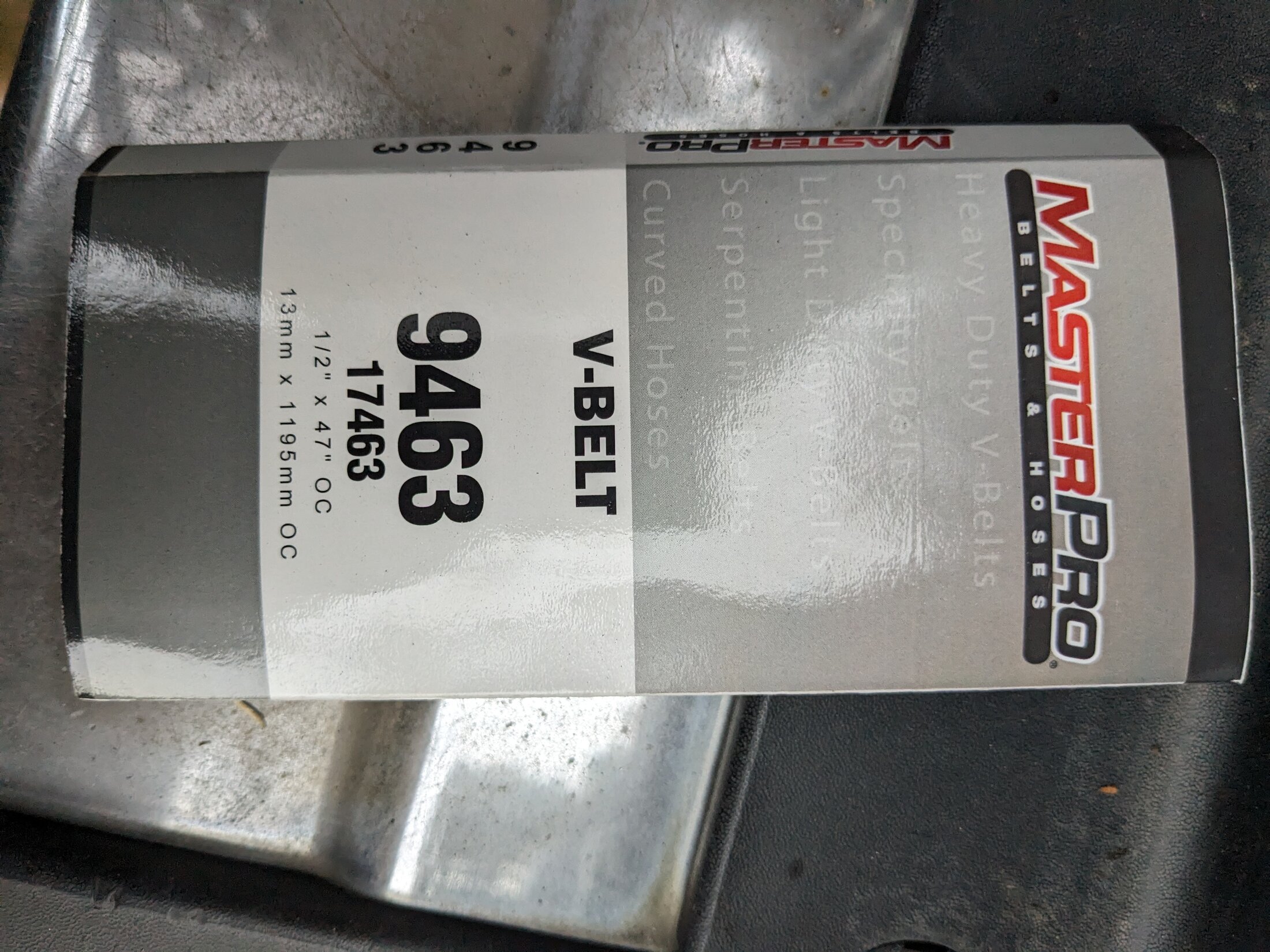

My v-belt just broke and have an OEM on the wat, but in mean time found one that worked at O'Reilly's. Pic attached. 13mm x 1195mm - a bit small so tensioner pulley sits lower but works fine and attached once, holding strong.

Yep, see the pic I attached and ask for same size. I had to take tensioner pulley off to get it around the clutch pulley.
Am I able to get this from an autozone or similar?
Usually belts can be physically matched by width and length.
It helps if the parts store person has compared belts before.
