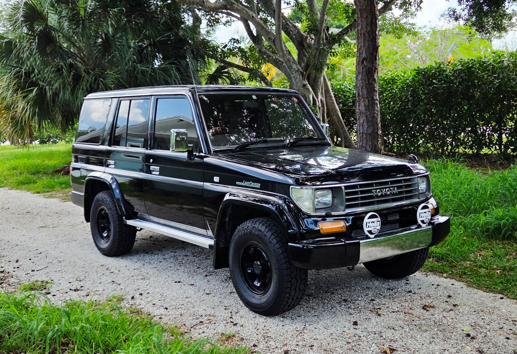

My A/C blows (very) cold air, but it doesn't seem to push a suitable volume on high (I'm in FL, truck is black and it's hotter than two squirrels screwing in a wool sock). There are three (or four?) distinct speeds when operating the switch, but "high" doesn't seem to be very high (as compared to modern vehicles). Should I troubleshoot the resistor/switch/motor or is this just the way these are?
