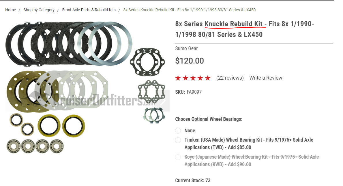

Knuckle Rebuild Kit - $200
Rack it, Strip, Clean and Put back togeather 8hr @ $125 an hour = $1000
Shop supplies (Oil, Grease ) - $50
You want parts painted then thats fine it would cost extra as to paint I need to let them cool after washing, sand blast and then powder or spray etc
That is all that is in a swivel hub rebuild, if you want to do king pin bearings, wheel bearings etc then that goes up from there.
Your welcome to pay more if you want but as I said if stuff was damaged it costs more cause if it need more parts.

No new bearings. No new hardware (knuckle studs/hub studs/thrust washer/diff drain and fill gaskets). No disassembling the birfield to check for wear.
So it’s a knuckle reseal. Not a rebuild.
Its a knuckle rebuild not a front end rebuilt or a front end restoration or anything else you want to call it to justify $$$$. Yes on a knuckle rebuild the birfs are inspected and repacked but if they need replaceing no they are not included. Same with snubs etc if they have spun bearings then they are extra etc etc etc.
Its exactly what toyota required back when these where current models and leaked. Any half competant mechanic is gunna clean and inspect and report any issues or suggestions to a cutomer.
Its this obsession with trying to treat dailey drivers and hobby drives as full restos at every issue that is killing this hobby and making people think every issue costs thousands. A knuckle rebuild ain't hard, complicated or $3k and you don't paint anything when you do it or replace undamaged hardware as none of it is single use.
Being you have been a parts guy for many many years I am sure I am not telling you anything you don't know, I am guesing the price just doesnt line up with what you like to tell people its gunna cost them .....
Thats why places like Cruiser Outfitters sell a kit with optional bearings and call it Knuckle rebuild
... anyway I have spelt out my prices why don't you list your break down and teach me a thing or two ??
