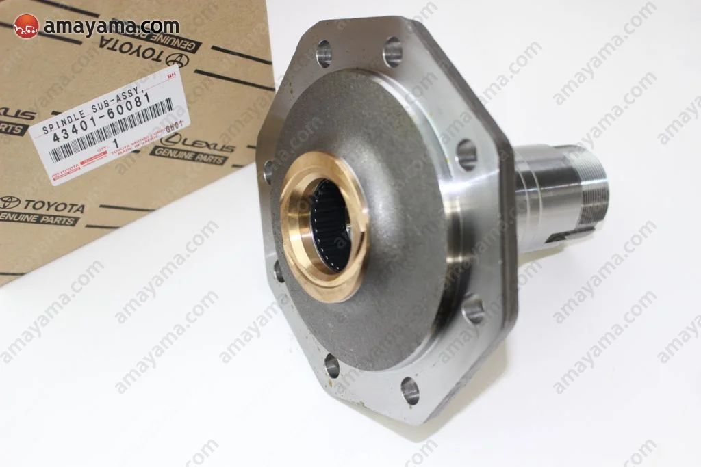

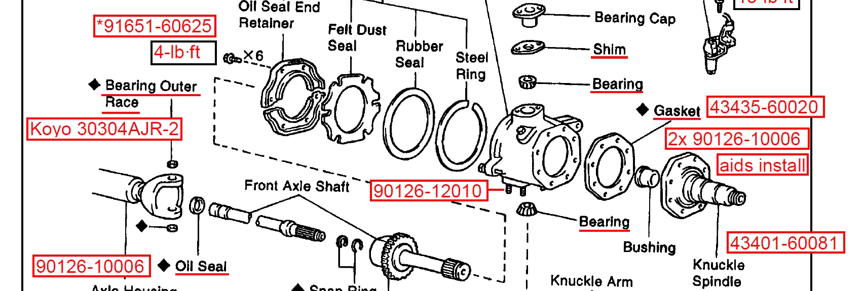

What's the Spindle Sub Assembly and the Front Axle Spindle? FWIW, these are the parts:
A "spindle sub assembly" could be the spindle with bushing installed, but there's only one spindle. Per side that is.

The spindle sub assembly is part 43401-60081 and was added post the initial estimate(and they never asked nor informed me that it needed to be ordered)...the Front Axle Spindle does not have a part number next to it, so not sure what that is exactly.

They charged you full msrp ($444) for "spindle sub assemblies," and you don't (yet?) know if they were needed (same with flanges). Dealer sites have them at $300, and they can be had for under $200 on eBay for OEM. Granted, that's not how shops price things, but...
I don't know what front axle spindle refers to for an additional $420, when you already have "spindle sub assembly" accounted for. As Malleus said, there's only one "spindle" per side and that's the $444 msrp part shown in the diagram

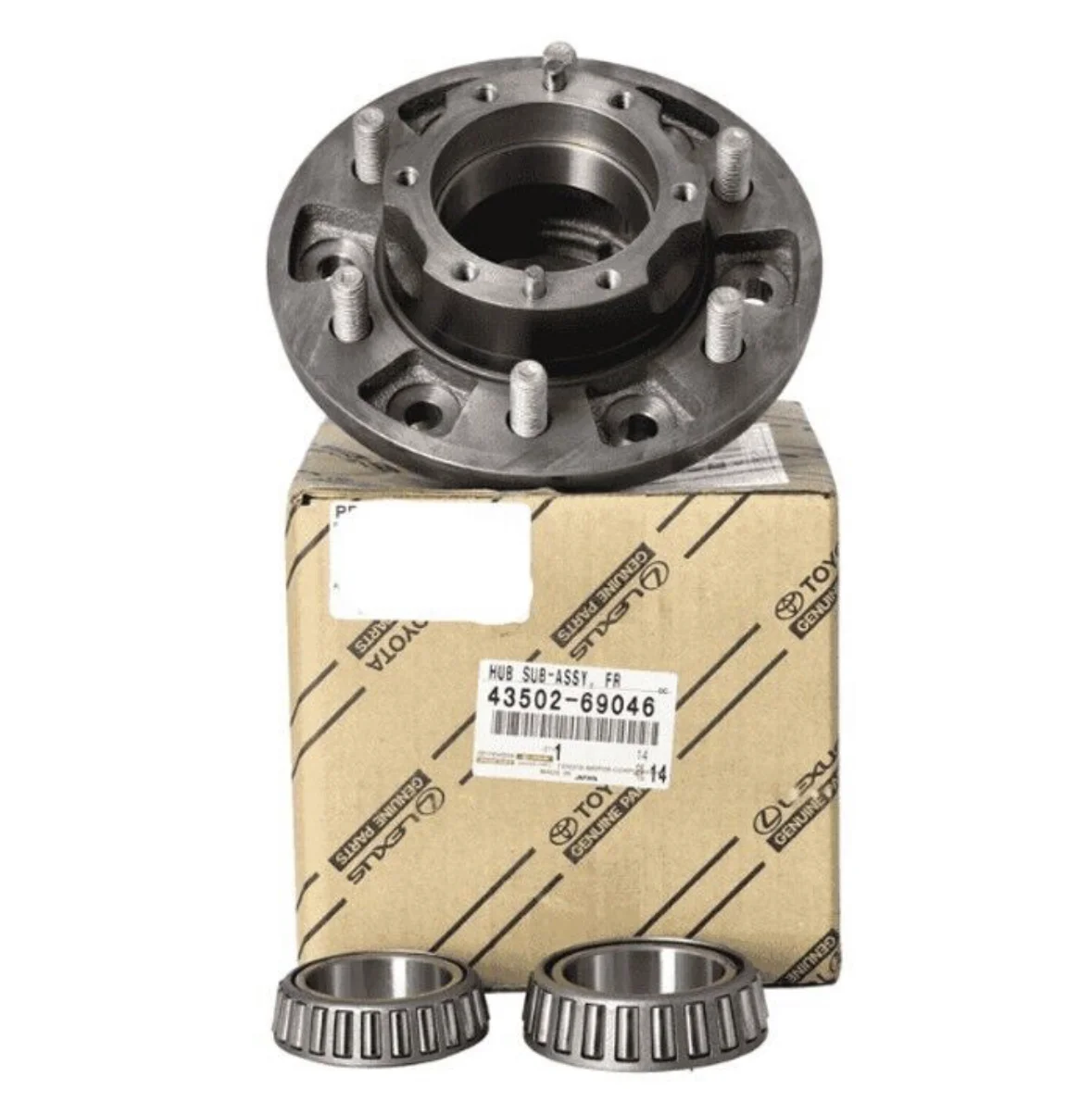

spindle hub assembly is the hub with races and bearings. Most do not replace just the race and or bearings and it has rotors if I am not mistaken. Lazy way to do the job, but I know shops that do that.

Spindle sub assembly is 43401-60081 with $444 msrp, hence the $888 charge
Wheel hub sub assembly is 43502-69046 with $435 msrp each, and I think they come with races & bearings (which come in the rebuild kit too) so it doesn't sound like they replaced those or I'd expect an $870 charge
