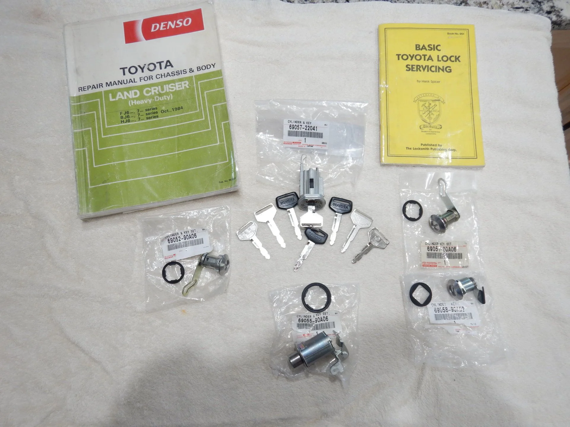

You need to buy the kit from Toyota that has all new key cylinders and one key that works them all. I recently ordered 4 sets. You have to look hard but you can find them. They are not offered in the US anymore, you have to buy overseas.

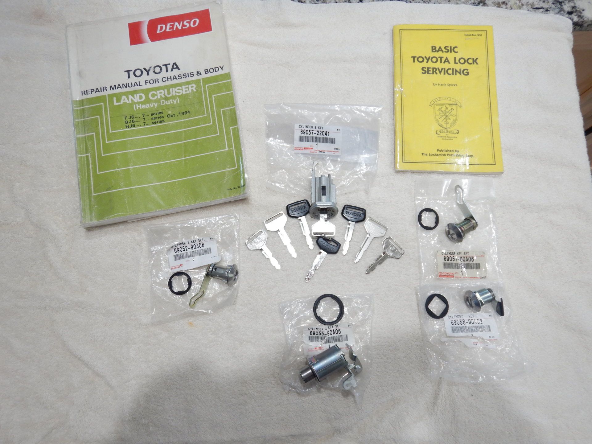

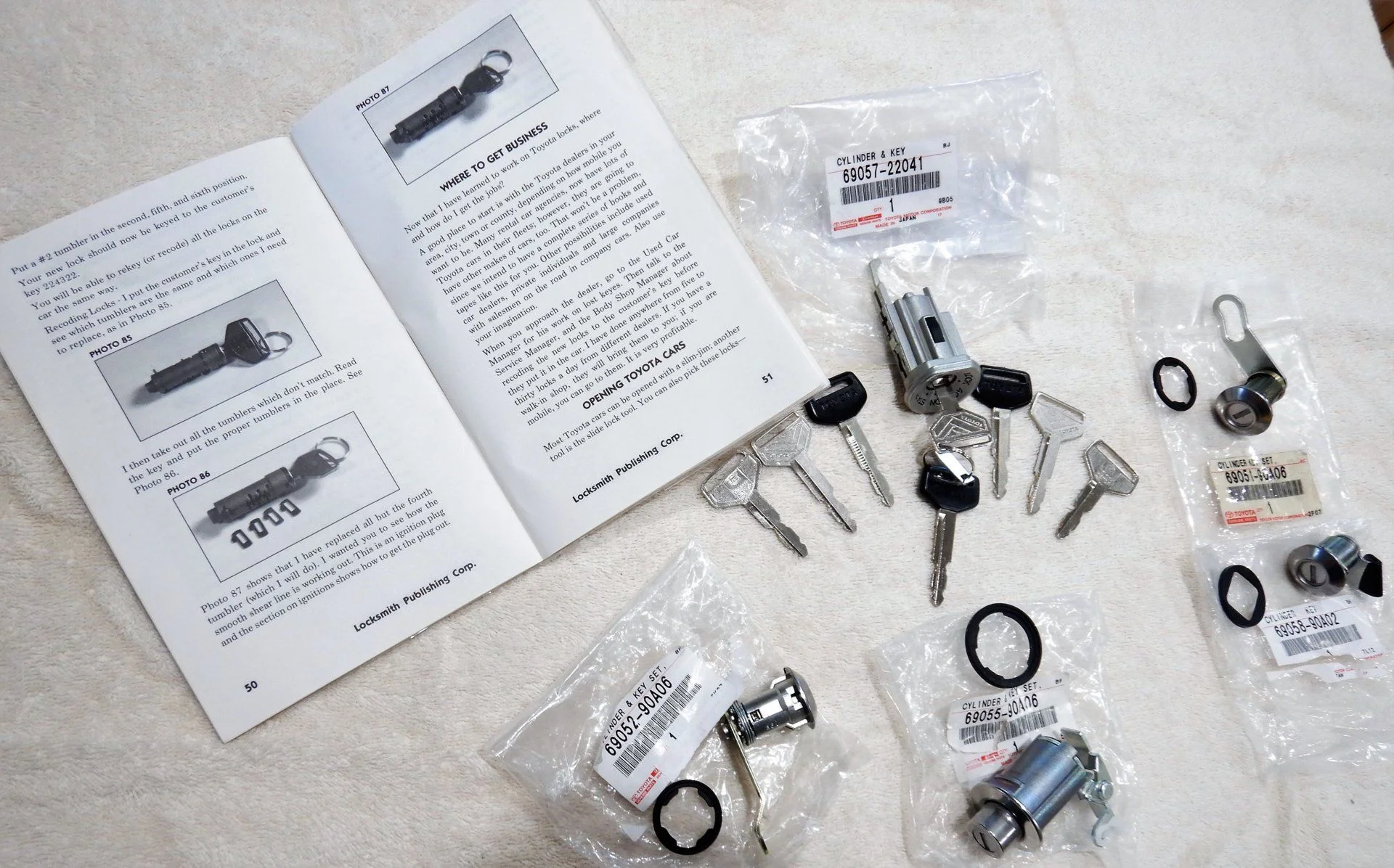

Mine came with 3 keys, ign key cylinder, both front door key cylinders and gas tank door key cylinder
The kit is 2 door lock cylinders, 1 ignition lock cylinder and 1 gas door lock cylinder, as well as 2 new keys.

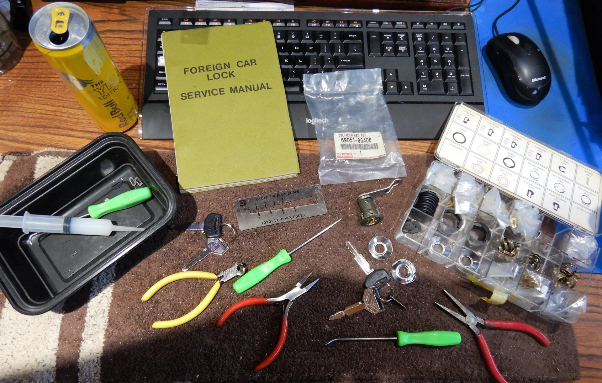

It is also possible to remove all the lock cylinders from the vehicle, and maybe toss in a couple extras scrounged from junk vehicles, and take them all to a friendly locksmith who will re-key them to accept a common key,

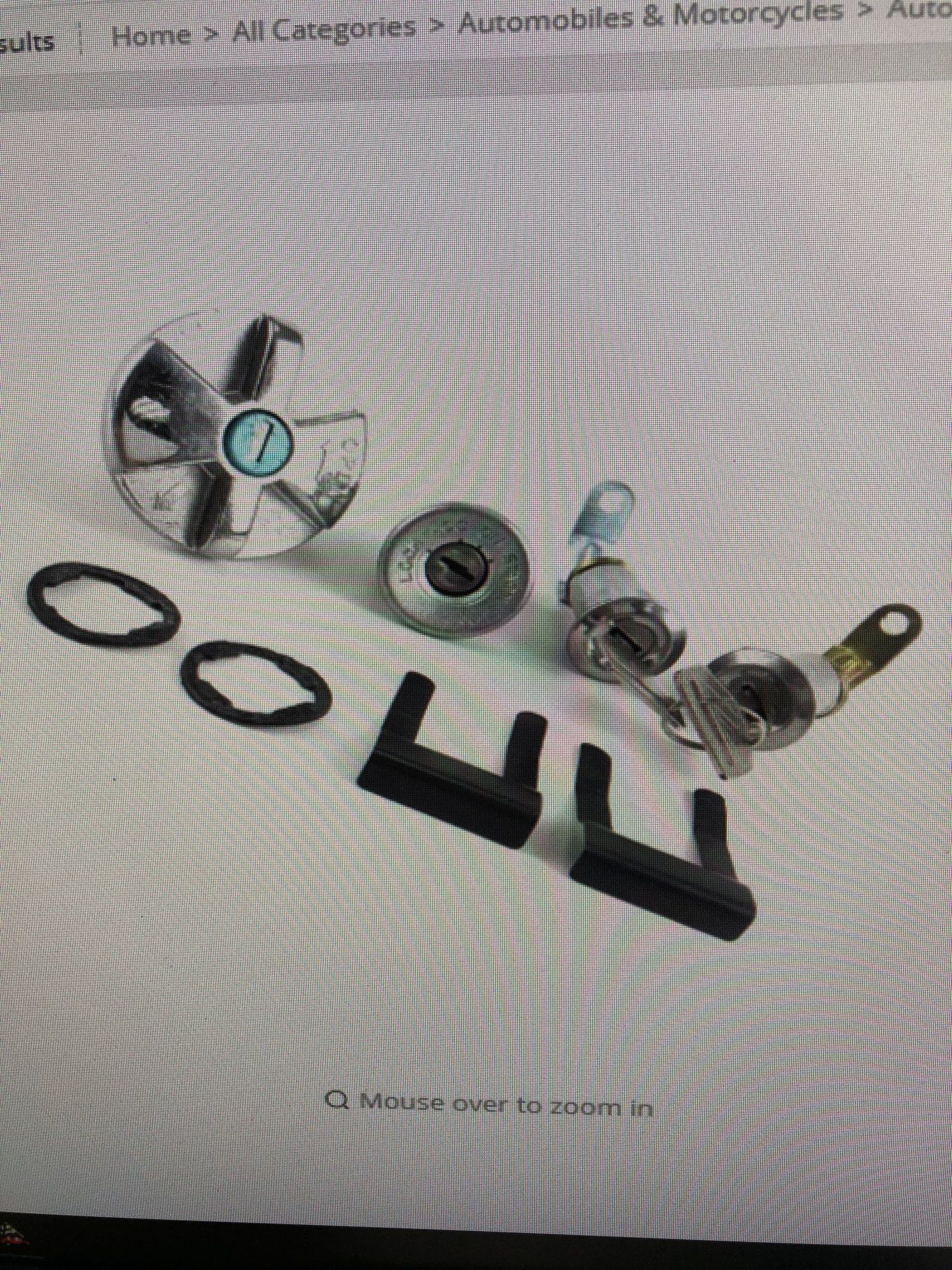

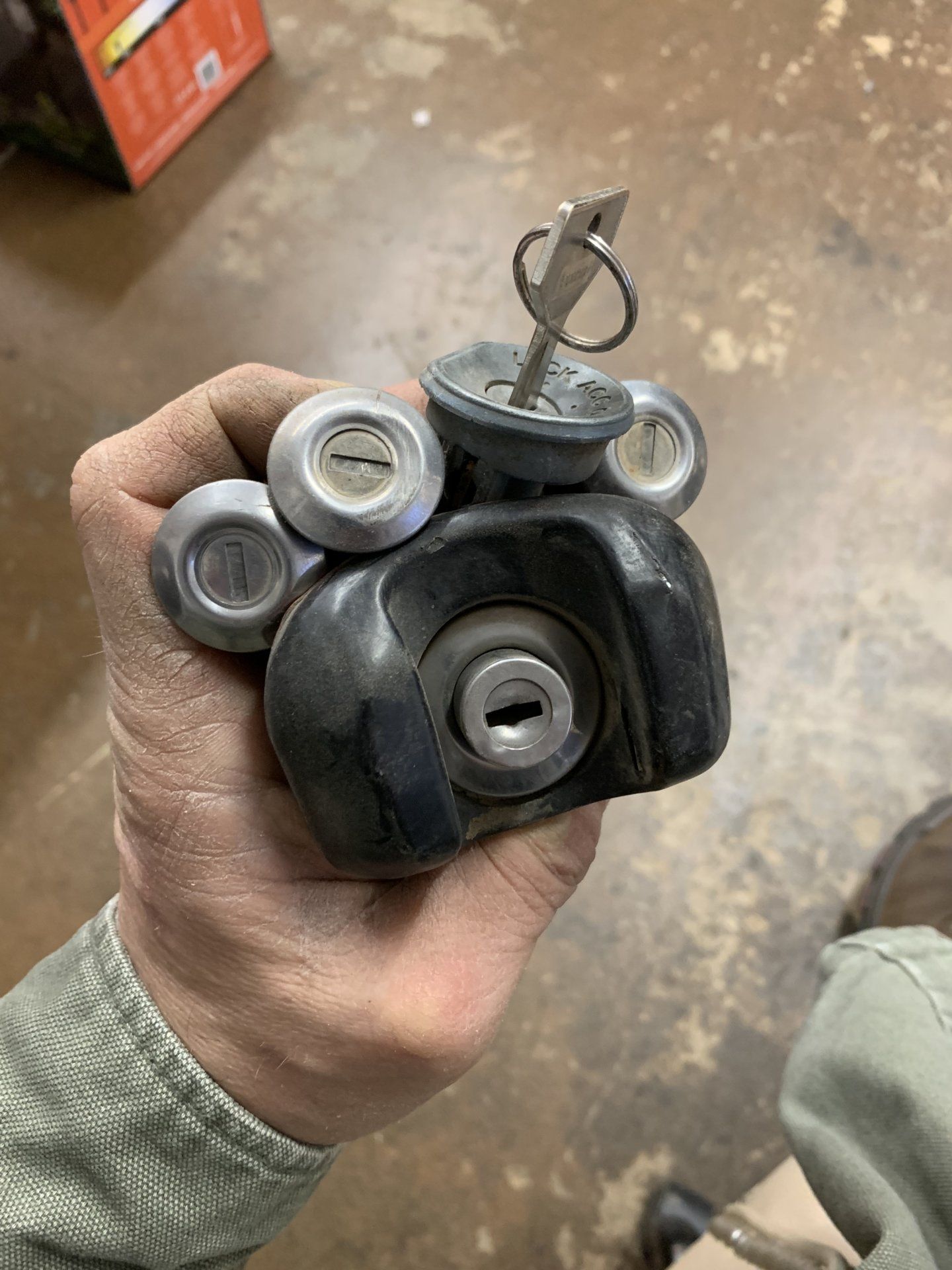

I just received my set I bought online from AliExpress. Consisted of 2 x door locks 1 x fuel cap and a ignition barrel. The quality is not up to Toyota’s standards but good enough for a show truck.

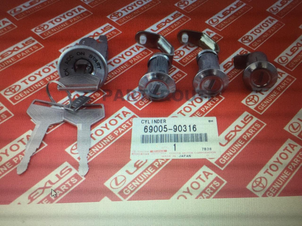

This what I should be looking for?

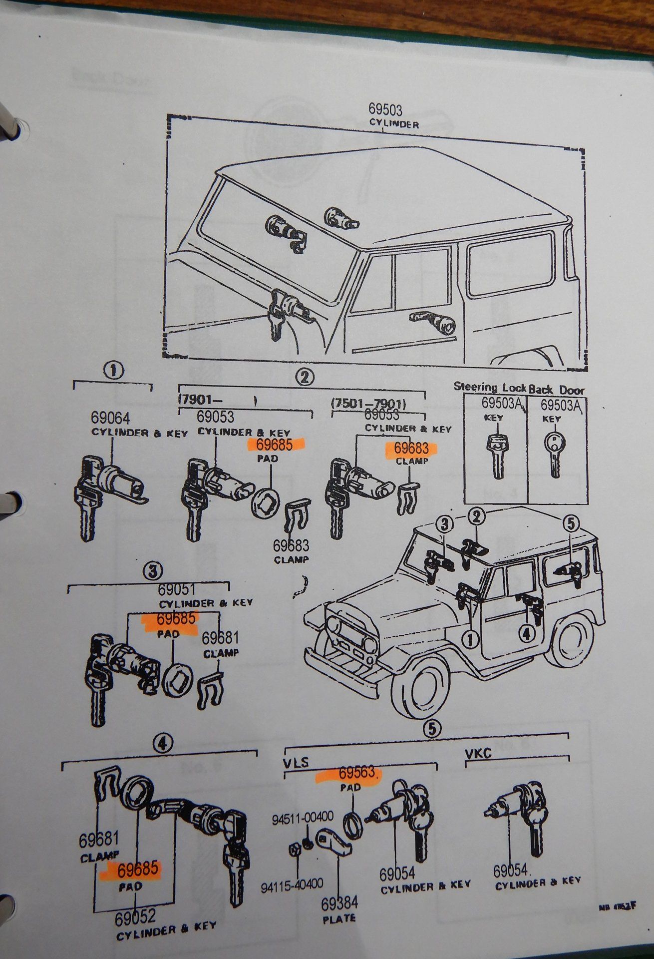

Hmmm, maybe the later door cylinders aren't serviceable? I know I've had the tiny, early lock cylinder, found in E-74 doors, all liftgate, all amby door and E-72 ignition locks disassembled, rebuilt & re-keyed.
Tech tip: Do NOT put the key in an early lock cylinder and spin it 360*. Something bad happens at the 180* position. They are only designed to turn from 90* left to center to 90* right. Had to take a fresh one back to locksmith and sheepishly explain what I did before the cylinder stopped turning...

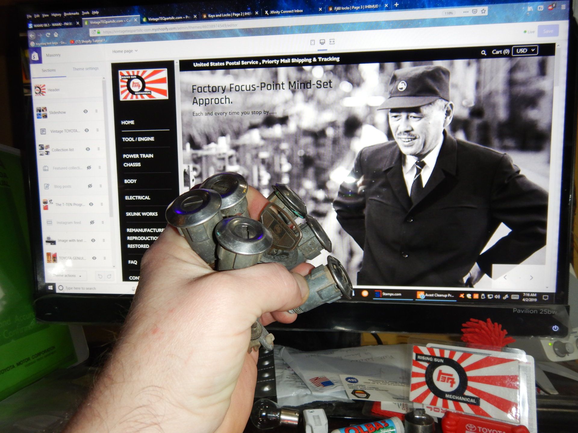

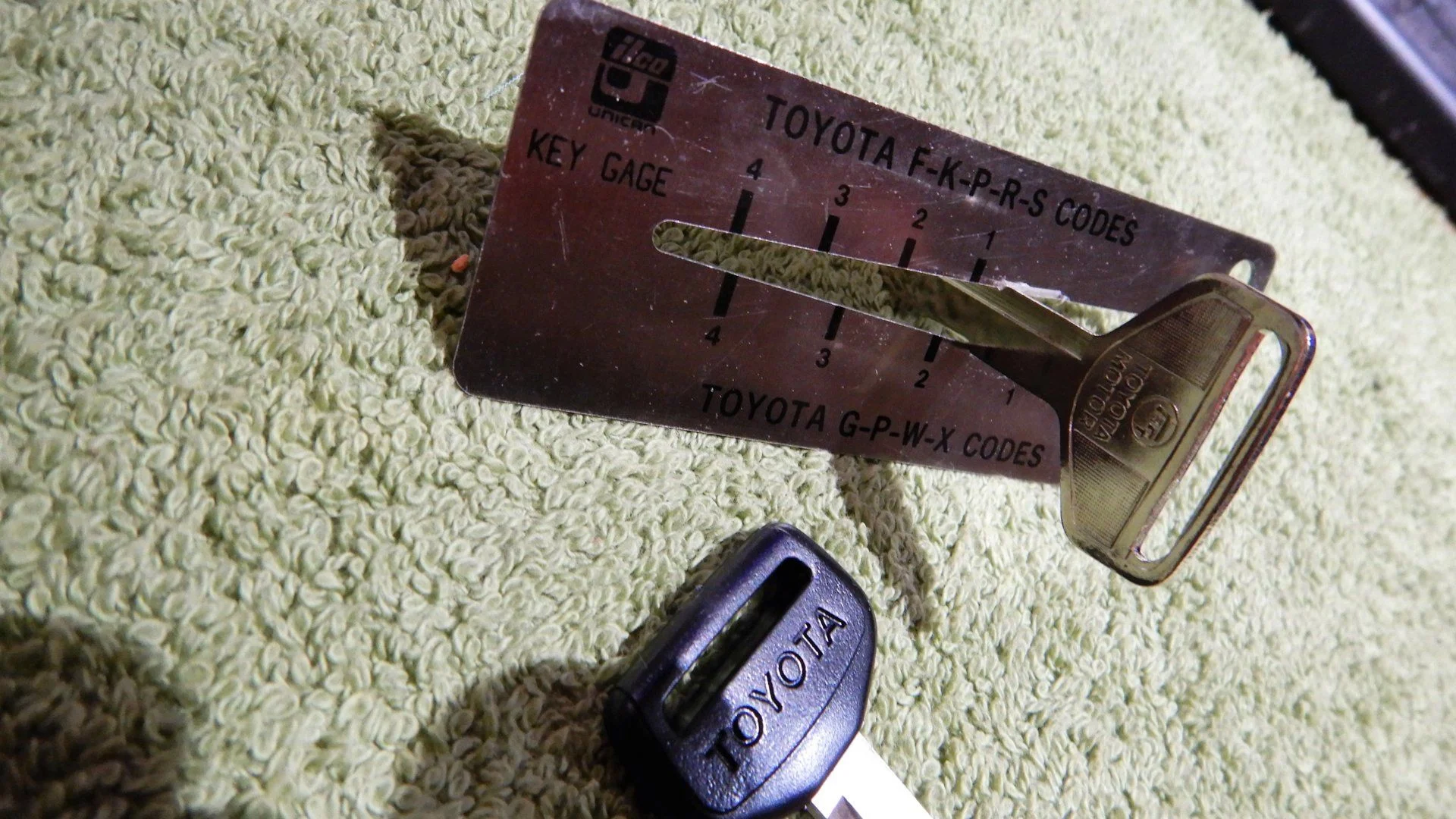

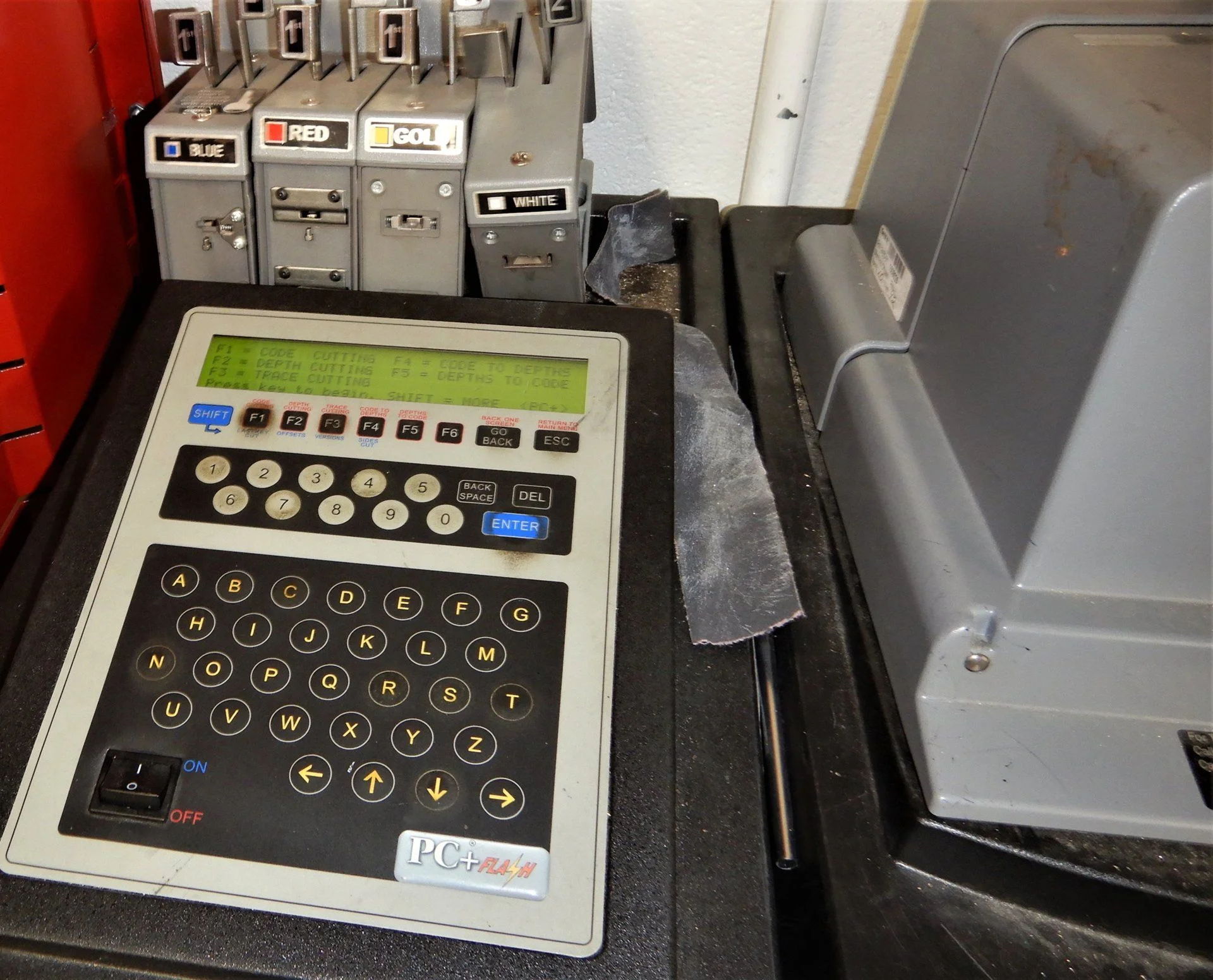

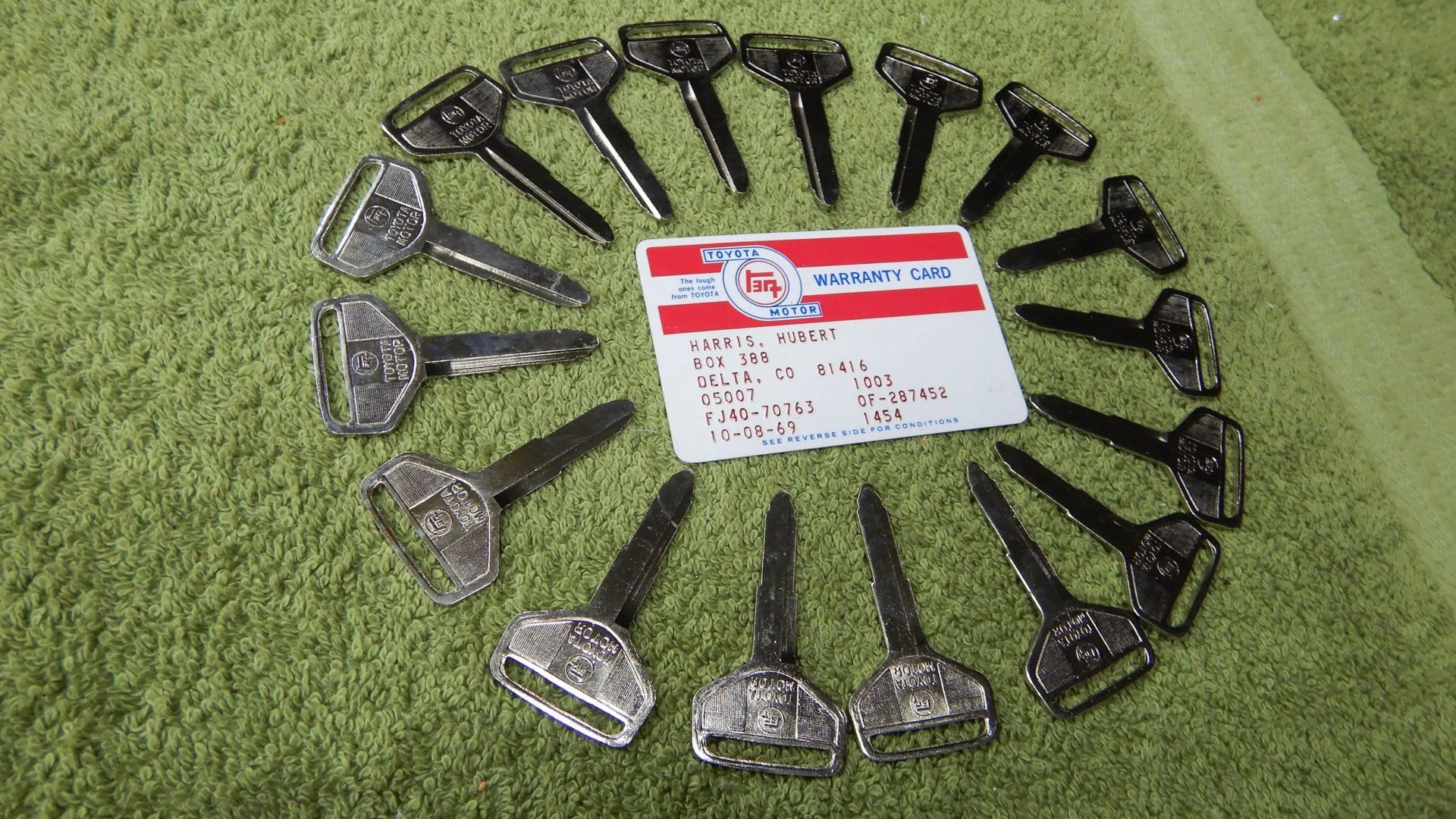

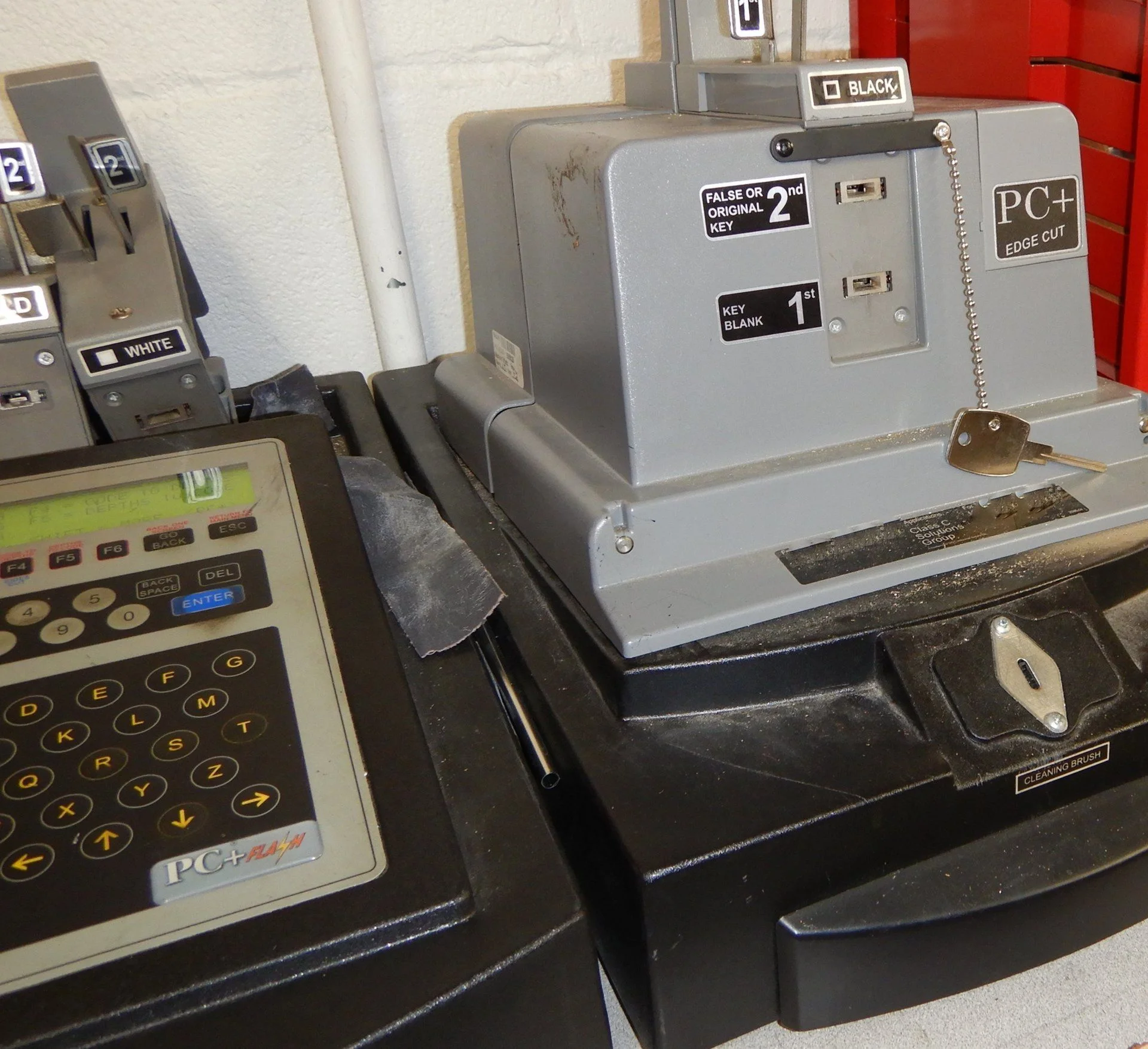

a little OEM Keys at work i have shot over last 2 years :

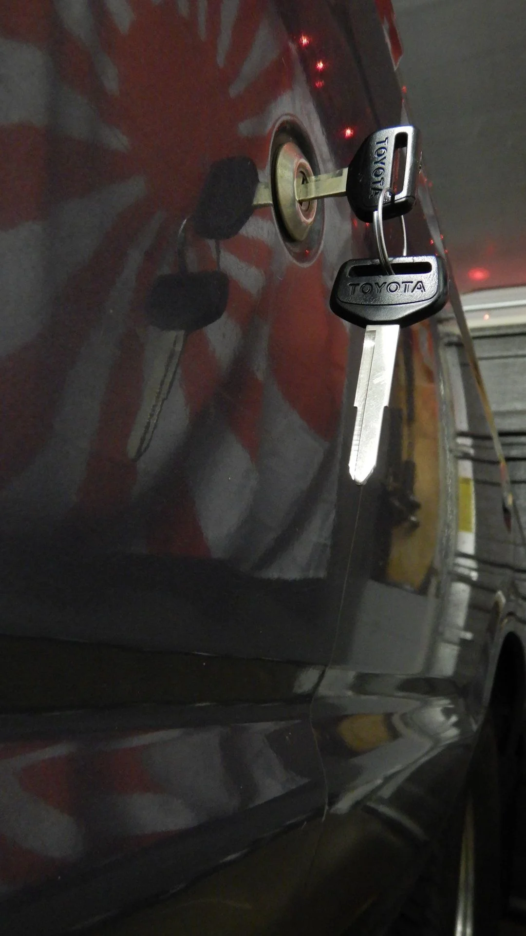

Is this what you’re looking for.....
