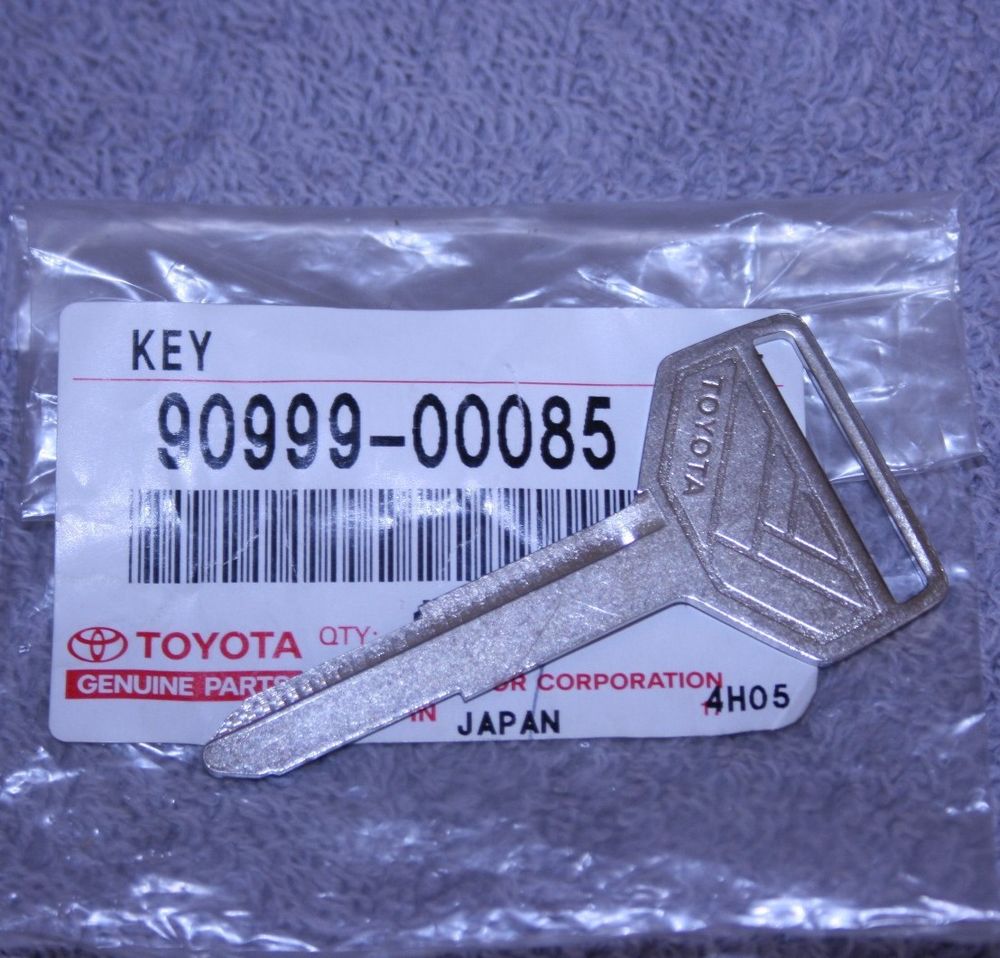

I don't know if this key blank looks like your picture, but the ignition key for the US model (assume Canada is the same) is 90999-00054, which has been superseded by 90999-00085, US$9.33 dealer list price.

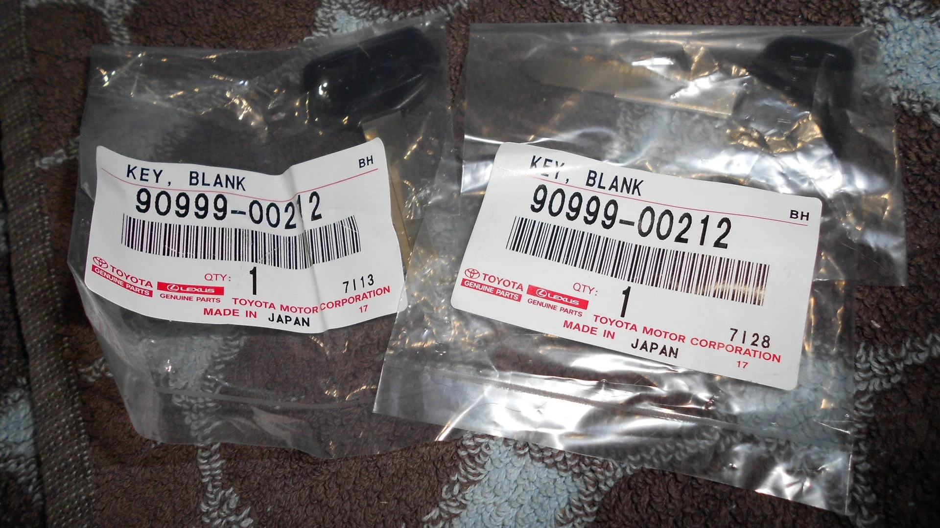

The Black Nylon Top OEM Toyota Key U have in the photo above part # is 90999-00212 , It retails for approx. $16 at any Toyota Dealer
I just picked these up friday for a lock re-code / re-key job on a 1/79 FJ43L-KC , So there still available

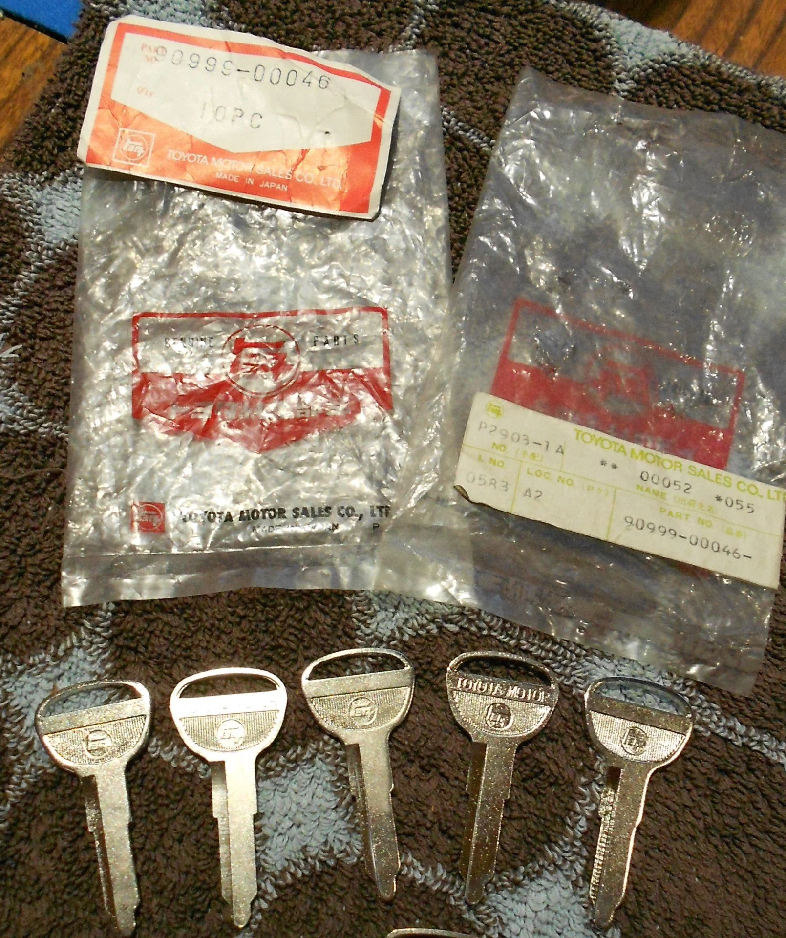

This Key Blank will fit All 1975-1991 land cruisers , Ignitions & side doors / fuel doors

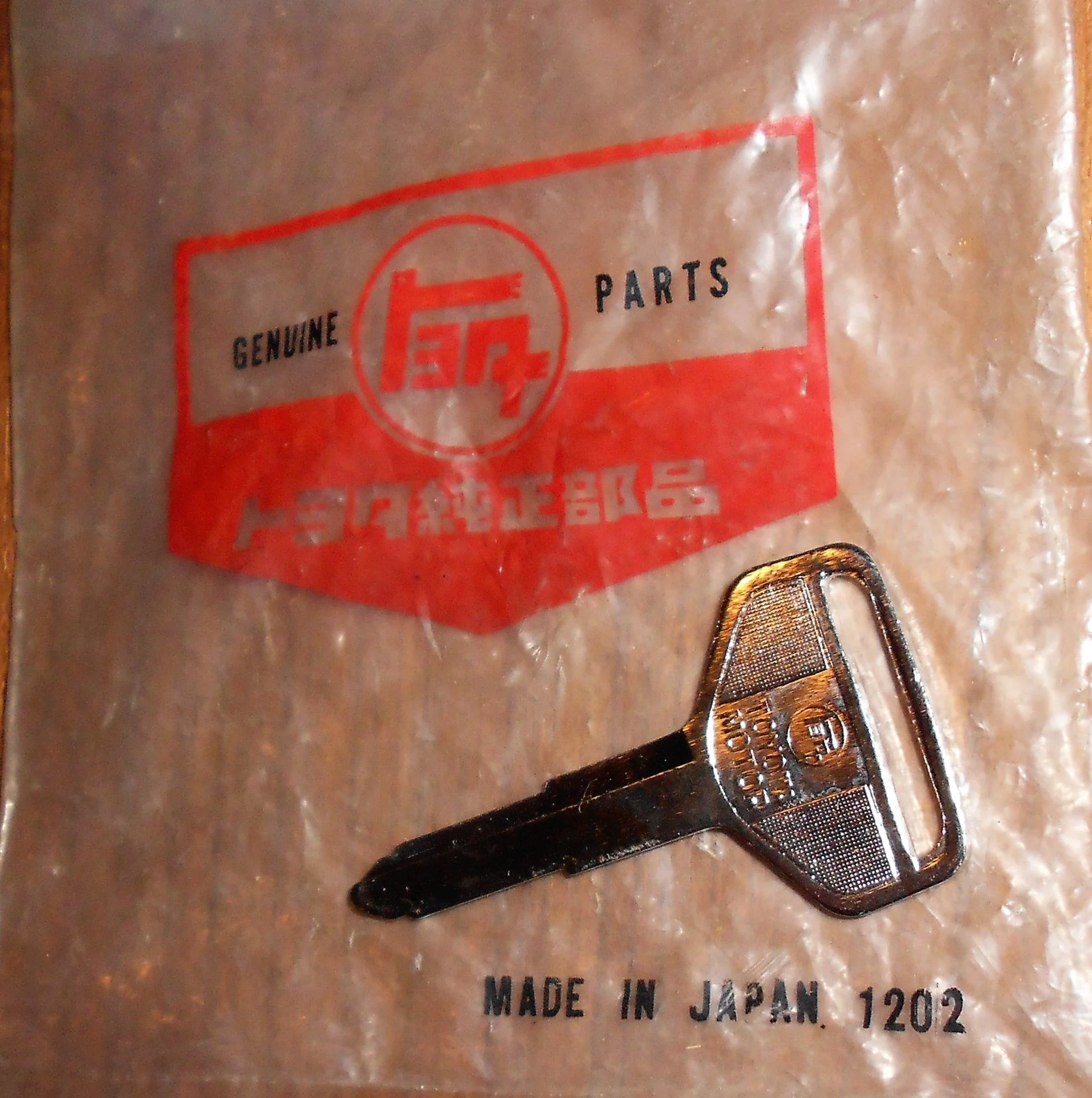

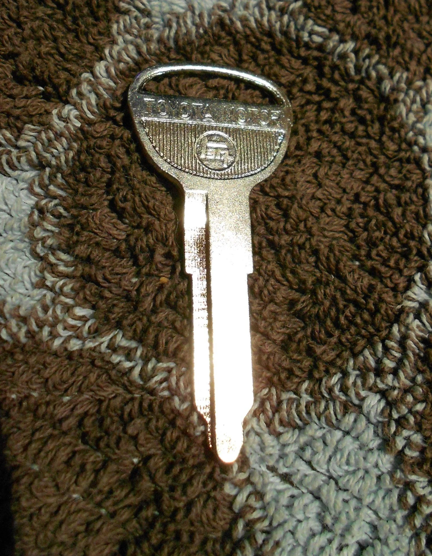

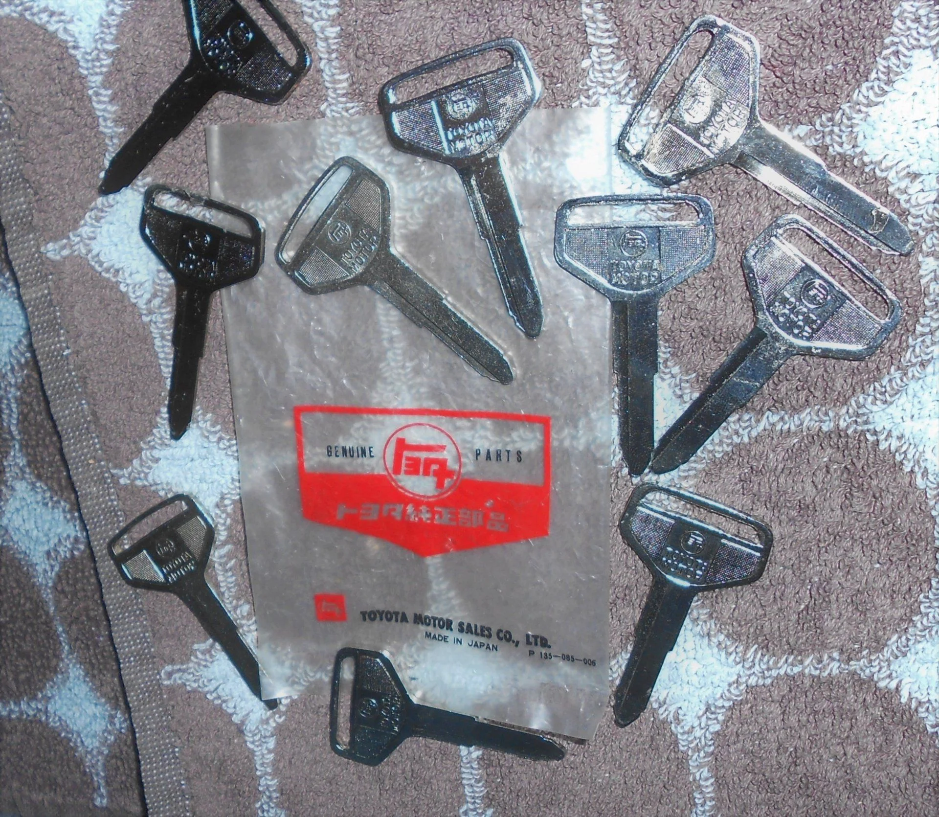

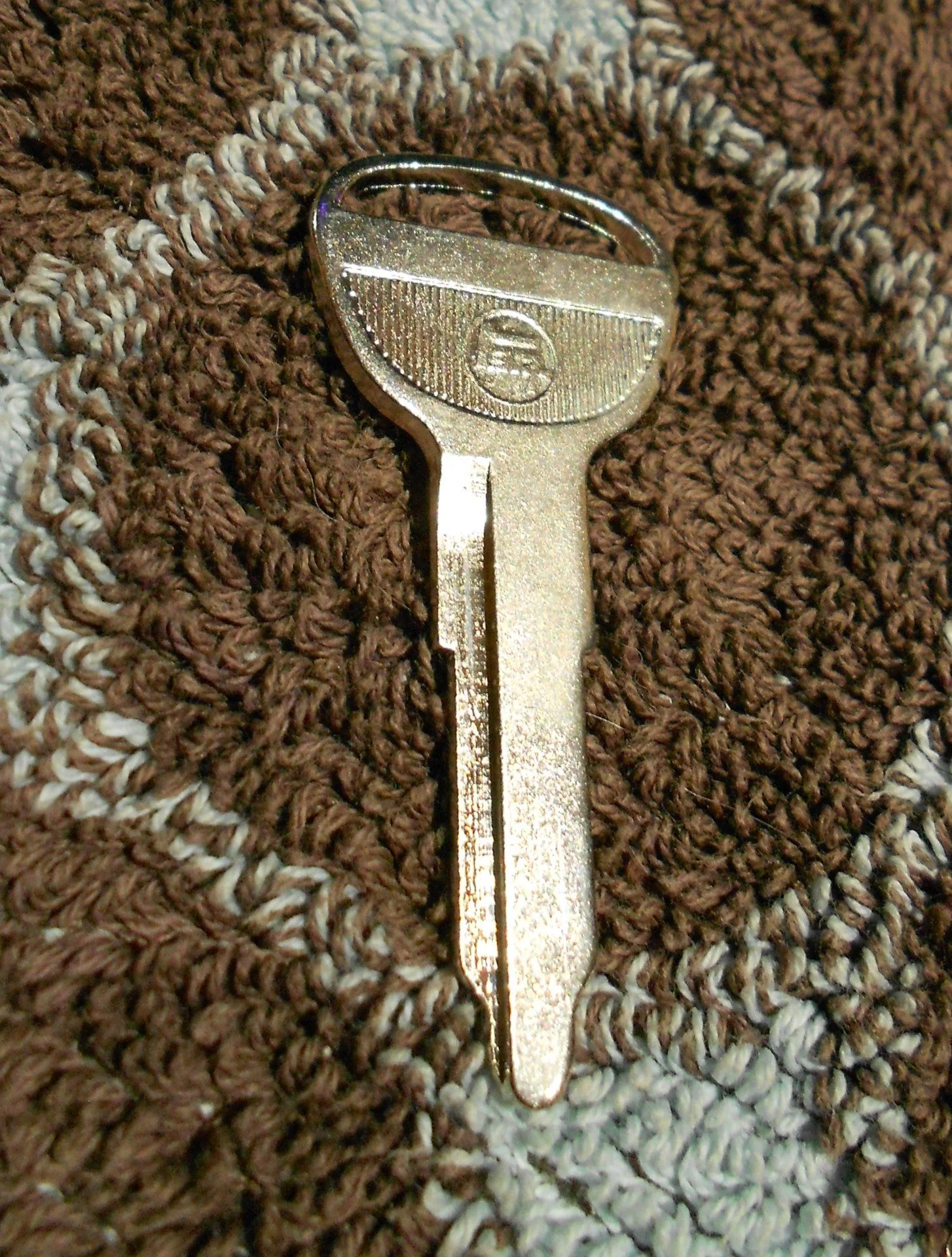

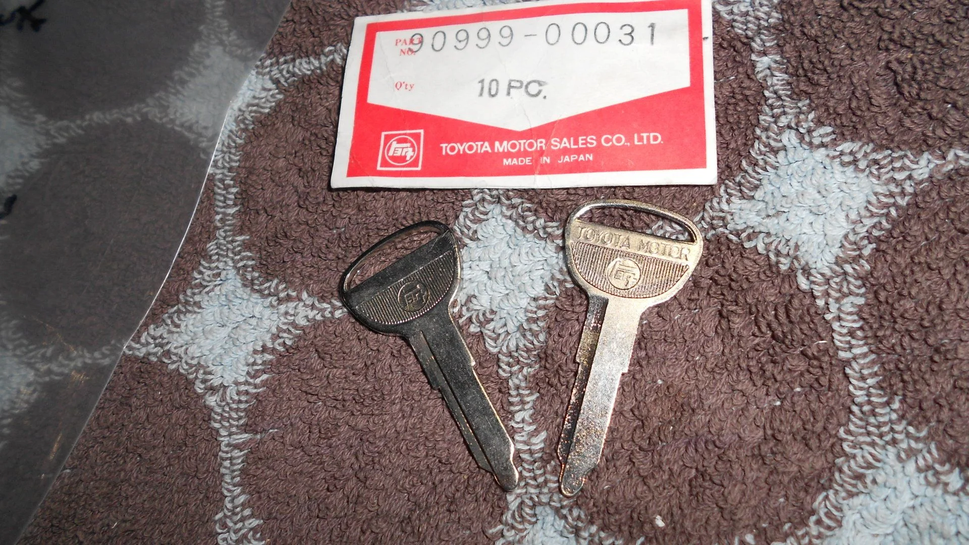

I have a few 1975-1991 NOS OEM Key blanks Available ,
- 90999-00031 ( Mini Wallet Key blank style ) TEQ LOGO & TOYOTA MOTORS logo's
- 90999-00046 TEQ logo one side / TOYOTA MOTOR & TEQ LOGO on the other side
- 90999-00030 TEQ LOGO & TOYOTA MOTOR logo both sides ( This is A Full Size Key )

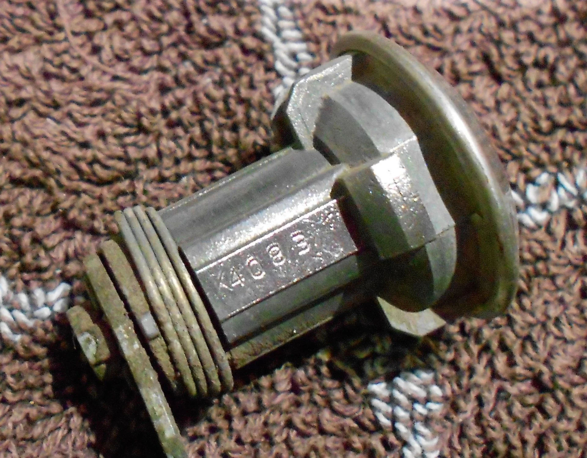

- I CAN Also Cut Your Key's to Your Factory TOYOTA Key CODE Using my Shops Dealership - Type SST Computerized key Cutting machine
- Your Factory Key Code Is stamped on your passenger side lock cylinder like this example
Not on a '74. No external passenger lock. The only locks are the rear hatch and the DS door (both single-sided key) and the ignition and fuel door (double-sided key). Sadly, no code on the fuel door lock cylinder. Even sadder, if you don't have a key to get the ignition lock cylinder out of the steering column, you are SOL.
The Original 1974 Keys them self's ,( ones sold with any new Toyota Vehical , Both single sided & Double sided Ignition , doors , rear hatch etc. had the key codes stamped physically on them

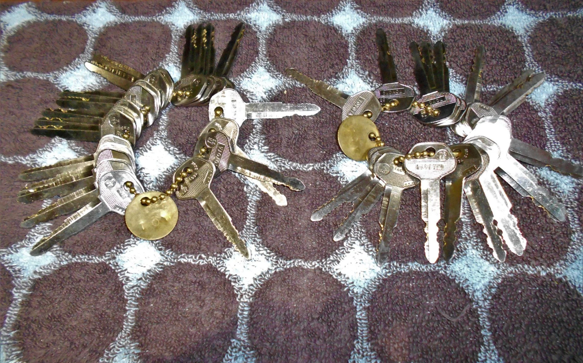

I also have a complete set of Dealership SST master keys for Double sided 1973-1991 FJ40 , FJ55 , FJ60/62 / or commonly refereed to TR-33 lock smith's " Test Keys "
These are a full set of ALL Factory Toyota Key Codes ,
One of the 250 pc. set would correctly engage & open your ignition cylinder on your column like U mentioned ,
I could then send U a working set of keys back in the mail i cut to the matching corresponding key code
all U need to do is remove the main Magnesium Ignition lock cylinder housing from the main steering column witch is held in by 1 snap ring , and fairly simple to do
