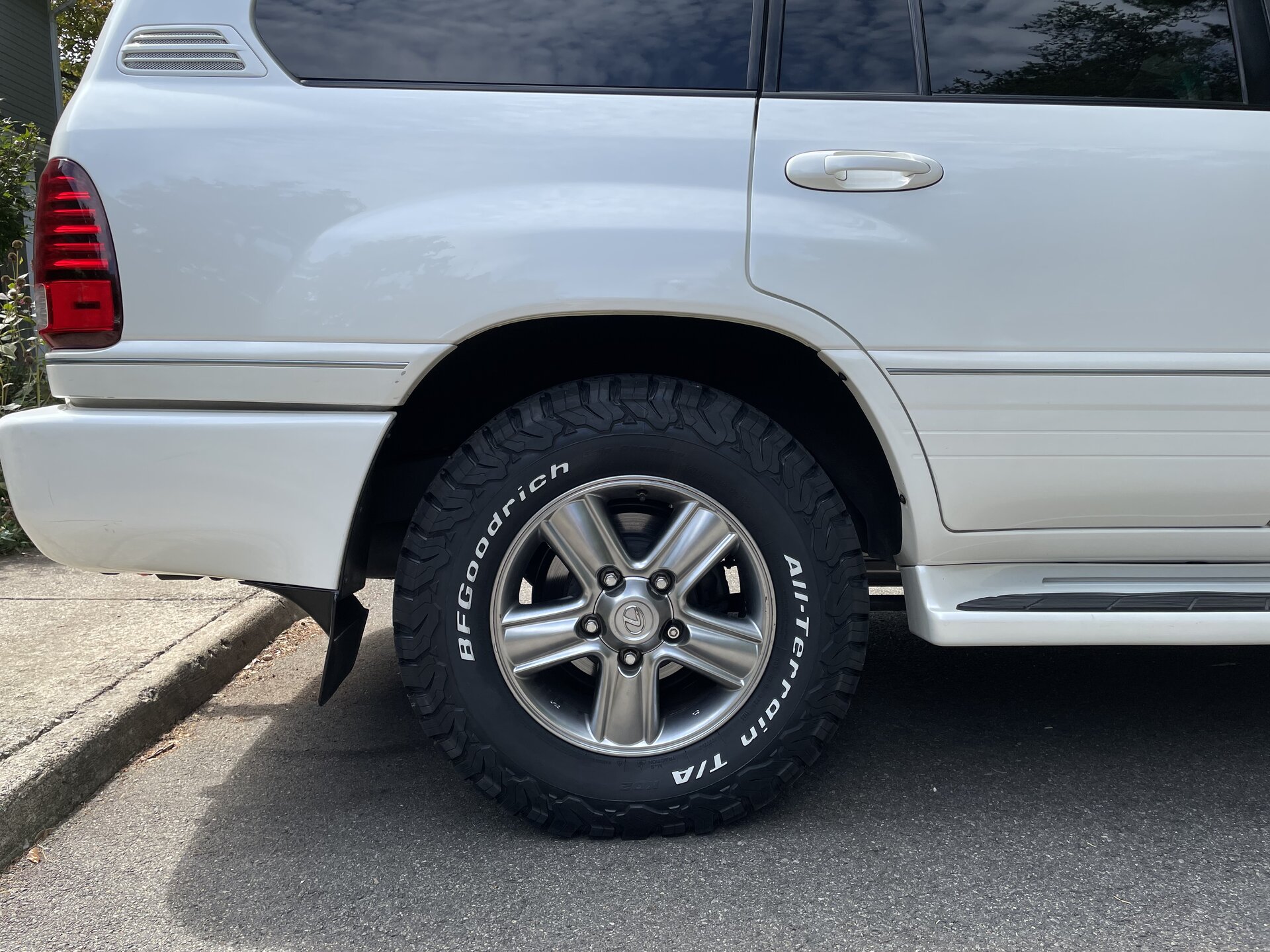

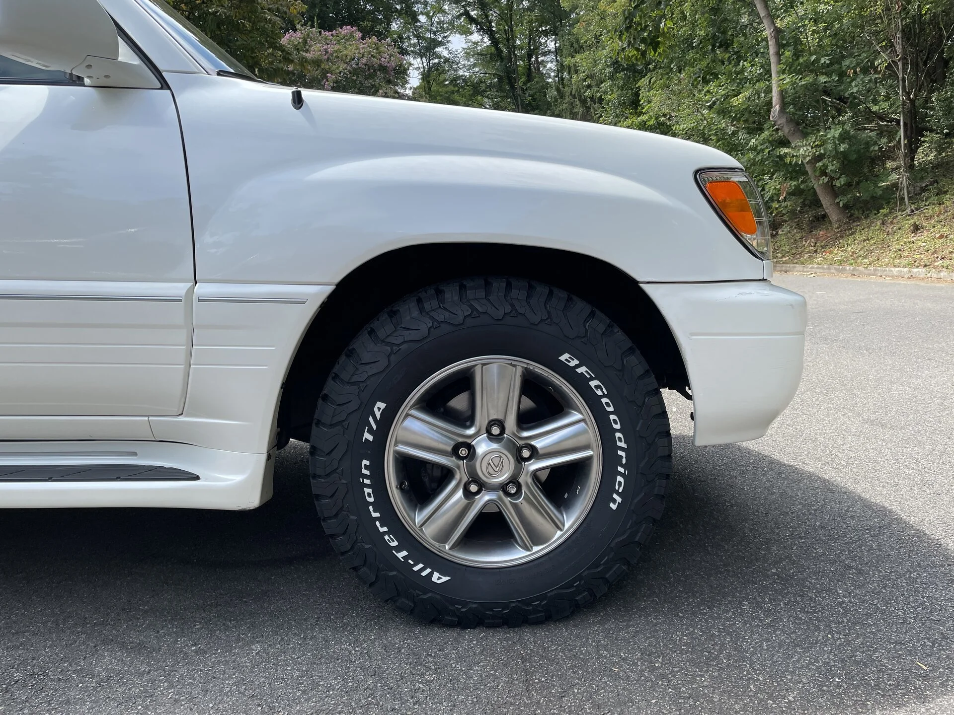

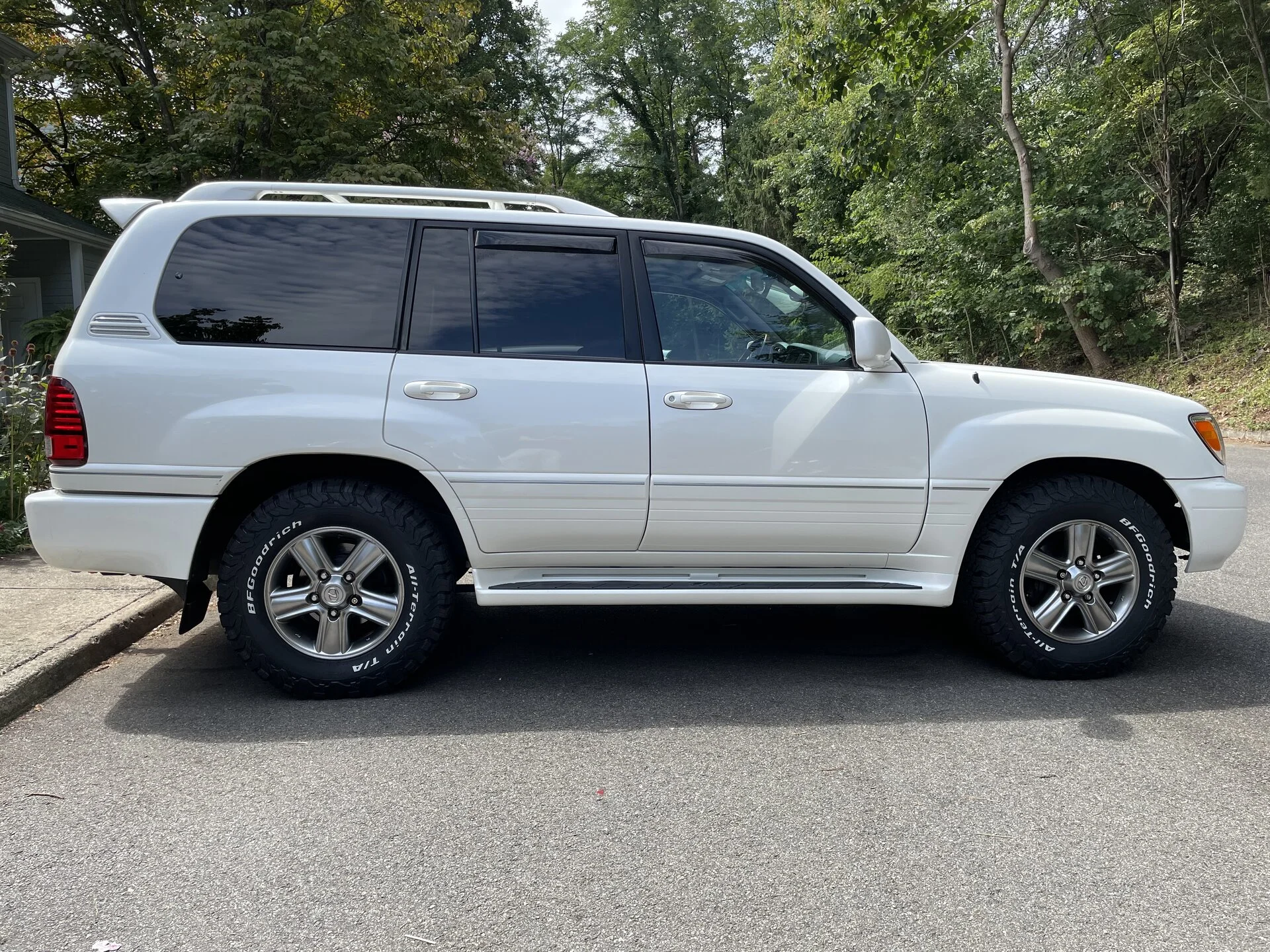

Confirmed. We have the same YM LX470 and I went through that same tire setup up to now I still have that tire. It will rub on LOW, in Neutral and High it won’t.
Hey @LowDrag82, can confirm that tire sizes works without rubbing in normal AHC mode. Enjoy! FYI, here you can see I am in Hi.
Are you saying it will rub in low and neutral or just low? I can’t think of a time I’ll be in low because I’m not going to tow anything large
Awesome pic man looks great
No rubbing in no way with 2757018. Been rolling those for many years.
