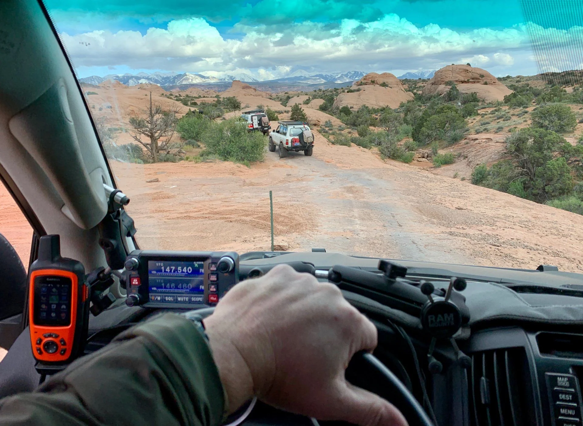

Here’s how I mounted my interior main unit (Yaesu 400xdr)...
Control unit:

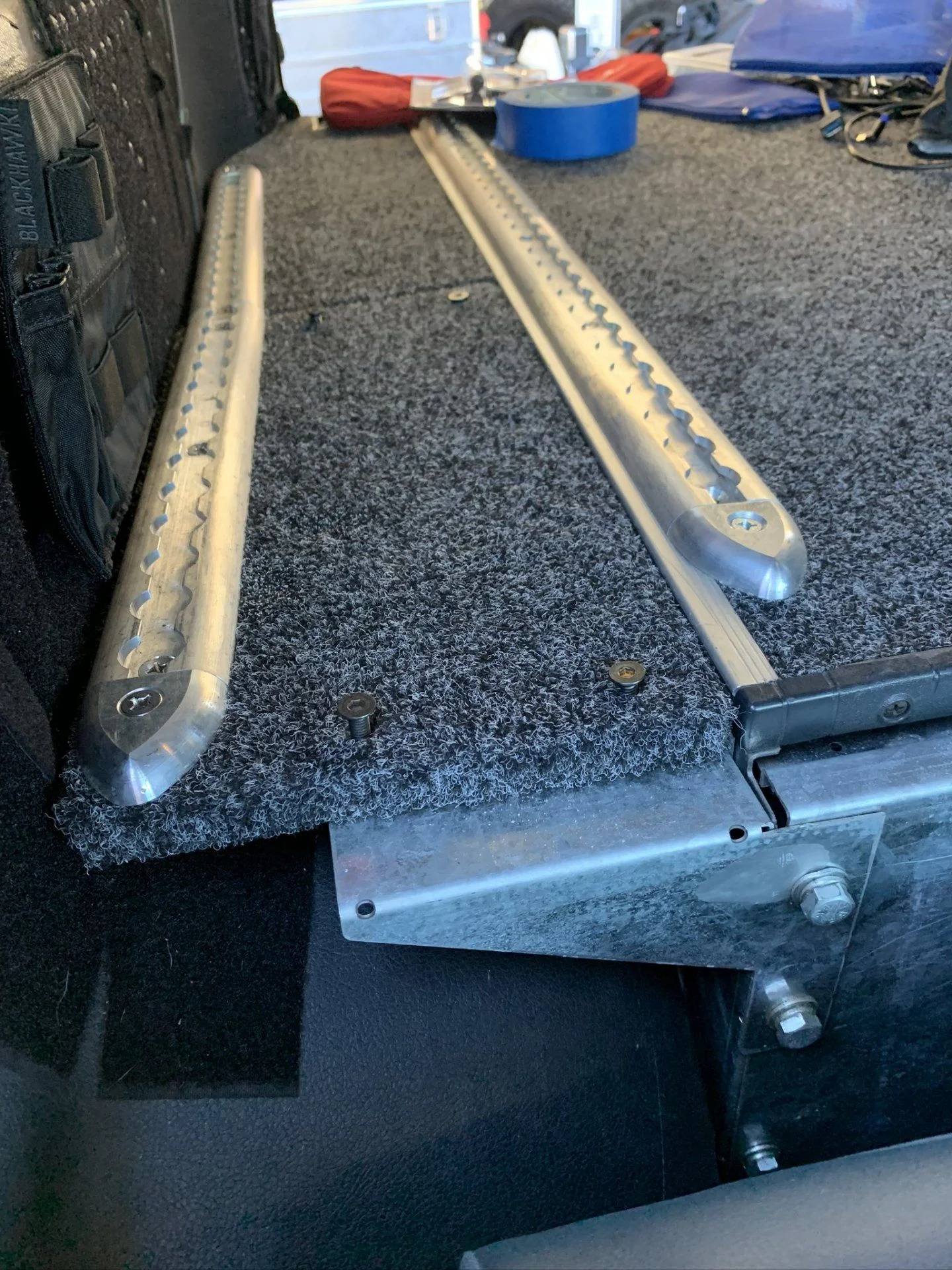

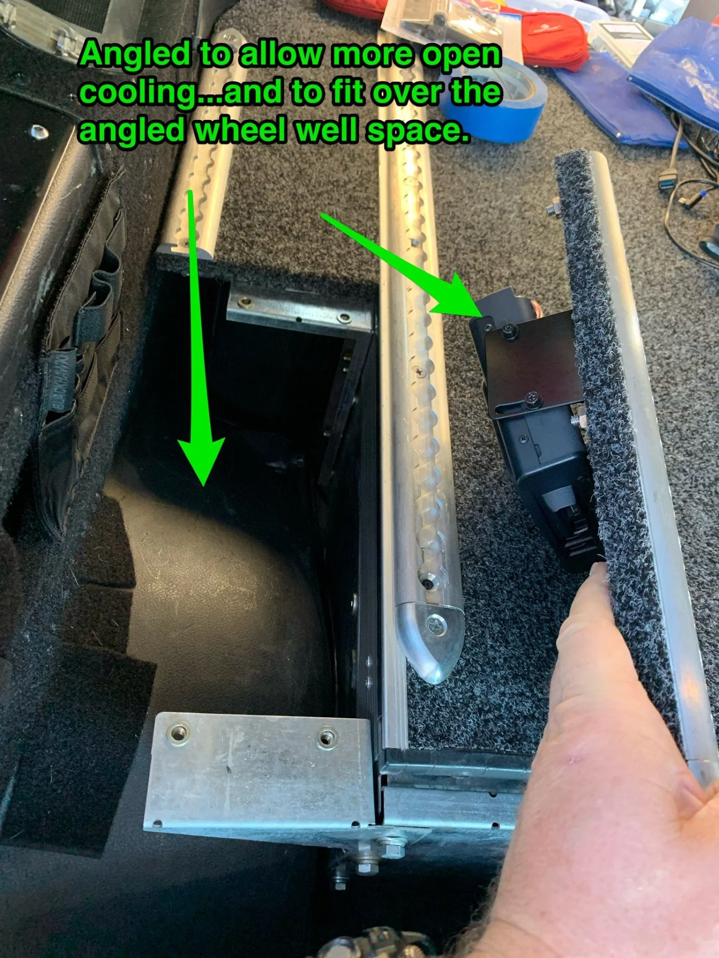

Ah. I already had power running to the rear in several ways...including paths from both batteries for different purposes...
...but if you need power back there for the first time, it depends on whether you want to run on your main battery or your 2nd. If running off main, you can run just a single positive wire through the firewall on driver and back though the door jams...then run a negative from any number of ground screws in back.
If you want to run it off of your 2nd battery (that’s what I do), you can easily run both positive and negative wires to the back through the much easier-to-access passenger side firewall.

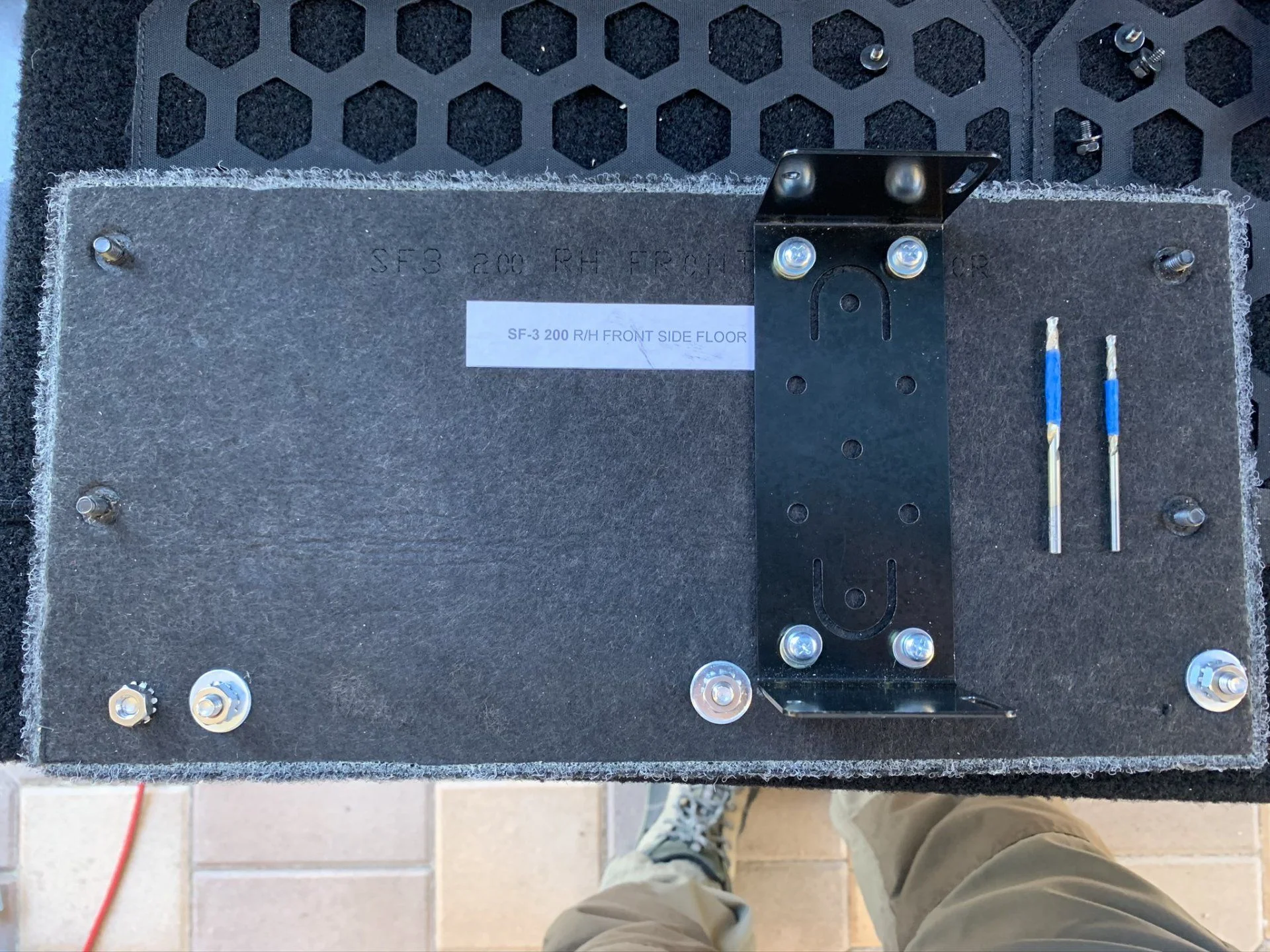

Hey Markuson do you have a picture that shows how you attached the head unit of the yaesu to the ram mounts? Just got a yaesu 400 however I am not really sure where or how to mount it so I'm skimming through pictures and such on here. Thanks
Oh... :) I’ll snap a photo...
