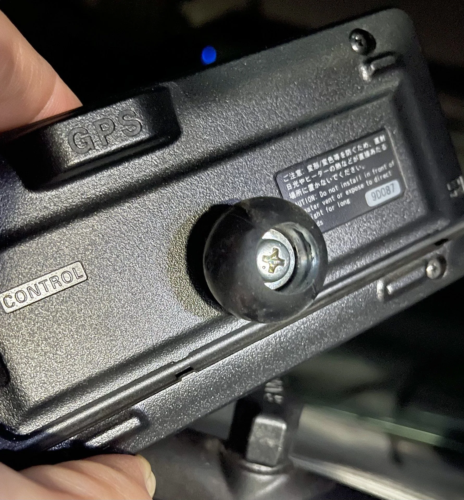

Hey Markuson do you have a picture that shows how you attached the head unit of the yaesu to the ram mounts? Just got a yaesu 400 however I am not really sure where or how to mount it so I'm skimming through pictures and such on here. Thanks
Hete’s what I did...using the existing hole meant for yaesu’s own mount plate (just used the screw)...

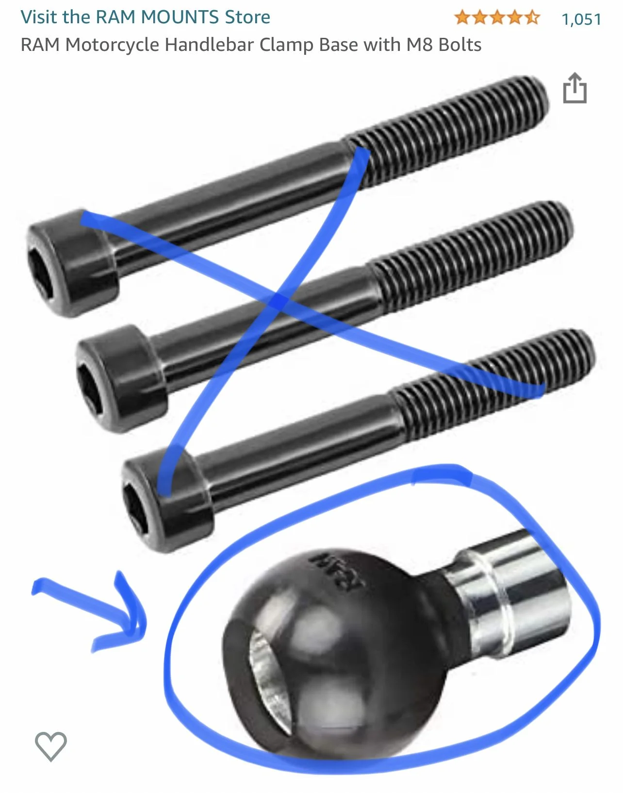

To be honest, I can’t remember if I just took the end off of a RAM motorcycle handlebar mount...or another ball...but just a single screw through it into the same hole the Yaesu’s included plate attaches with bia one screw.
Similar to the ball on one of tgese:
I also added a small cut piece auto emblem 3M rubber tape between the ball and back to create friction anf prevent it from unscrewibg over time. Its been 100% solid.
Then you just rig up your RAM pieces as usual.

Thanks Markuson! I also found this as well while scrolling through hundreds of pages haha.
