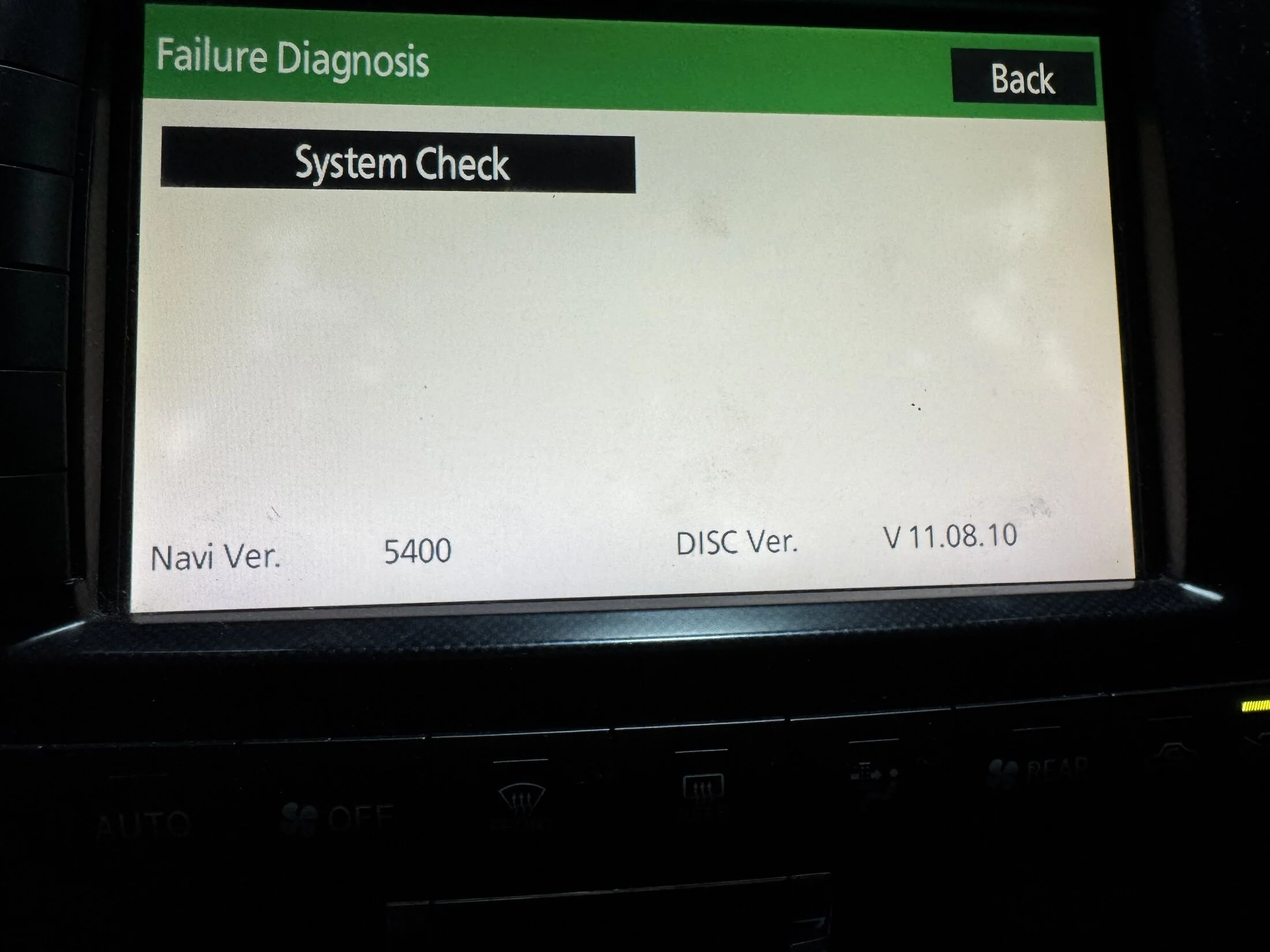

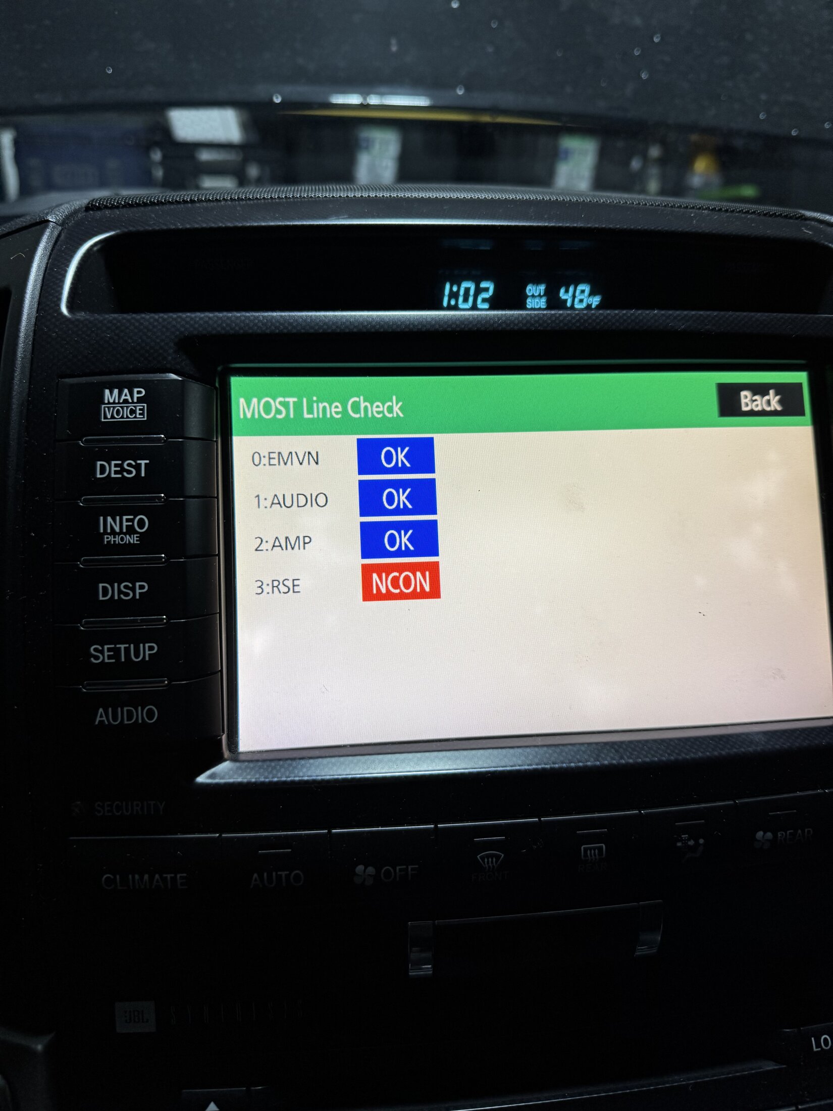

Exact thing just happened to my 2011 LC too. Lots of research so far, but no answers. I did go into the diagnostics and see that the RSE is non connected.

I'm currently helping a friend with their 200 with the same issue. I noticed corrosion in the fuse box on the driver's side. Anyone solve the issue? I have checked the fuses and found nothing. I am ready to either pull the radio or start digging under the steering wheel. If anyone has solved this, it might save me from looking in the wrong place first. If no one has any direction, I'll probably start at the radio to check power there then work my way back. If I do have power at the unit, then it's likely the unit itself.
As a note: in contrast to the image above which has says NCON next to 3: RSE, I'm getting it next to 1: AUDIO.

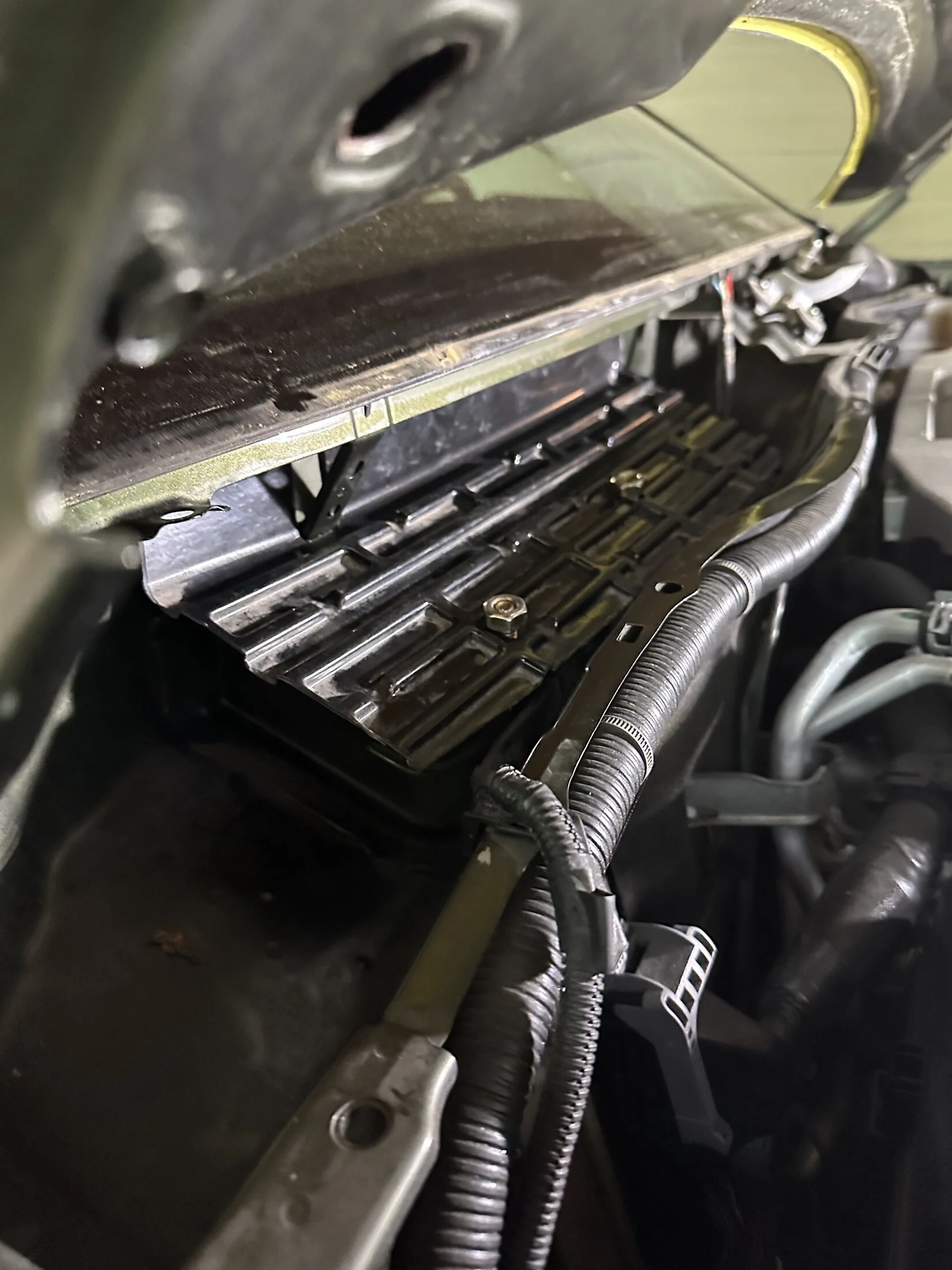

I have gone through every connector and fuse and don’t see any signs of corrosion but as an earlier post mentioned it’s a water intrusion issue, which is what happen. I took the cowl off and made a little plastic roof with standoffs over the cabin intake. If I have to I will buy a new cowl. It’s has an 1.5 inch gap all around the intake and over hangs 1.5” all around. I used an old seedling tray and some random nuts and bolts I found. The intake roof obviously won’t solve the busted audio and it’s a little janky, but hopefully will prevent further damage.
