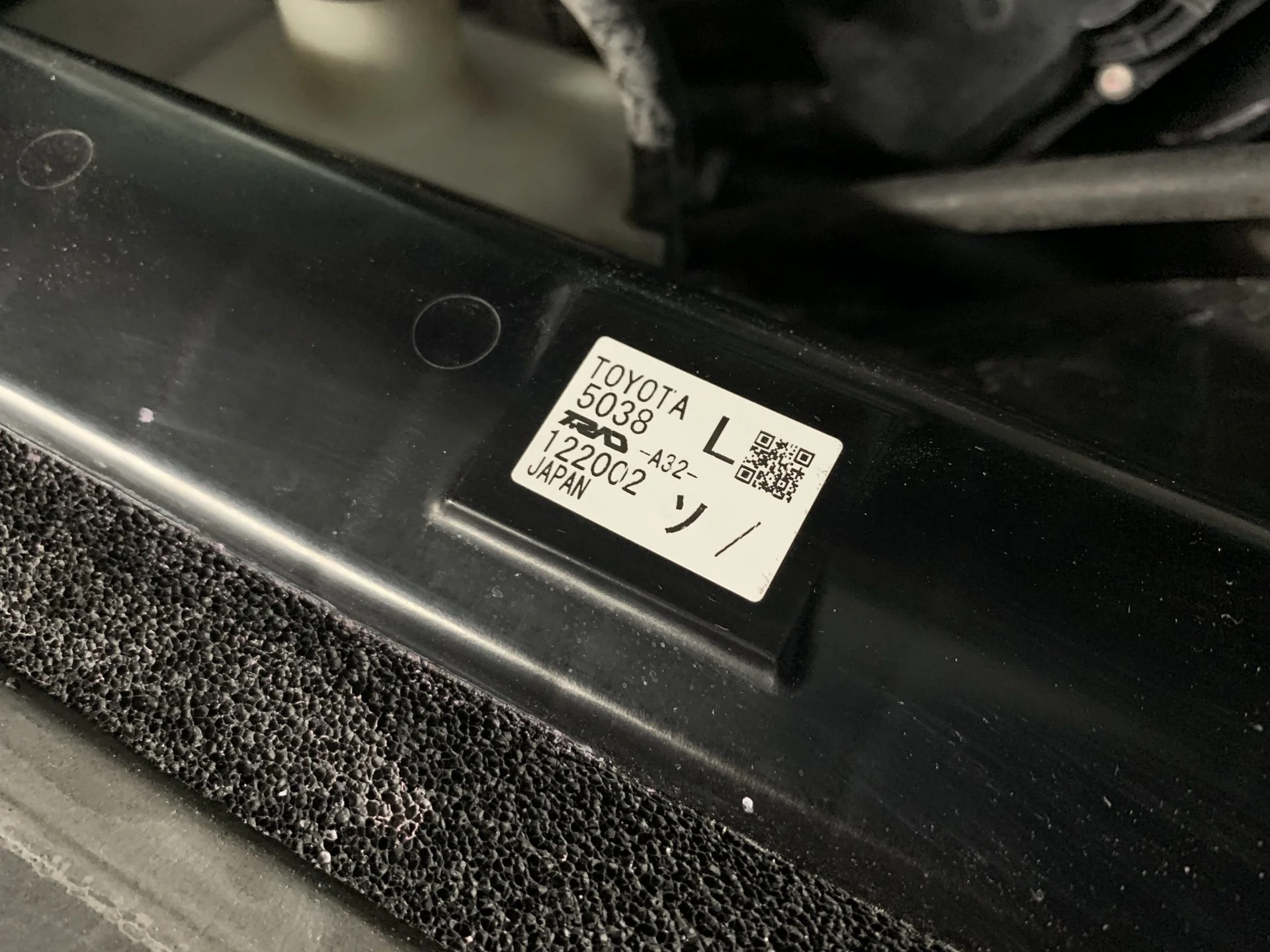

I assume this is the old version radiator?
That's the new style radiator.
I might be wrong. See my post below. Looks like the angle of the photo is hiding the angle in the front where the crack generally occurs.
Oh sweet! How can you tell, the part number? I was trying to figure it out but got lost. Thanks!
Unless the angle of the photo is fooling me (quite possible), it looks to be the the new shape of the little relief box. The old has a 90 degree, .5 centimeter drop towards the front of the vehicle.

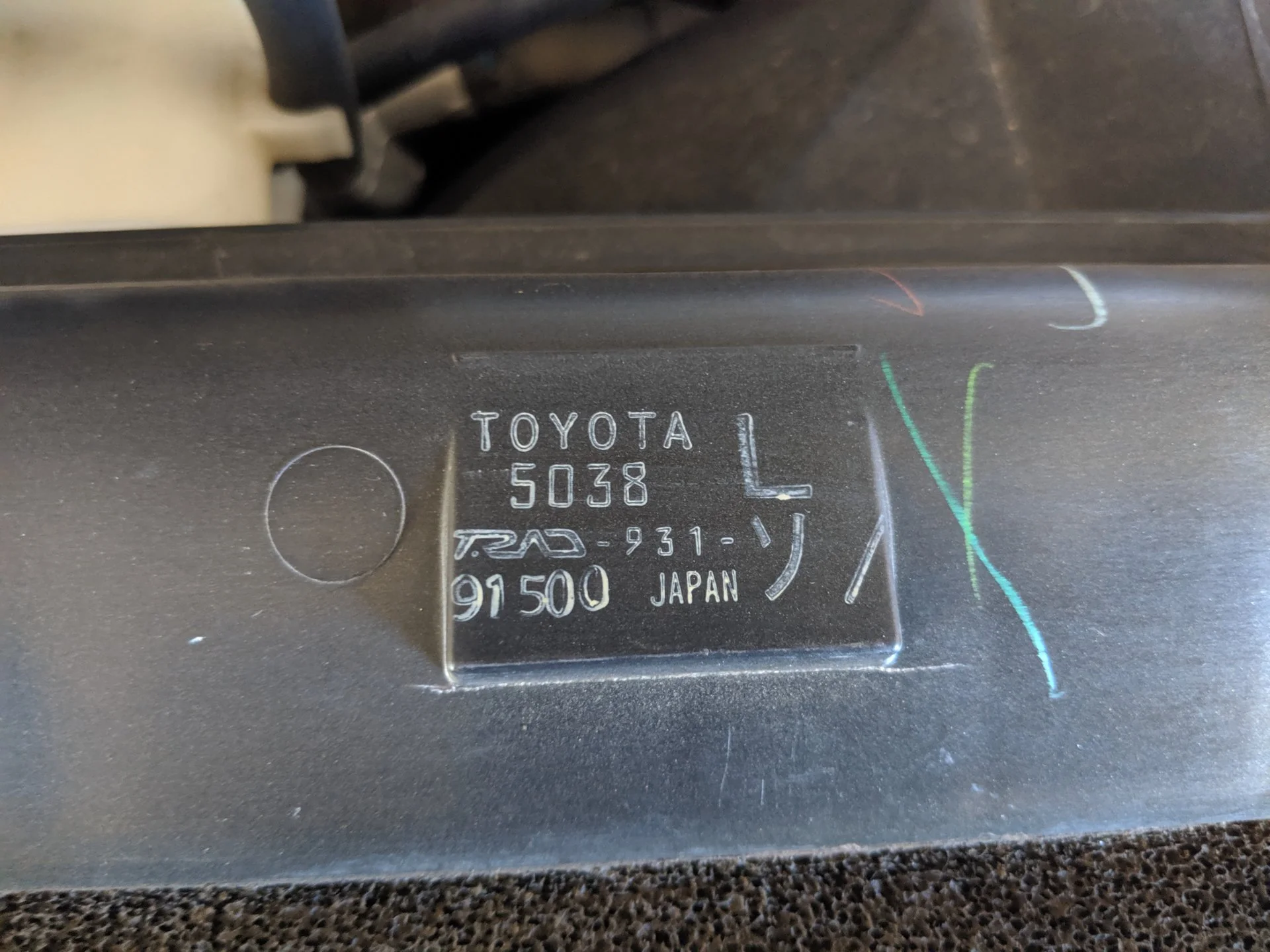

Here's a picture of the old one along with the emerging crack, courtesy @gocougs (was the first one I found).

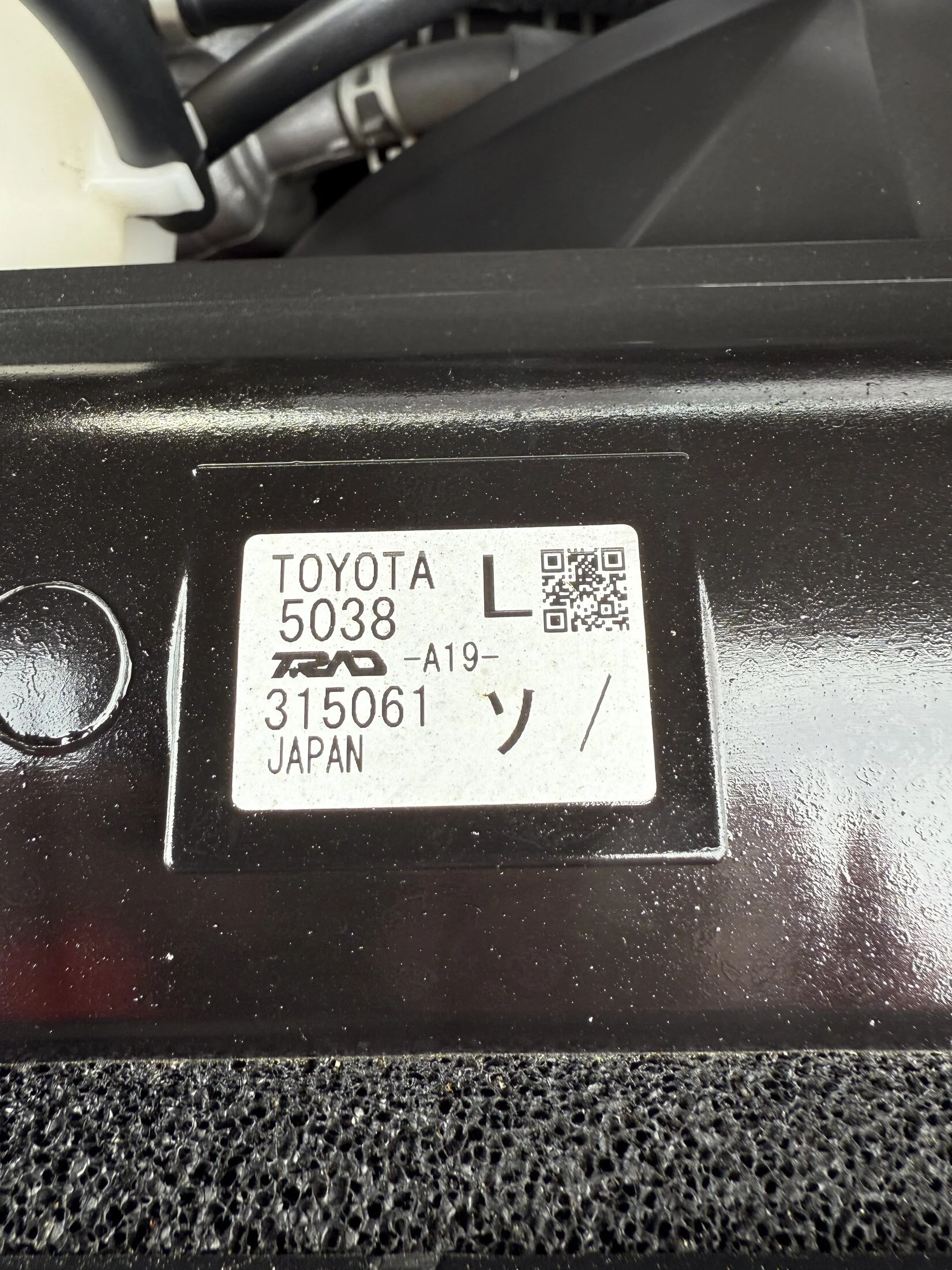

EDIT - to add this photo of the new design:
Thank you! And thank you for pushing me to do so in previous posts :)
