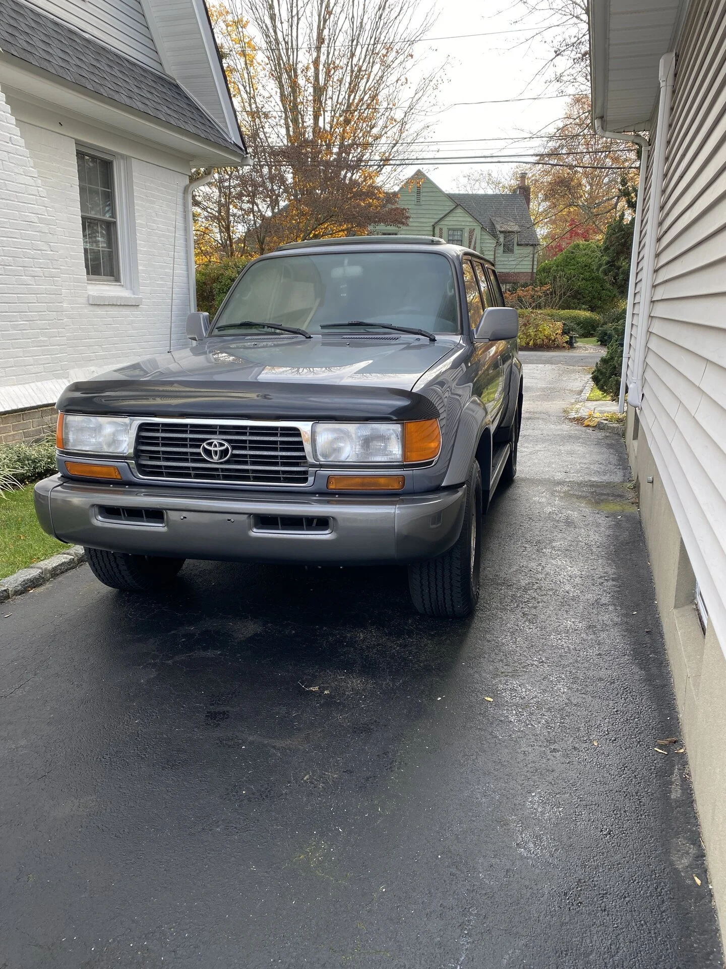

Just joined today and just received my 1995 Land Cruiser last night. I got triple lockers, it's a blue gray color and rides real nice. I found some rust rot in the back bumper that I posted about and would love some thoughts on.
I will most likely get a roof rack and some beefy tire and rims within the year. I have a firewood business so will be using it for my human family and for my axe and chainsaw family.
I live in New York (suffolk county) and am dreading the salt lined streets.
Can’t tell much from that! Post under carriage pics. If its crusty, drive it like you stole it and enjoy it before the rust demons make a meal of it. If good and you feel for it like a second wife, moving out of the rust belt is the only option. Pics pls. Looks decent from top.

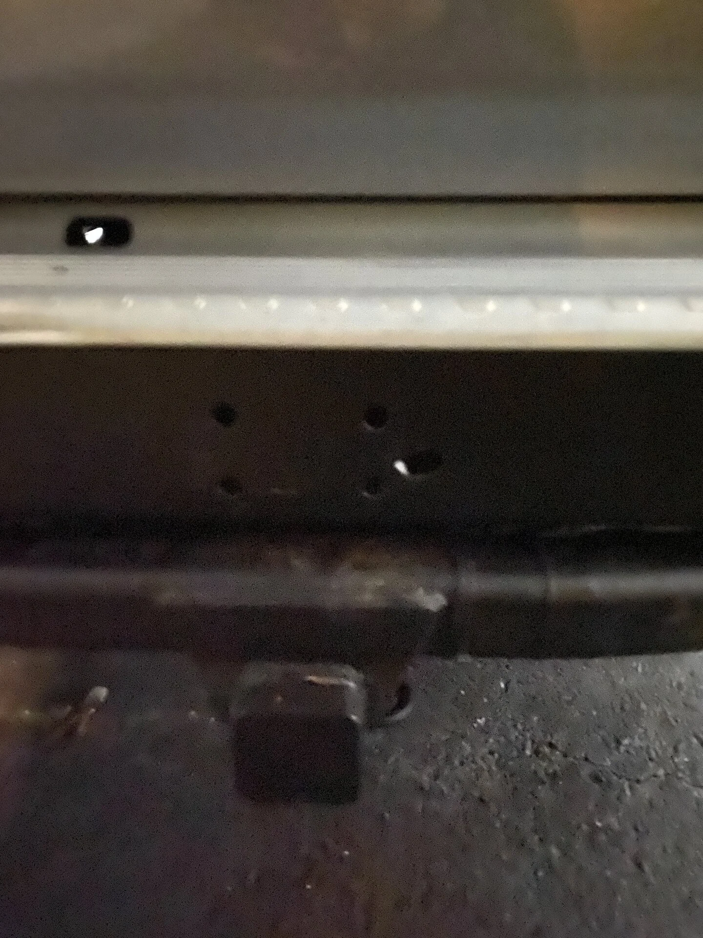

The under carriage was covered in Line-X so there is nothing to show from there that would look bad but this is the rear bumper. I have all the service records and the previous owner owned from the get go. Everything has been upkept so I am just baffled about this bumper. I even got a hold of the Toyota service center that serviced this car since 1995.

Don't wait until it "wears down" to use the Woolwax. Woolwax will soak in and get into cracks.
Line-X will trap moisture under it and allow rust to grow undetected.....
Oh, and that "rear bumper" rust you refer to? That is your rear frame CROSSMEMBER, so you NEED to do something about that.
To me, painted or hard undercoat products are scary unless done properly - stripped down to clean metal/paint and started from scratch. If they are used to cover up existing corrosion or rust, they are actually trapping it & moisture and ultimately accelerating the process… do a quick Google search and you'll see
Many people try to cover up rust and corrosion before a sale, so for example, if you see what looks like recent paint or undercoat, that's something to look into. First thing I did when I went to check out my 80 was crawl around underneath, tapping around with a hammer.
Definitely still use one of the lanolin products. In fact, a properly-applied hard undercoat in conjunction with fluid film/etc is a very robust combo
All that said, not trying to alarm you. Give it a good check and start an annual or bi-annual fluidfilm/woolwax/etc regimen

Or get a 4x4 labs bumper. Its an upgrade to bumper and cross member
I guess the moral of the story is where do I go to get a rear crossmember/bumper repaired on Long Island?
Its welded in. You'd need to cut out the old one and weld in a replacement from a donor vehicle. Or a 4x4 labs bumper, which replaces the rear cross member.
Or find someone near you who bought a bumper and get their old crossmember, the crossmember hangs out far enough it shouldn’t be to hard to weld another one in..
