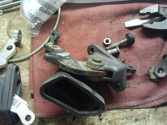

Check you parking brake bell cranks, grease them or replace them:
