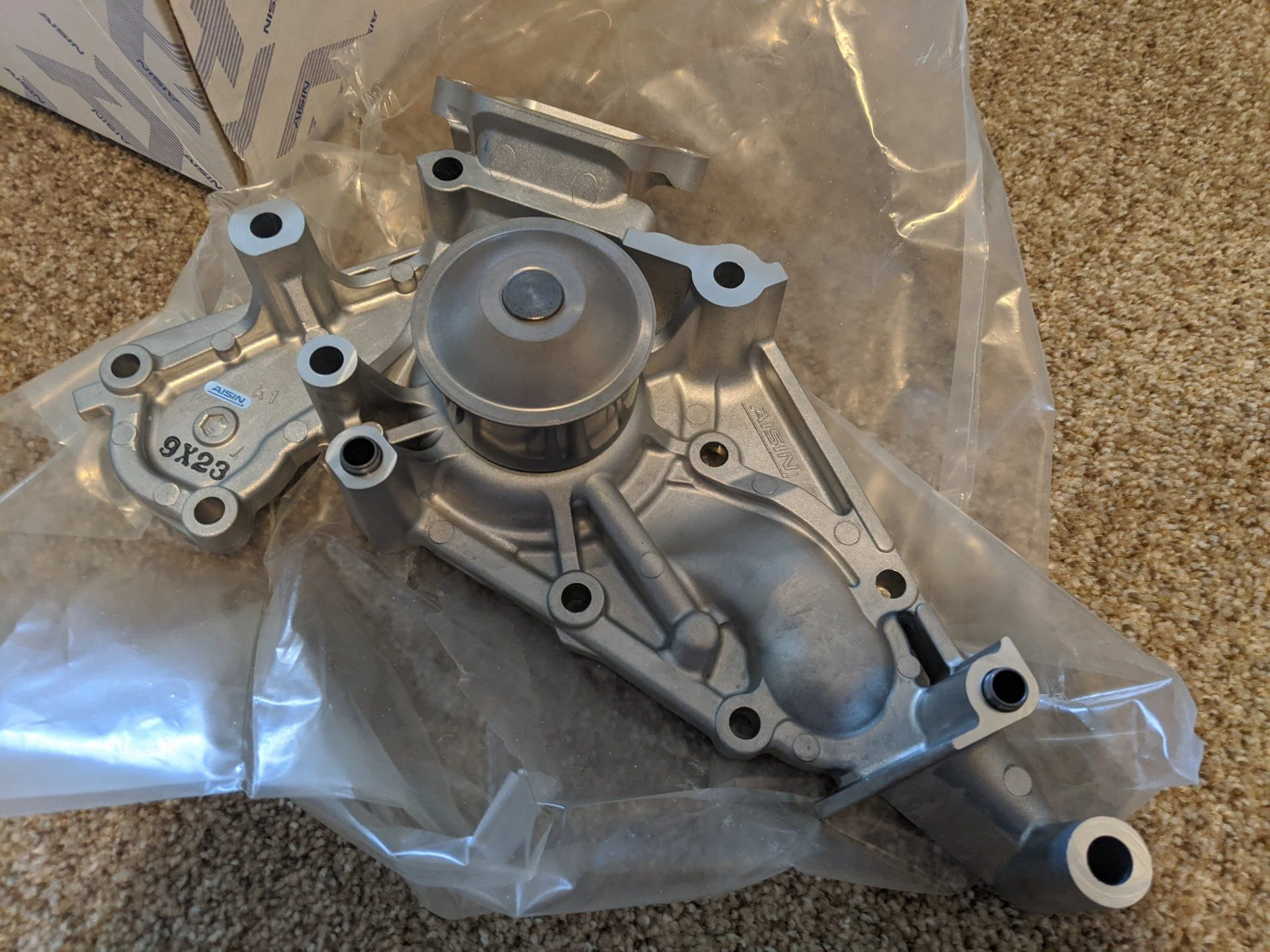

There’s absolutely nothing on the WP indicating it’s Aisin. Maybe I don’t know where to look but that’s the only piece that I’m slightly worried about. I think Onur said it was good though and I trust him. There a bunch of tools to buy to do this job too. I’ll list them or at least what I bought or thought about buying

I just received my Aisin TKT-021 (packaged 2/17/20) kit from Amazon and the water pump has an Aisin sticker on it and Aisin is stamped into the casting. Good to go there. It came with Koyo idlers, NTN tensioner, and Mitsuboshi timing belt. I also added a Bando serpentine belt and am still deciding on the fan bracket.
I've actually used 4 of those kits in 3 2UZ based vehicles I own and they were all top notch.
