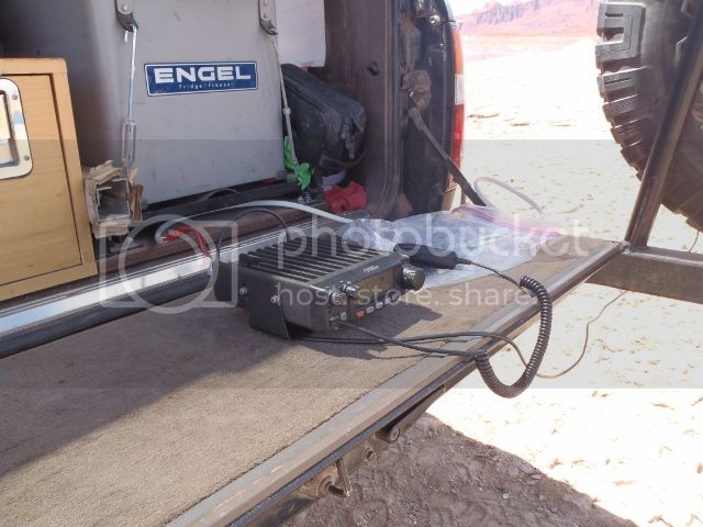

Here is a N9TAX antenna in use in Utah. Notice the pure jankyness of the whole thing. Fishing rod to hold the antenna jammed into the tire carrier, Beno's ressurected old radio on the tailgate, dangling wires back to the battery, there's even a zip-tie! But I was talking over 100miles to a guy in Arizona from a place you normally can't get a radio signal.
