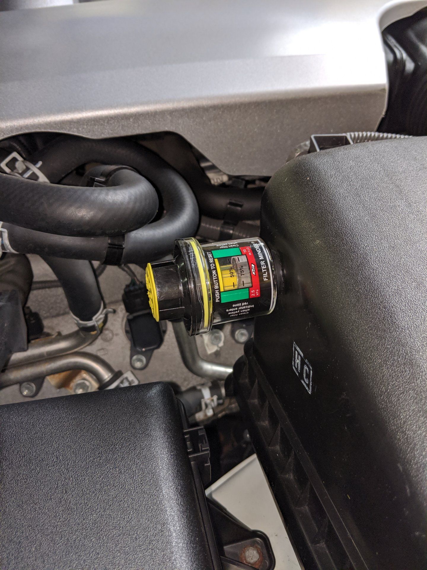

Ok so the Filter Minder showed up today, I went with the K&N one that @gaijin recommended. Pretty slick, very easy to install. I didn't like how it crowded my second battery if I put it in front, so I installed in the rear of the upper airbox. I pulled it off the truck to drill the 11/16" hole (step drill), so I could shake out any little shavings that fell inside. Push the grommet in, then the filter, put it all back together. Very easy.
My air filter is in pretty good shape, so the Minder barely moves, but I'll keep an eye on it.

It was a very light gray. Inside of the upper section was pristine, not a speck of dirt. OEM filter, I believe about 10K miles. Truck has ~63K on it.

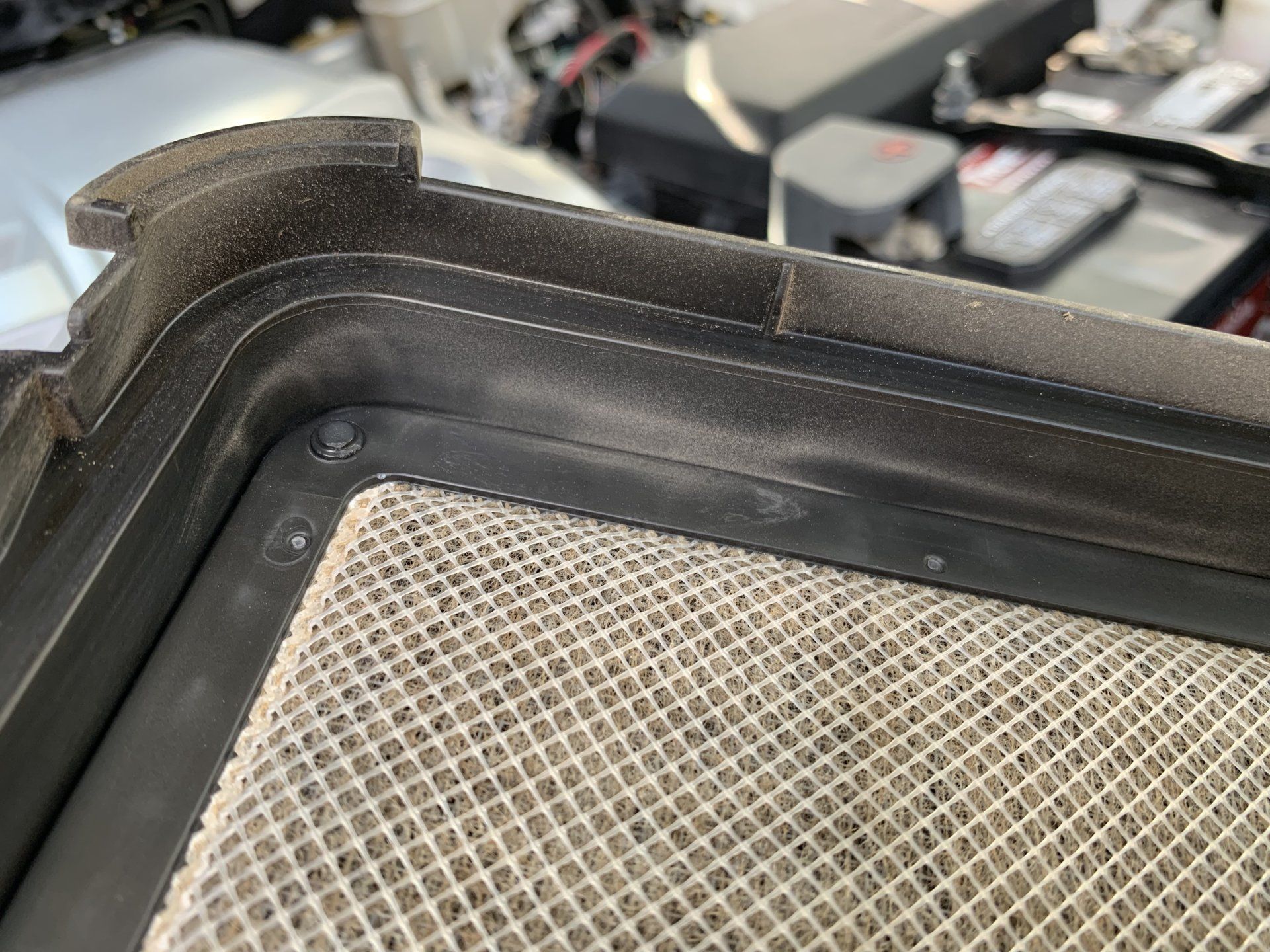

My rig got a new OE filter recently and I remembered watching a review of an Aussie VDJ200 where the owner mentioned the stock airboxes being bad about letting dirt bypass the filter. Wondering if this was a problem on the 3UR-FE I took a close look.. and didn’t like what I saw.
What you are looking at is the “clean” side of the upper airbox. The light material up against the corner is dirt that is presumably bypassing the filter and getting into the engine. This corner was the only spot with obvious dust on the clean side. I believe the crosshatch material is intended to smooth the airflow into the MAF sensor. And I doubt it is that brown from the factory. I haven’t done used oil analysis to see what the Si numbers are.. but from my diesel VW days I remember UOA being good at finding issues like this.
Always OEM filters. This one was about 20k miles, installed correctly, all clamps secured, and yes I made sure the rubber gasket was clipped onto the lip of the plastic filter housing. It can come loose if you aren’t careful.
When I put this filter on I was sure to clean up the upper airbox to make this a valid experiment.
Has anyone else had this issue? Can someone with a low-mile truck take a pic of their upper airbox mesh to show the color?
I’m considering a foam or rubber shim on the lower edge of the airbox gasket to put more pressure on the upper edge.
Thanks for any insight
I took my airbox apart today to clean the MAF sensor. The secondary filter is dirty, not quite as dirty as yours, but not the egg shell white like the other picture.
Is there a way to clean these?
Recommended fix? Just use the non-silicone filter lube?
I’m pretty sure I can get the evap filter out and back in without damage but can’t come up with a way to clean it that I’m sure won’t impact how it does it’s job.
I did get the filter grease but haven’t installed it yet.
A couple thousand miles on the new air filter before I got the grease installed. No new dust inside the air box.. maybe a fresh filter and associated gasket does a better job.
