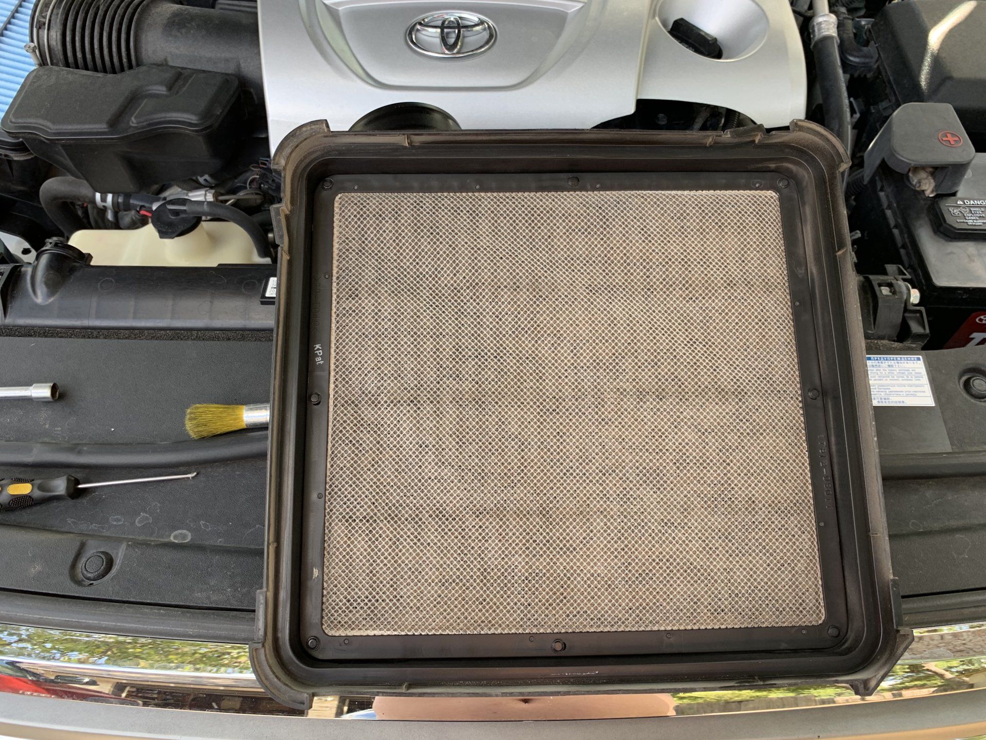

My rig got a new OE filter recently and I remembered watching a review of an Aussie VDJ200 where the owner mentioned the stock airboxes being bad about letting dirt bypass the filter. Wondering if this was a problem on the 3UR-FE I took a close look.. and didn’t like what I saw.
What you are looking at is the “clean” side of the upper airbox. The light material up against the corner is dirt that is presumably bypassing the filter and getting into the engine. This corner was the only spot with obvious dust on the clean side. I believe the crosshatch material is intended to smooth the airflow into the MAF sensor. And I doubt it is that brown from the factory. I haven’t done used oil analysis to see what the Si numbers are.. but from my diesel VW days I remember UOA being good at finding issues like this.
Always OEM filters. This one was about 20k miles, installed correctly, all clamps secured, and yes I made sure the rubber gasket was clipped onto the lip of the plastic filter housing. It can come loose if you aren’t careful.
When I put this filter on I was sure to clean up the upper airbox to make this a valid experiment.
Has anyone else had this issue? Can someone with a low-mile truck take a pic of their upper airbox mesh to show the color?
I’m considering a foam or rubber shim on the lower edge of the airbox gasket to put more pressure on the upper edge.
Thanks for any insight

The filter should not be that discolored if you recently changed it.
Mine is an egg shell white - no brownish discoloration like yours:
BTW, it is my understanding that no silicone products should be used in the air intake system because it could contaminate the MAF sensor. Although the possibility is, admittedly, slim, instead of silicone, I would recommend using a non-silicone grease like this offering from K&N to seal your OEM air filter:
HTH

For the record I don’t see any evidence of dust anywhere else in the intake stream.. whether the MAF housing or intake hose to the throttle body. I’m sure air velocity is much higher there which seems like it could prevent the dust sticking to those surfaces.
In the interest of public info.. stock US 2013 airbox part number is 17700-38182 and lists for $840. My price is about $550.. I think I’ll wait. I might see about removing the mesh and cleaning it.. but I doubt it’s causing any problems.

In that pic, probably only about 10,000 miles.
That mesh in the upper half of the air filter housing is NOT an air filter. It is a carbon filter to prevent fuel vapors from escaping the engine back into the atmosphere - obviously for when the engine is NOT running. It's an emissions filter. As such, it is permanently affixed to the upper housing and not removable without damaging either the filter or the housing.
HTH
HTH
It is attached with melted plastic tabs that could easily be removed and replaced with small screws if one were so inclined.. but if carbon can be damaged by washing with soap/water there wouldn’t be much use in removing it.
Anyone able to snap a pic of theirs with more substantial mileage on it? I’m curious what a 100k mile fuel vapor trap looks like other than mine.
