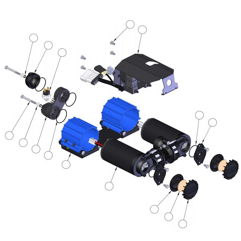

Another thing to pay attention to and modify is their odd round screw on air filters (for lack of better term).
They clog with dust and crap FAST. I got in habit of cleaning them when changing truck oil, as part of my maintenance routine.
Then i got tired of it and just rerouted them to the airbox, like you would a diff breather
Little black circles, about 3” diameter
Lower right corner of this diagram

I should read manuals more often.
Thanks!

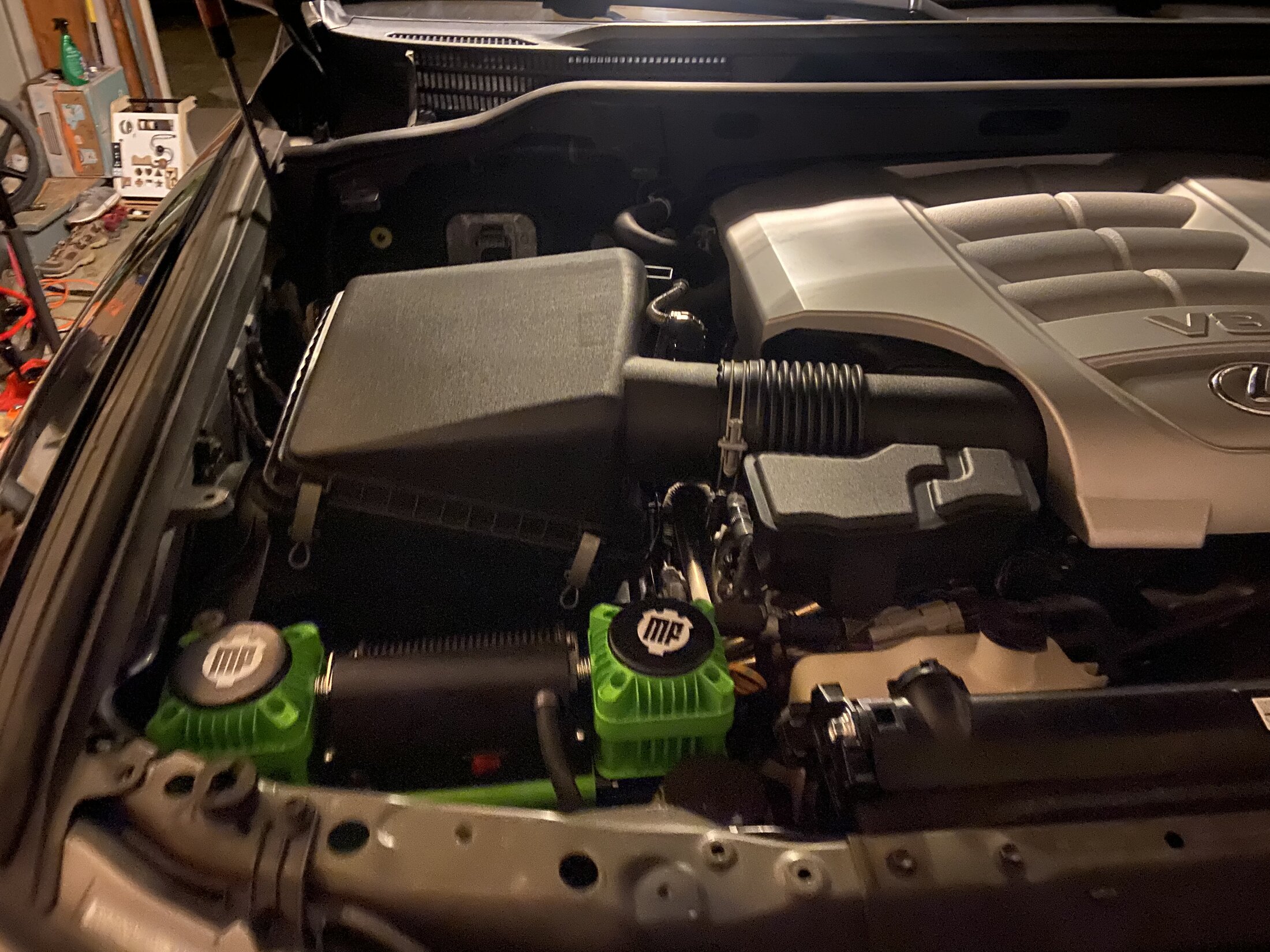

I have a morflate rubber mounted next to the power steering Resi.
It’s been in there for a few years now. We had our third child about 7 months ago so wheeling frequency is down. But all last year and the year before we were using the compressor 2-4 times every/every other weekend with their 4tire hose. And that’s all year round here in CO.
It has never skipped a beat. For the price expectation is 3-4 years of usage before failure/problems. I think I got it all on sale for BF for like $350 hose included.
The problem is their rubber hoses dry out quickly in the engine bay. I swapped to braided stainless and it seems to be sustaining the heat fine.

Damn. I was asking this very question about mounting my Thor's Lightning True Dual in the engine bay and no one had any experience mounting one but the consensus by a few was it wasn't a good idea. If you have have had success with it being there for a few years minus changing out the outlet hose to braided stainless, that's an easy fix.
