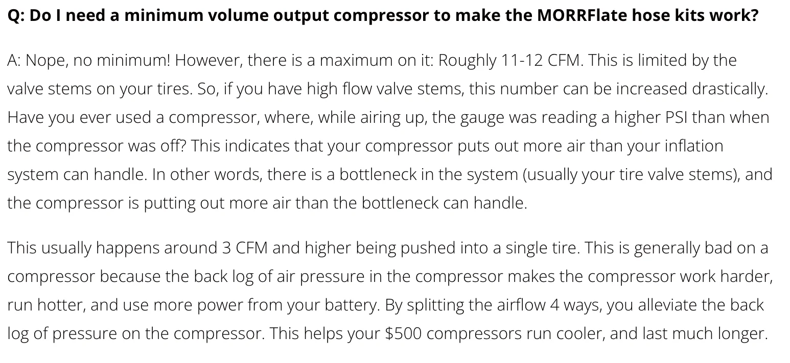

@linuxgod If you have a valve stem laying around, just turn your twin ARB on compare the output with and without the valve stem. The compressor will be more labored (drop in RPM) with the valve stem. Or, take two balloons and inflate them with your ARB until they pop. One with the valve stem in place and one without and measure the time. But as Adrenaline6 mentioned, the 10-35psi test would be most useful.
Additional info from Morrflate:
Oh yeah I’m sure there’s resistance
To be clear a bigger tires need less air. this is well documented on the net. and again I'm using a high flow chuck :cool:
If the wire gauge or connections are not correct the compressor is not going to run at it's peak.
I took the time to test all of this
I don't even us a gauge, I ran tests and I know that at a minute 40 seconds I'm good to go.
Street pressure on a 80 is 32psi and less on bigger tires.
My last post on the subject.
Cheers ;)

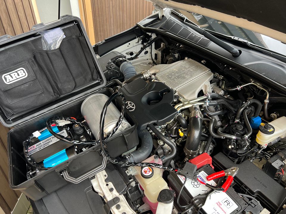

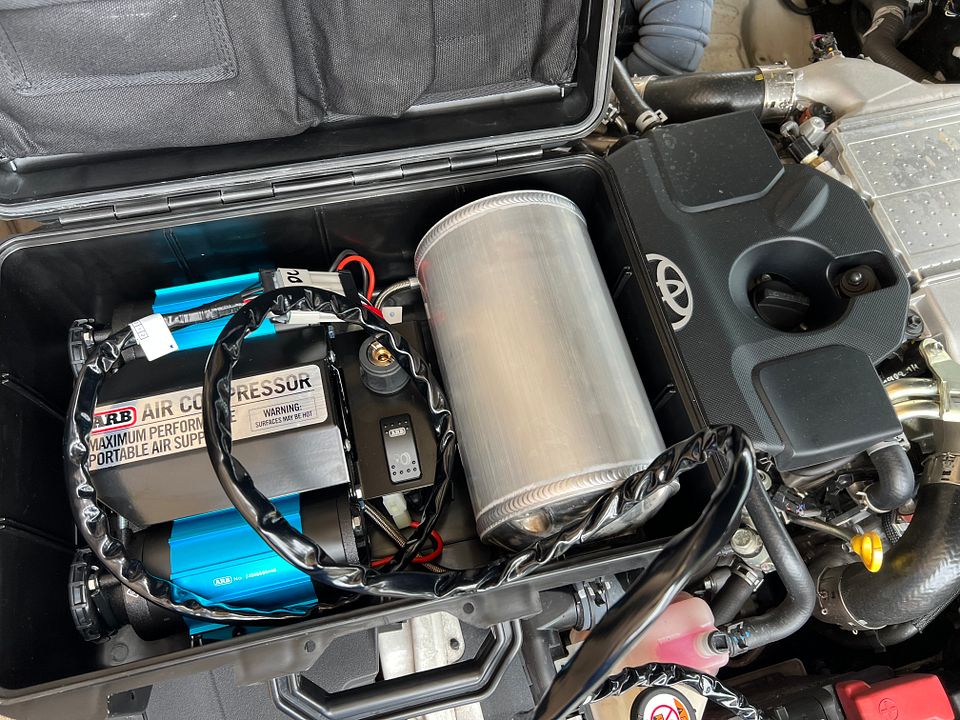

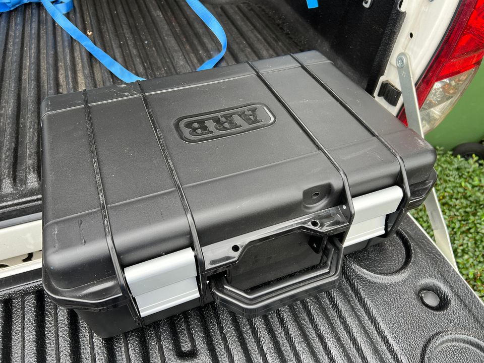

I bought the ARB Twin Motor Portable 12V Air Compressor Kit CKMTP12 last month.
I was thinking to buy the ARB Twin Motor Air Compressor and install it somewhere of the car, looking the best place of my Hilux to put it and everything that the installation requires, but I have to accept, that I don´t have the enough time to really enjoy my car as I would like to enjoy it.
For that reason I decided to buy this portable ARB Air-Compressor Kit/Pack, If you think that you need it, just take the Box and drop it somewhere of the car.
The all Package is really well done, not fancy, not crappy, let say functional.
The Harness is enough long to put the Box on the floor and connect it with the 12v Battery, the air Hose is enough long to inflate all the tyres, but you have to buy the inflator (not included in the Kit 😑)
I think it is a valid option for those of us who need a compressor in some sporadic situation or occasional off-road trip.
