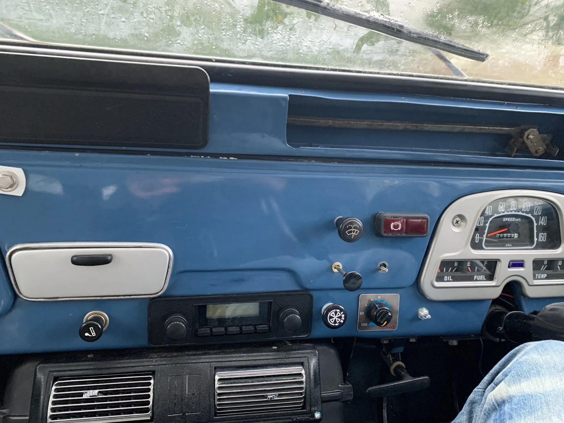

Pulling faulty hazard switch I found a few issues:
  • Dash panel has extra detail, above stereo, as per 60's dash but doesn't have the horizontal detailing higher up. It this a mix of various vintages?
  • Cluster is gen4 so post '79
  • Wiring isn't stock, hazard switch has three connections

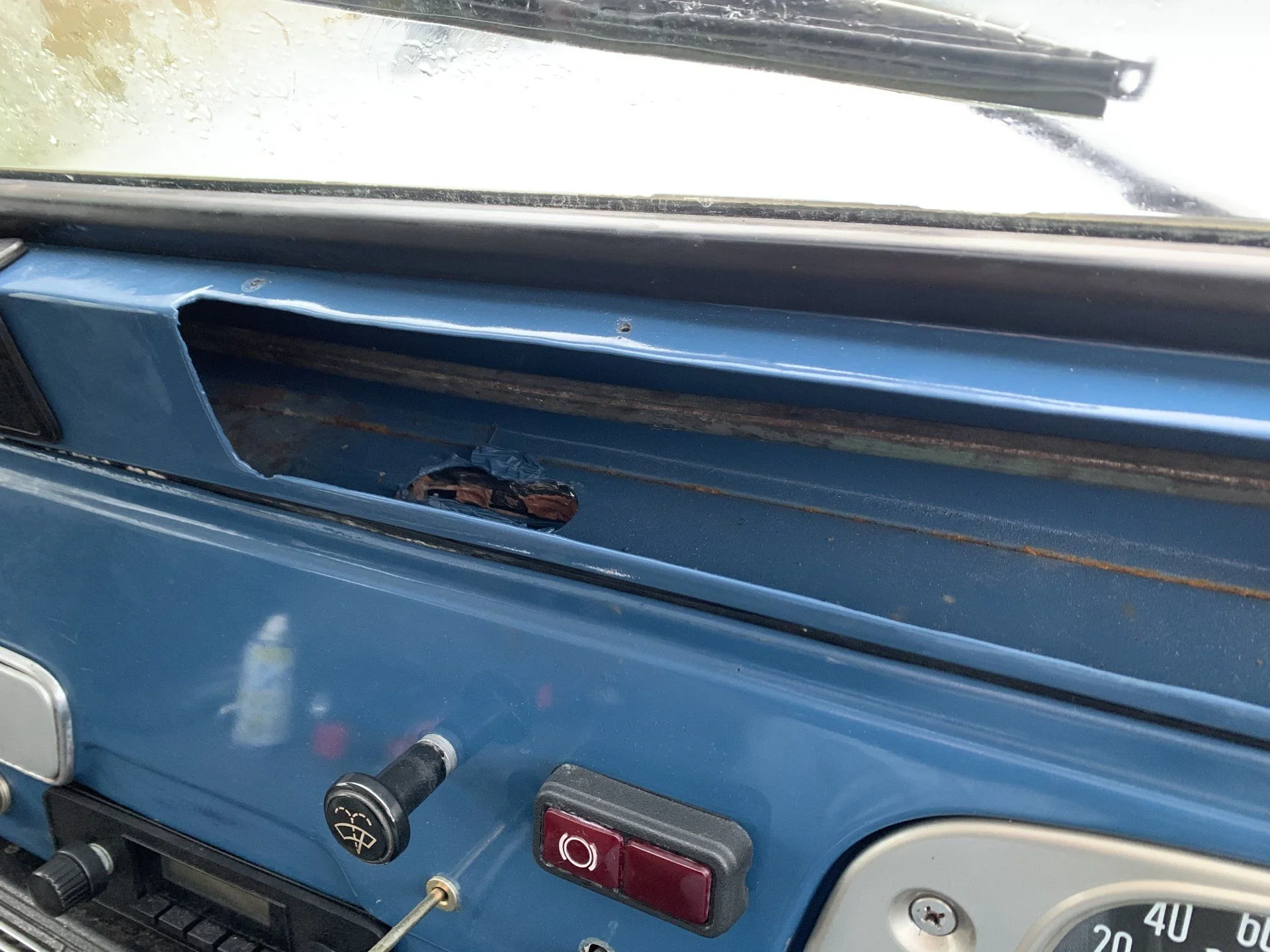

  • Defrosters vents and guides have been butchered, vents are simply flat plastic panels and the guides are non existent. Air finds its way from the heater via piping through a rough hole in the box section housing the wipers.
Can anyone shed any light on any of this? Were defroster vents simply not added to trucks for the tropics? I also have the vent on the scuttle panel that is now blocked up.

The plastic vents look normal but the hole cut in the top of dash is not. The dash does look different. Maybe a newer style tub or at least dash has been put on, from a country without heaters..

No a private seller. I found Indonesian coins under the seats which was a give away. I had a quick look at the vents on mine and it has the long oval factory cut outs fitted with inserts. It had been fitted with AC which is now missing so I think I'm going down the Vintage Air route to the provide warm and cool air. I will add a photo so you can see what the vents look like .
