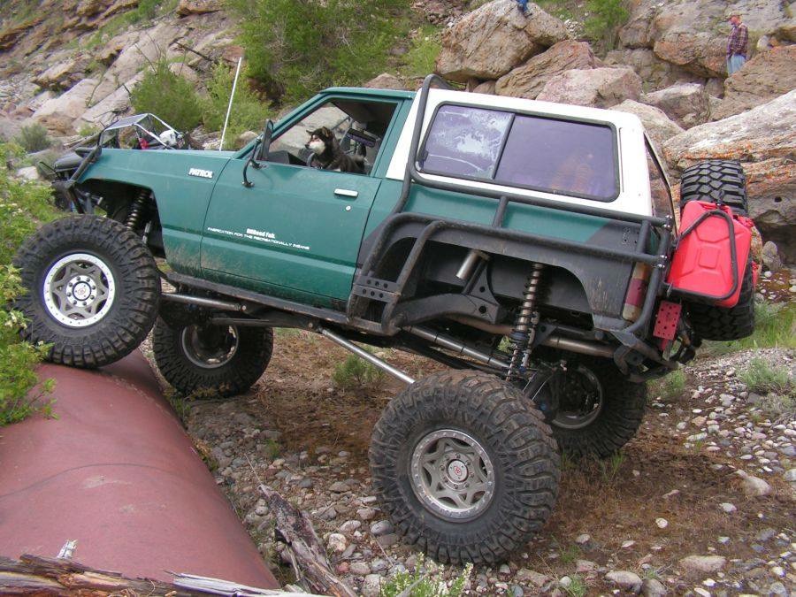

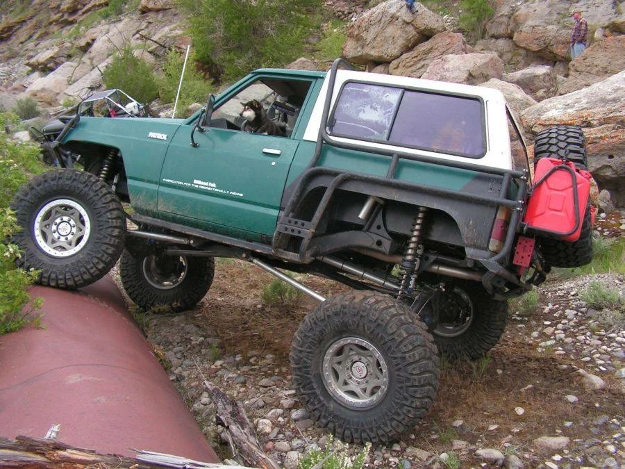

A case for leaf springs....
Justin Reece is a long time rock crawler turned desert racer in 2009 when he raced his 1977 FJ40 to a 35th place finish at KOH to become the first full frame full body to finish KOH. He codrove Mike Klensin 4431 car from 2010-2015 with a 9th over all in unlimited. Justin built the 4619 car in 2013 to get back to his wheeling roots. He has gone on to be the most winning Toyota in Ultra4 history with several podium finishes including 1st place in 2019 and 2021 at King of the Hammers and 1st at Beat Down at BFE Moab in 2021. He manages RustyNailRacing in Ridgway Colorado and is a Battalion Chief for the USFS in Western Colorado.
So what is this 4619 car??? Yep, SOA Toyota truck, 150hp 22RE, stock transmission with marlin crawler and D300. Obviously it's built with nice parts, purpose built and Justin is a hell of a driver.
fb_img_1550288802632-jpg.1905600
I would go this route if I were building a rock basher for sure. Simple, tried and true.

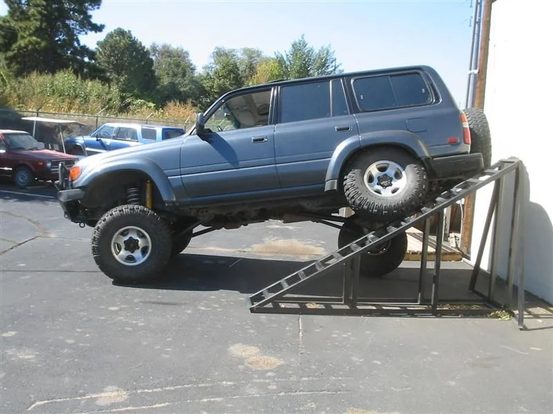

Plenty of flex for all except for extreme trails...body damage will happen lol. This was my 80 on 35's, about 15 years ago. Suspension options have come a long ways since 2006.
