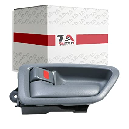

Has anyone done an interior rear door release? I might be using the rear of my GX for a sleep area and would like to have a way to open the rear door.
Here is the Prado 120 rear door, might be able retrofit their release to work;
that would be great, any ideas of where I can get the parts?
Hmm not sure on that, maybe try to contact an overseas Toyota and see if they can ship you the parts. Or try to find someone on PradoPoint to help you out.

I looked into it real quickly and I think the entire back door trim panel is different, so you would need to swap that out. Then there is the handle and the trim around the handle, and probably some cable to connect it to the latch.
agree, it might not be cost effective.

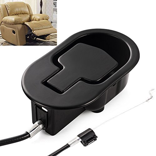

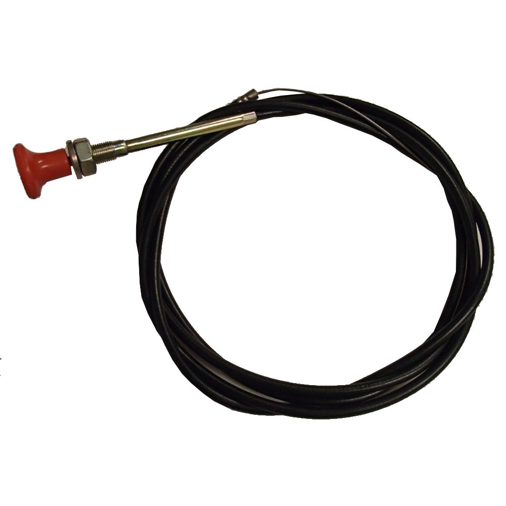

I wonder for any of you that have already done it, how much space is in between the rear door molding? would something like this flush mounted pull handle fit? or the second link a pull knob + cable? (with these bike cable type cables it would reduce the friction of an open cable rubbing against metal drilled holes.
1. https://www.amazon.com/FOLAI-Recliner-Replacement-Parts-Universal/dp/B01KXIUX2S?tag=ihco-20
2. https://www.amazon.com/47V1534-Universal-Round-Handle-Cable/dp/B07BBVYB7D?tag=ihco-20
I'm sure that second link with the pull knob would fit, but not sure about the components of the flush mounted handle......or a junk yard internal Toyota door release.....to make it look like a factory piece???
I did mine a bit ago do this is from memory, but I believe the sheet metal is about 1/2" away from the plastic covering. You'd likely have to cut sheet metal to instal one of those flush mount handles.
The other issue would be the orientation the cable is pulled at. Unless a guide (sleeve or pulley maybe..?) was used, the cable has to be pulled straight up. Meaning the linked recliner chair part mounted from the 12 o'clock to 6 o'clock position might work. If so, that would be pretty sweet!
I might just pick one up and see what I can come up with.
