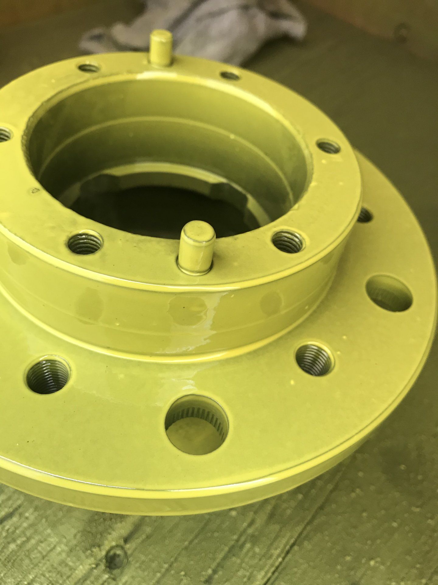

I have some IFS hubs for the FROR tundra brake upgrade and I bought all new studs to install. They are not like knuckle studs that have the torx head for installation.
What is the correct procedure for install? Just enough torque to bottom them out using two nuts? Using blue loctite in addition?

No, the studs that are on the end of the wheel hub. The manual locking hubs go over these studs.
are you referring to the studs on the outer diameter of this photo or on the inner diameter of this photo?
Double nut, blue loc-tite is never a bad addition. Go until the threads end and snug it down. Somewhere someone has posted the torque specs that the manual calls out for each bolt size...I usually go by that/feel.
I’ve never seen a good answer to this. I blue Loctite and double nut to feel.
Do your new studs have an equal amount of thread from the center? All the OEM looking studs I’ve removed have a long side & short side and the long side is always in the hub. The after market studs have the torx head on the long side.

I am talking about the small inner ones. Not the outer ones.
Gotcha. My experience with any true thread in stud is that they bottom out or they run out of threads. No need to go hog wild with tightening them. make sure the studs and holes are clean and dry or else the loctite wont work. Apply the blue loctite and wind the studs in until they stop turning...give them a slight elbow torque and should be good. also there are some stud sockets that can make install and removal very handy. the ones I like have 3 rollers inside that ramp tight around the stud and make it easy to install or remove without damaging the surface or threads. something like this:

The force on those studs is lateral shear. It doesn't matter how tight they're screwed in just so long as they bottom out. They're not going to unscrew while driving because of the cap nuts.
Double-nut and tighten. A small drop of blue or purple or any low/medium-strength locker can't hurt, but if the OEM ones you've ordered don't have it on the threads, it's prolly not needed. I use anti-seize and I've never had one loosen.
Those Stud-lug sockets bugger threads.
When you get the old studs out it might be a good idea to run a tap through the original holes just to make sure everything is clean in there before you reassemble.
The IFS hubs came off a 2WD 4Runner so there were no studs. There was a cap over the hub instead of a manual hub and this cap was held on by bolts. I just finished painting the whole hub so I will definitely be chasing the holes before installing the studs.
Bare, bead blasted with some sort of aluminum media, yellow epoxy primer, final grey urethane epoxy top coat. Total paint thickness around .004"

the internal threads. Locktite doesn't work as well in a oily hole. @Randy88FJ62 shows a good example of a hub clean and
ready to reassemble .
