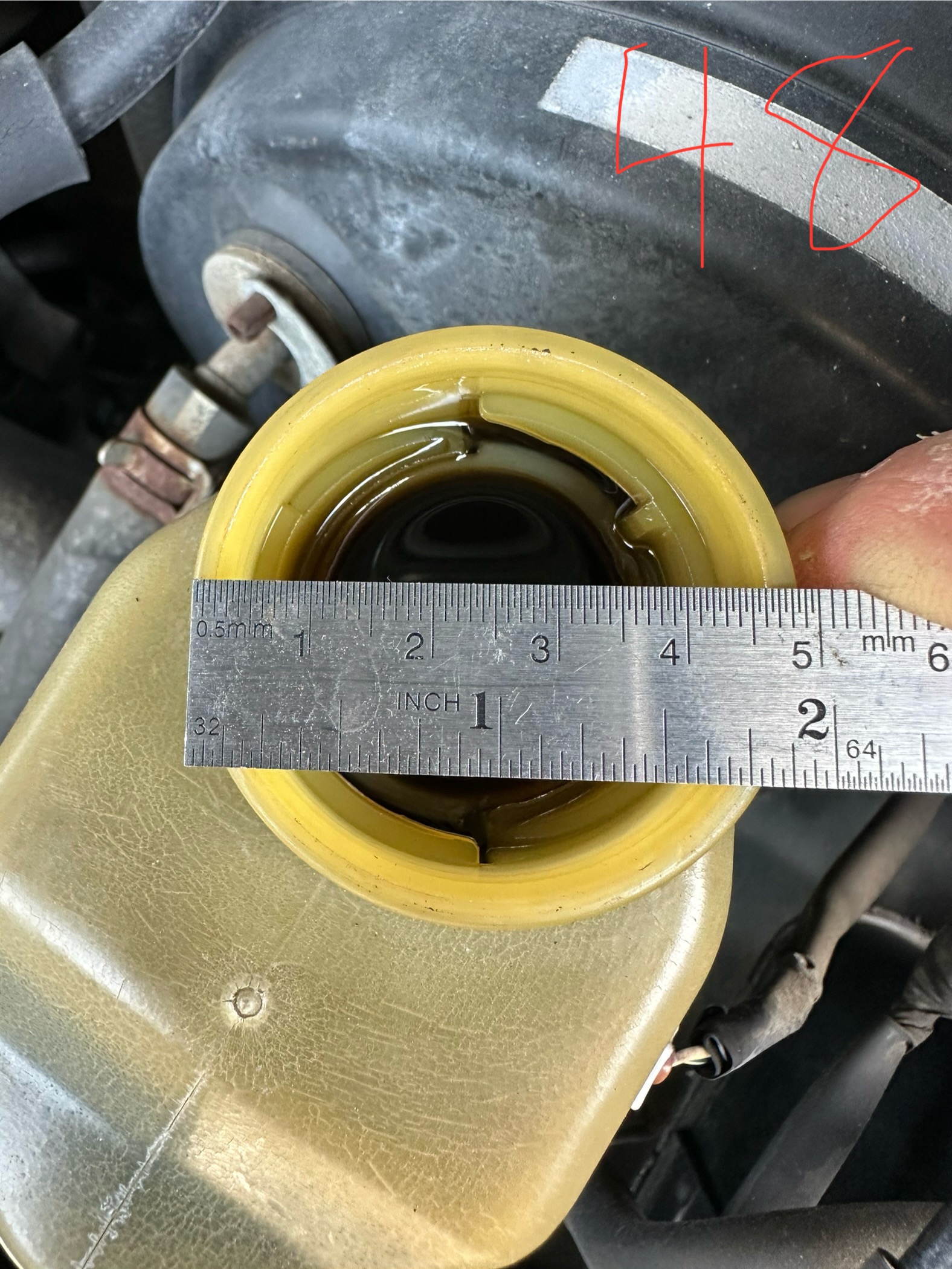

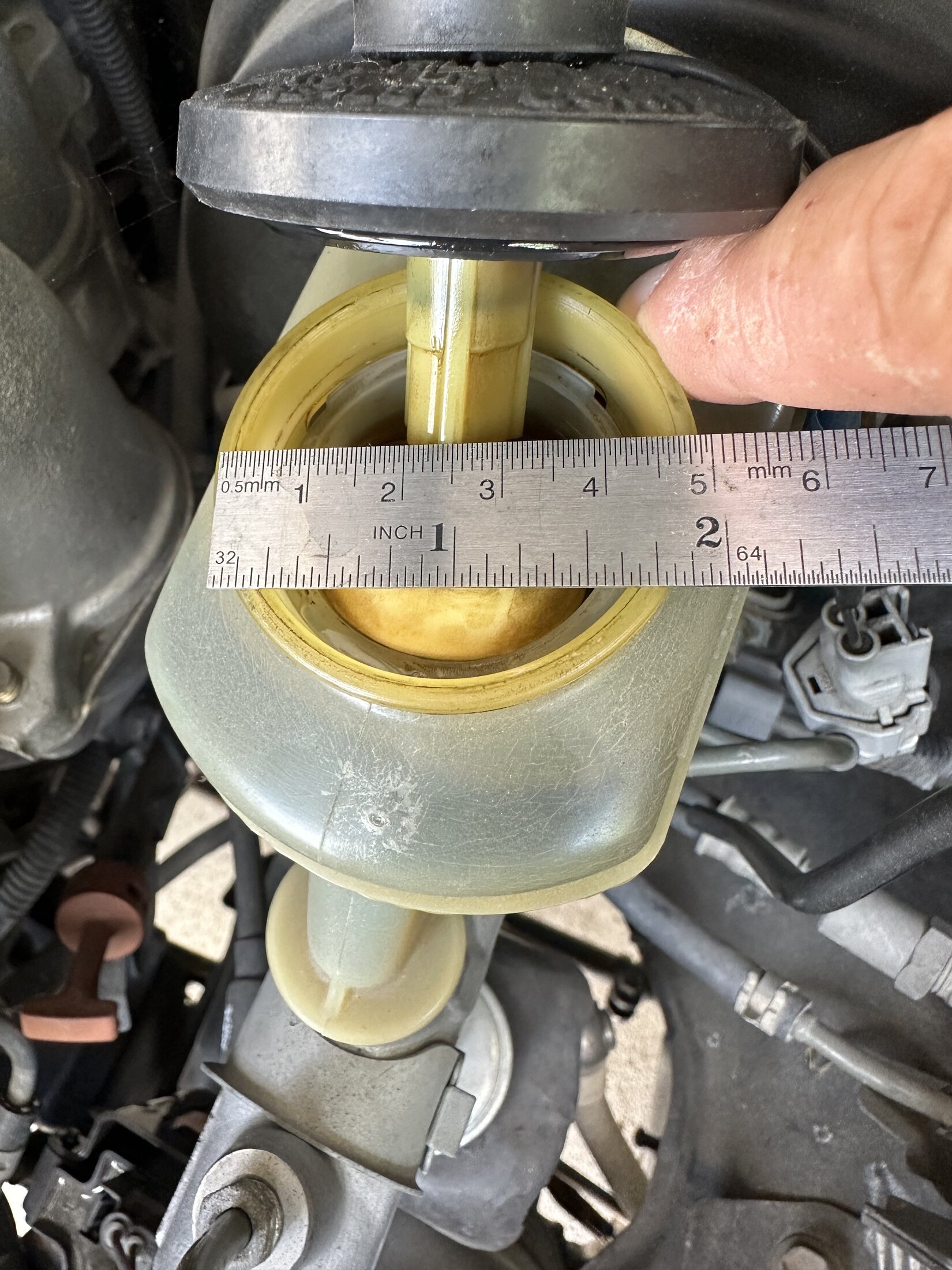

hey! trying it to rely on you guys for everything but it's tricky first time with this.
i have a LC and an old tacoma.
it looks to me like if i measure outside to outside it is like 50mm on the LC MC? or if i go inside to inside (?) it's like 46mm?
then on the tacoma - well it's about the same.
50mm is 1.96" but that adapter seems like it fits smaller than the OD at least?
is there a way to be sure it fits aside from actually fitting it?
The BA10 adapter fits correctly on the OEM (size) FZJ80 Master cylinder (OD under the lip is ~1.85" or ~47mm).
If any doubt call the company that manufactures the BA10 to ask, but IME and that of others, the BA10 is the correct part.
Ask them about the quick connector part also, I forget but IIRC a separate company may make that, the advantage is that
it is known to fit the BA10 snugly without leaks so you don't have to try something else that might fit, or not.
