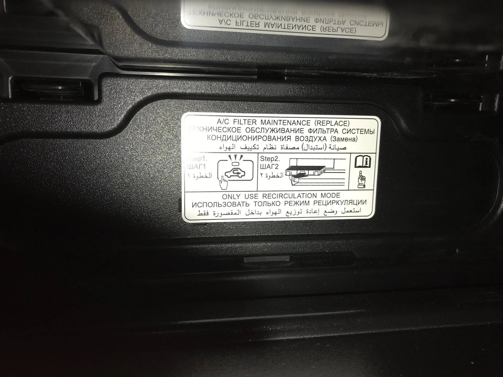

My door is fine. I put the label on the access hatch. Good idea.

I checked my 2016 this afternoon and it came with a label from the factory.

Note the (3) label positioning marks on the door!
Mine did go through GST. My guess is that the label was done at the factory because of the multiple languages. If done at GST, I would think it would be English only.

If we can't order the label, would someone with the label take a pic straight on without flash and post it? It could be saved, cropped, printed, and attached under packing tape (very shade tree I know). That said, I'm locking the glove box from now on.
Why not just write it on there yourself with a silver Sharpie? There is no reason to have a factory sticker there. The access plate comes out in seconds with no tools.
Or you can just type and print the words yourself, there is no need for an image.
If it were a sticker that was visible on a visor or elsewhere, sure, factory stickers are very desirable because they look, well “factory”.

The label indicates to me that Toyota woke up to the fact that the damper doors were being damaged.
