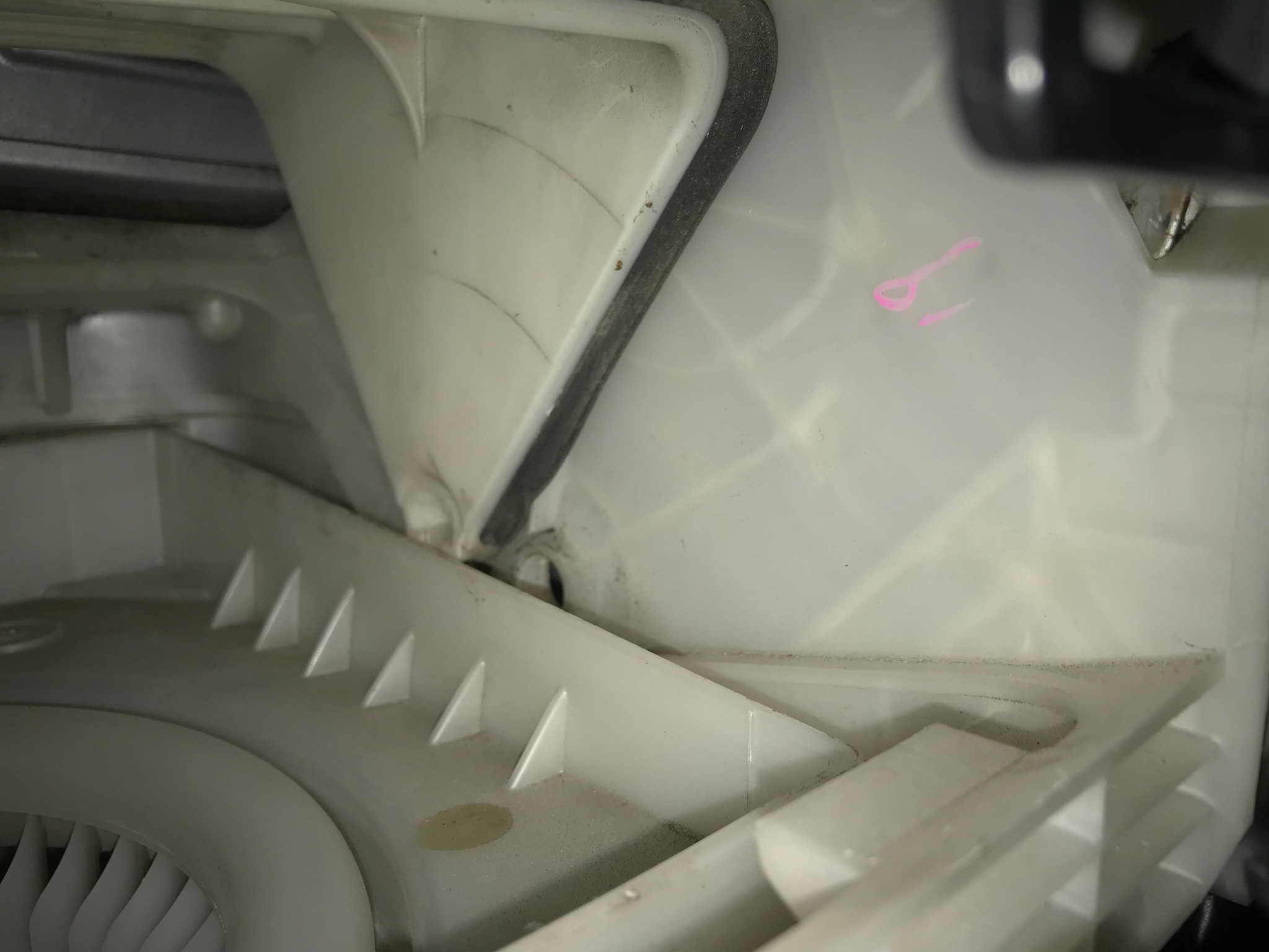

Damper does not move, but I can hear the actuator trying. Manually lifted the damper, and it has a huge crack in the right side.

Yes, the pin/lever is attached to a servo goes through the housing into the door. That's the only part that moves the door. You can pull apart your glove box area and see if the pin just popped out. I can't tell from the pics if the door is actually cracked.

Yeah, your door is super hosed. You can probably fix it with some strategic glue placement though. Pull apart the glove box area and give it a go. There isn't much force on the pin/door so only a little bit of adhesive can hold it together.
Door is intact - maybe there is hope...
