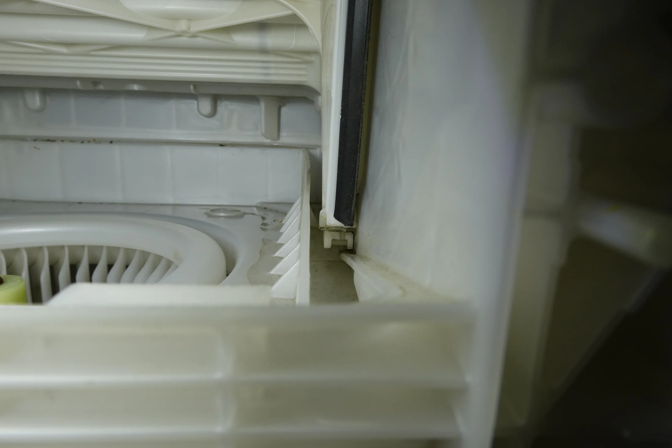

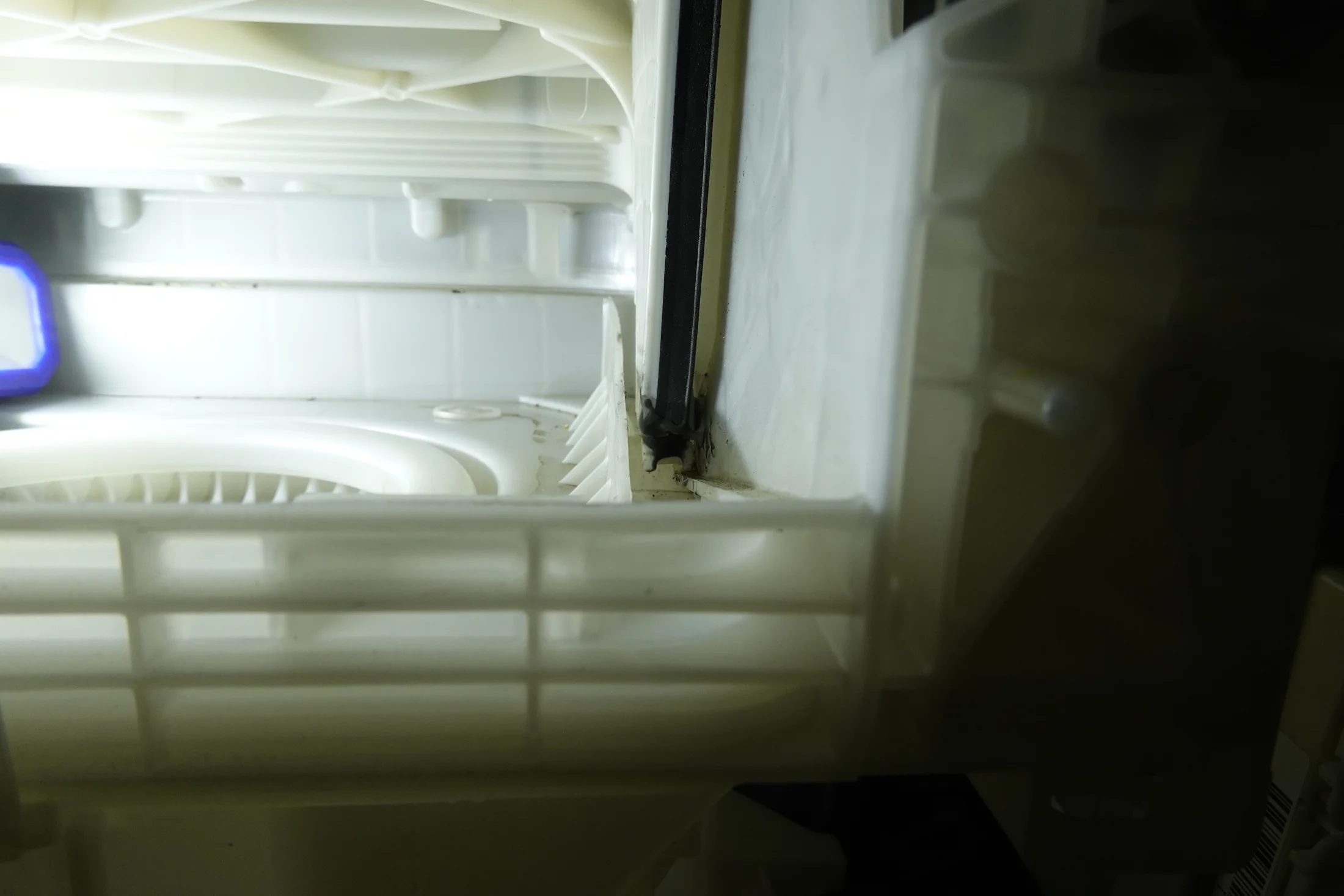

My LC's recirc door was broken by a shop monkey about this time last year. I was able to disassemble the dash enough to gain access and was able to use JB Plastic Weld on the broken pivot. Not very neat but it is still working.
Broken part of the door.
Broken piece.
Repair is sloppy as I caked on the plastic weld, making sure it was all over the pivot and recirc door. Not easy to keep the stuff out of the housing pivot hole, but I did. Used a long, thin flat-head screw driver to reach back there to apply the weld.

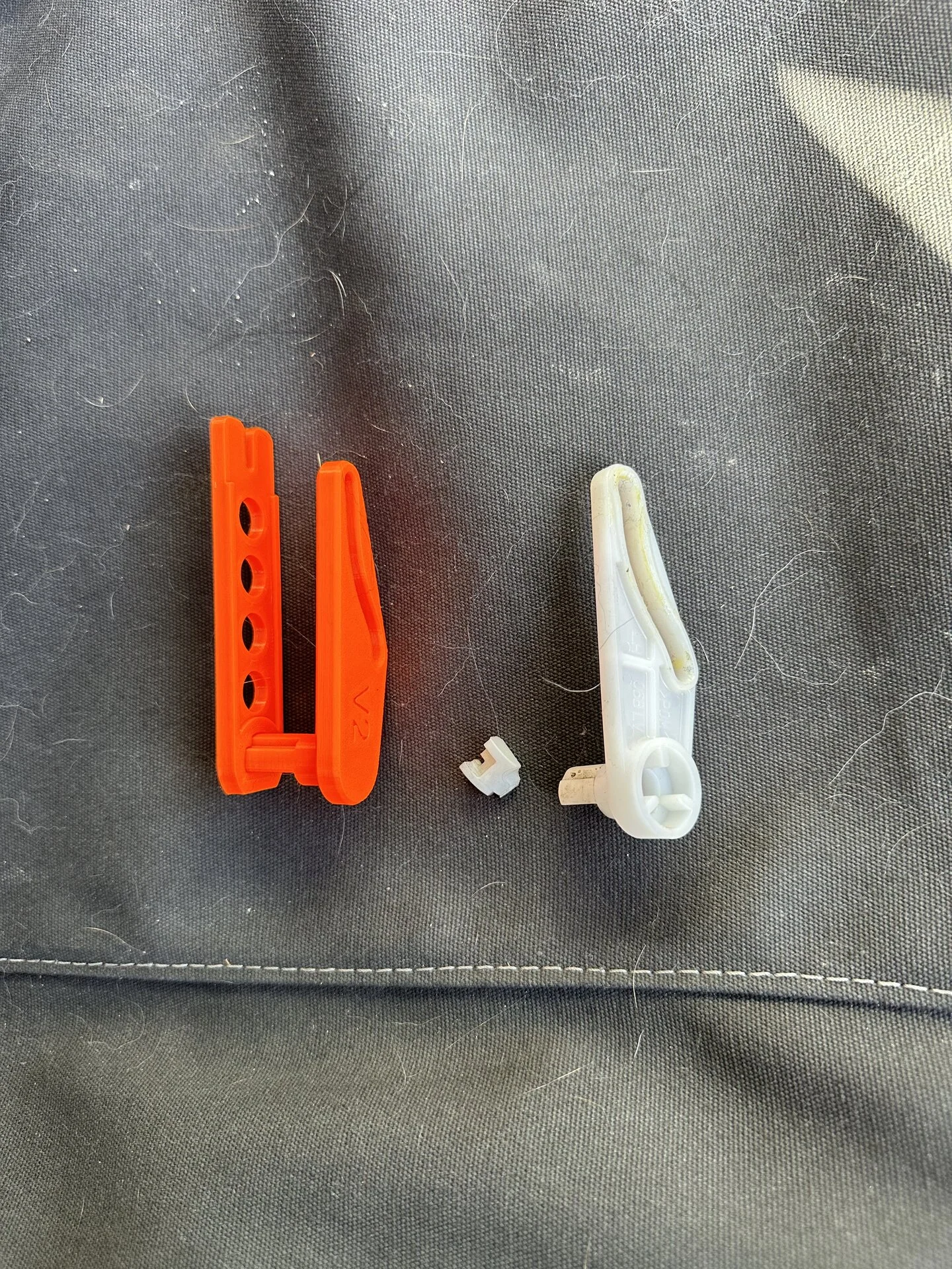

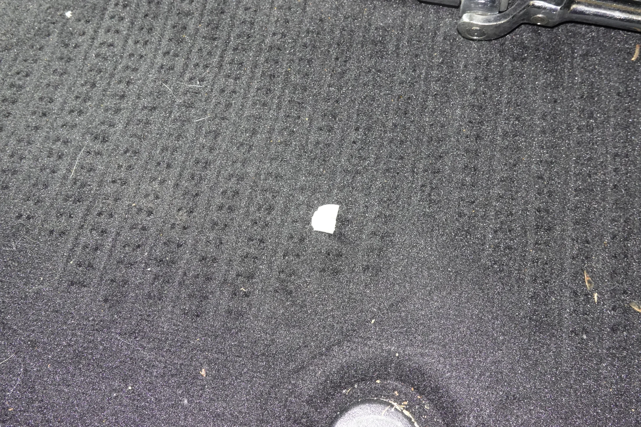

2020 Heritage with inoperative recirc. Grateful for this thread. See first two photos, I dropped the lower kick plate beneath the airbag and found this broken bugger floating around on the kickplate. Can anyone confirm - is this broken piece the “servo motor actuator arm” that @Oakleyguy refers to? The hinge appears intact; the flap manually opens and closes by moving the presently attached arm - although it does not appear connected to the servo motor. The servo motor sounds fine - ie. it makes noise when I press recirc on the dash. Is this broken part available for sale alone? What exactly is this part called? Any advice greatly appreciated.
From your photos, what is broken is the actuator arm off the servo motor itself. The pin fits into a slot on the re-cerc air dam operating lever.

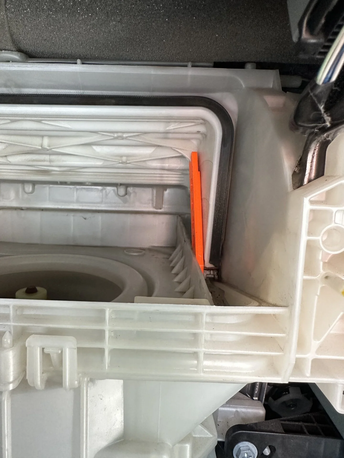

From this picture, you can see the part that you found - the white part attached to the orange repair from Oakleyguy. The pin on the part in your picture fits into a slot on the orange lever. This picture is where the air dam door is set to re-cerc.
Another picture with the air dam in the fresh air position.
The part in your picture is what is on the servo motor and I do not know if there is a repair for that without having to remove the entire system. Sorry.
A view from the other side.
