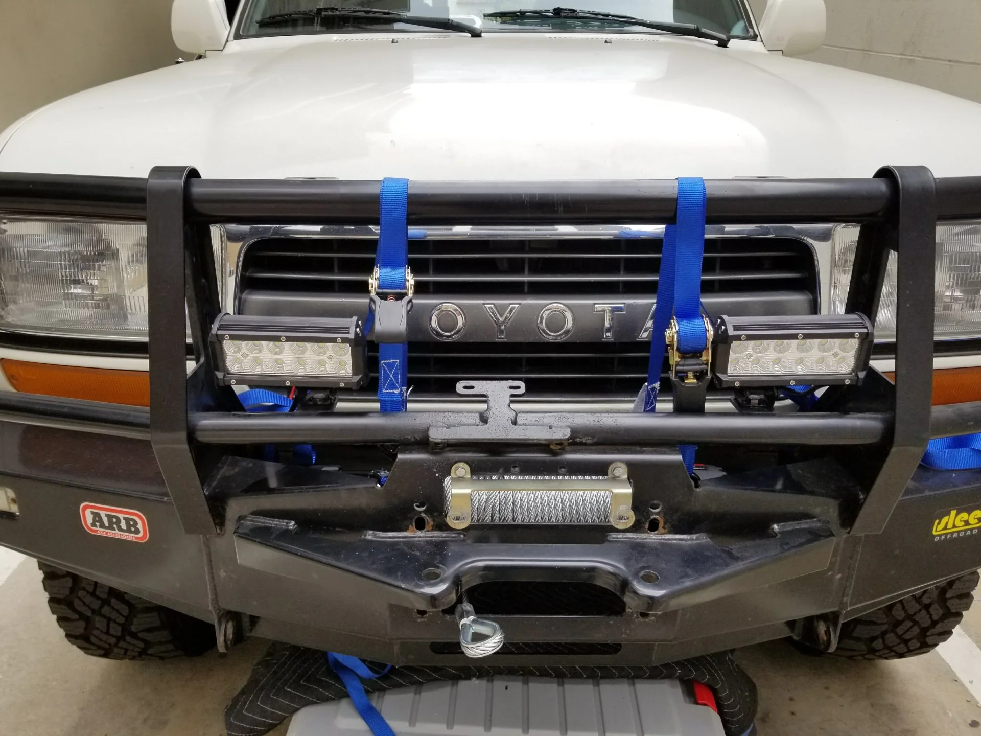

Use the ratchet straps. No need to remove bumper. I bench pressed it into place a couple times to see if my wife could just start the bolts. Bad idea. Dont drop winches on your chest/face. Use ratchet straps.
