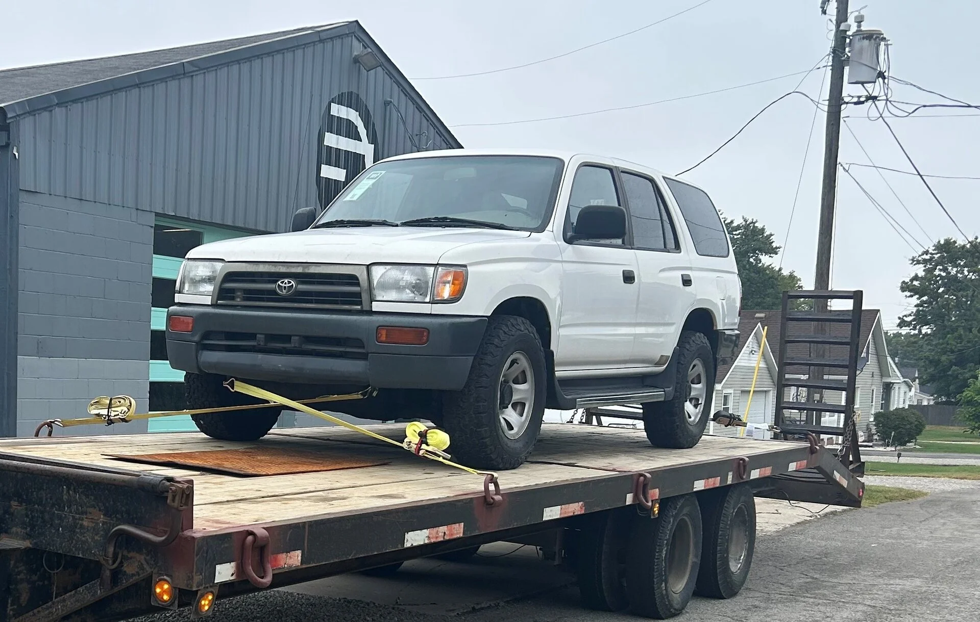

Picked up this '97 Base 2WD to be our eldest son's first vehicle. Super clean one owner out of Arizona, 214K on the ticker. Going to go through all the mechanical stuff slowly with him to get some sweat equity in it. We have a few months before he gets his permit.
The one thing I really want to do is the headlights. Researching on here and the net, it looks like there are several options out there for full housing replacements ranging in cost from "okay" to "holy sh!t".
