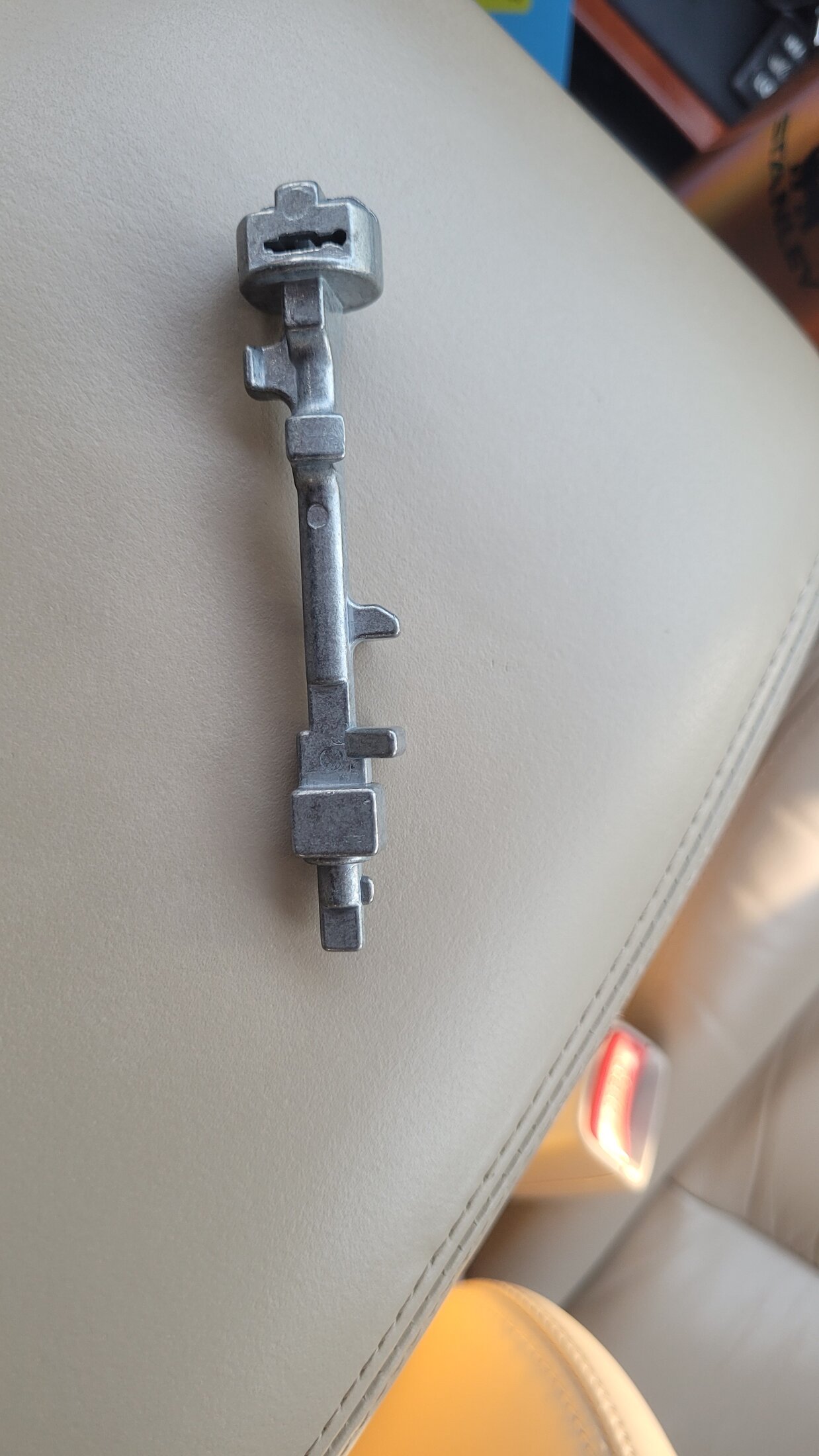

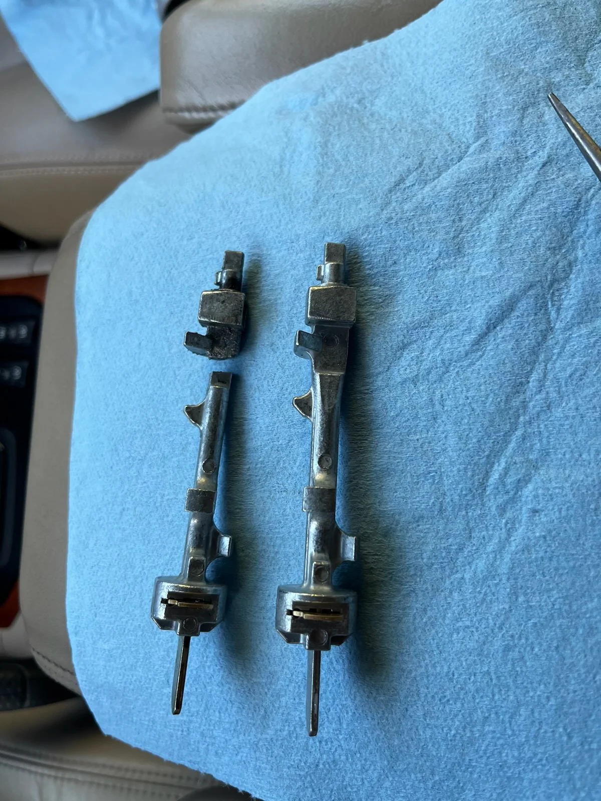

Here's a comparison of the OEM old v new. Part #45280-60510 which is the "bracket assembly". You could replace the entire bracket, but I believe it is easier to remove the ignition rod from the new assembly.
On sale now for a sweet $236. Gracious

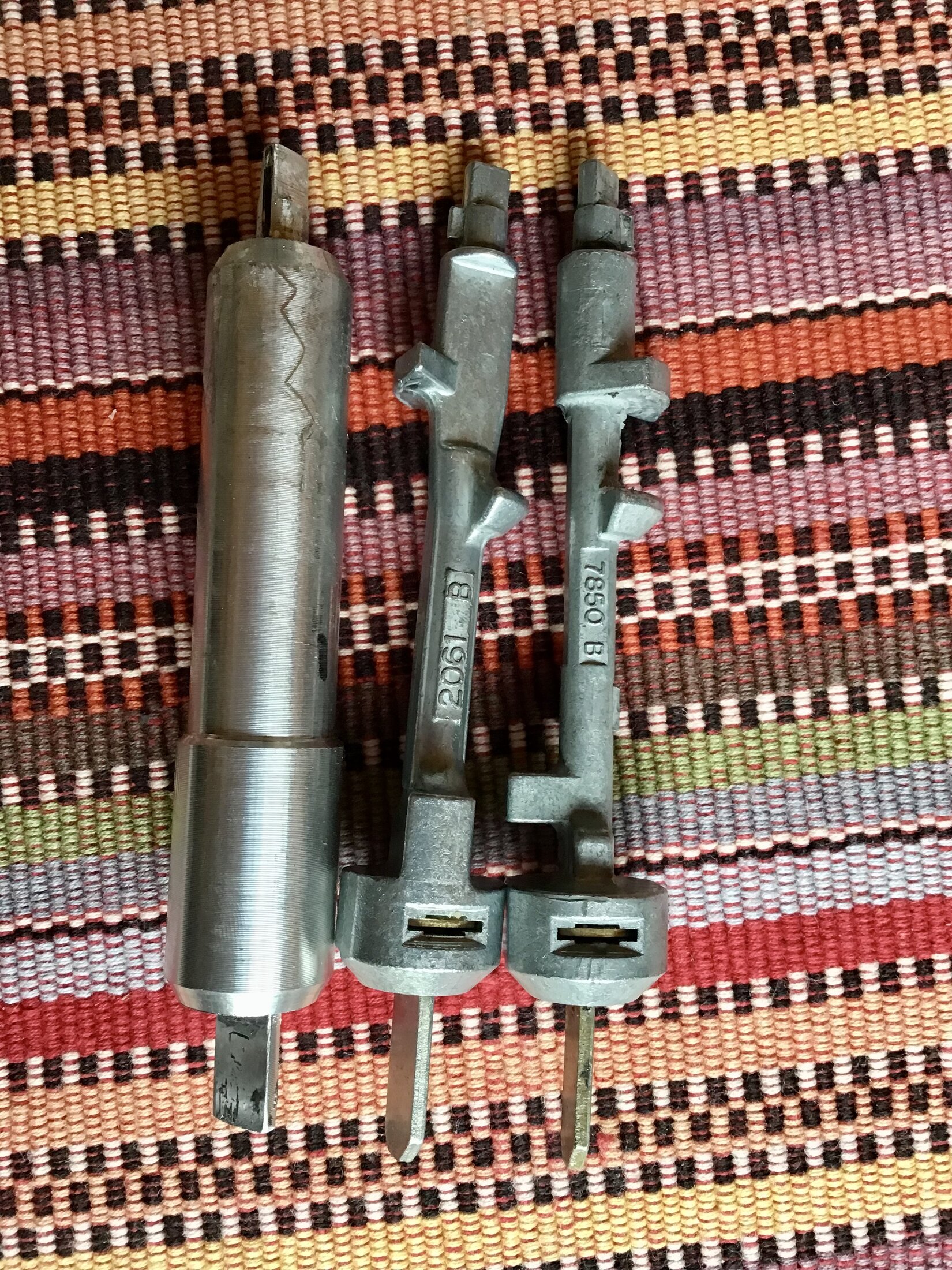

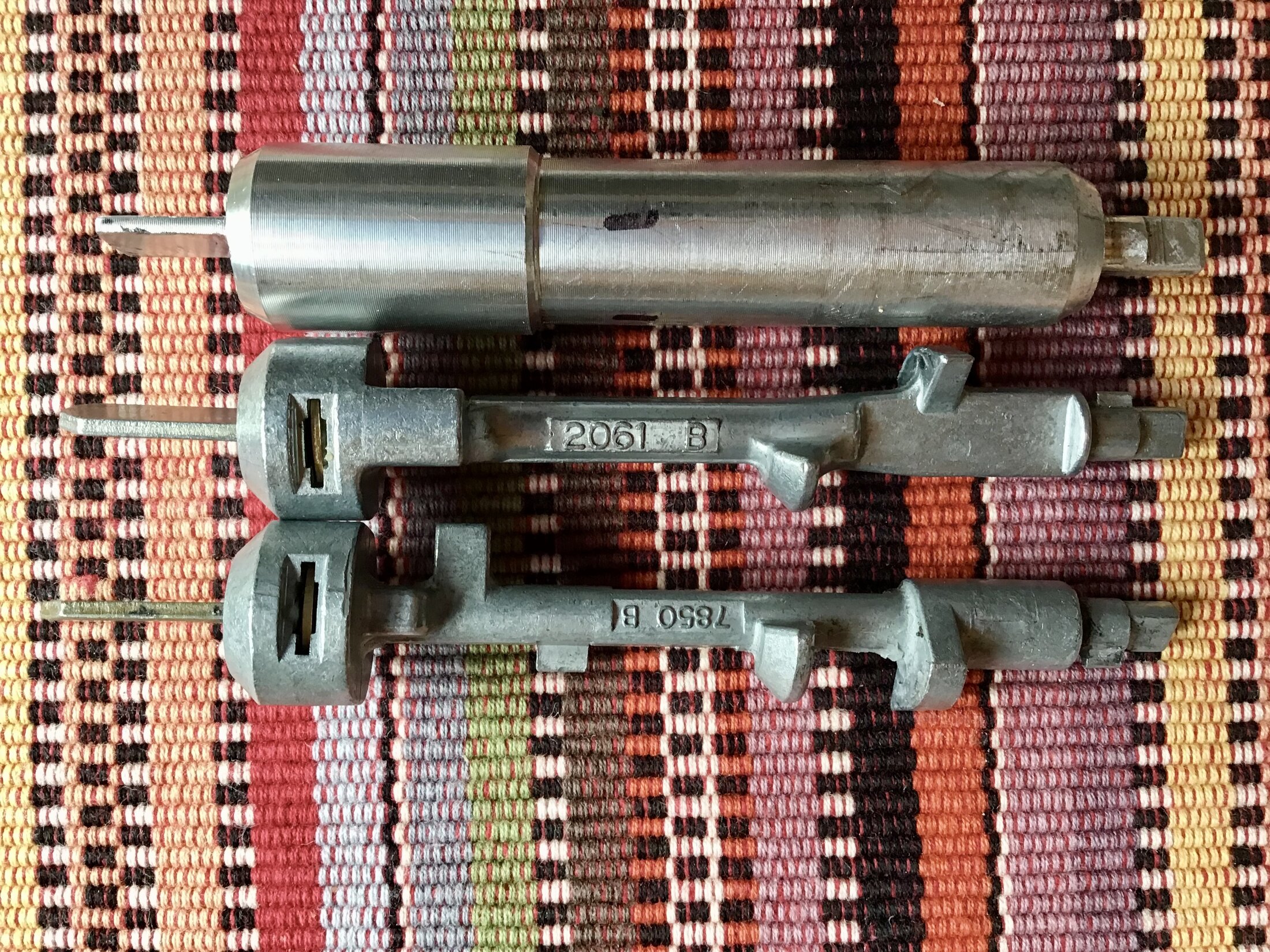

I made an aluminum chubby that I can use in an emergency since it just drops in. I made this for my 2005 LX.
It must be like what CreakyCruiser said a Dutch guy made. If you look through that old long thread you will see that I posted this in 2022.
Remember that the Tang on the end is 90 degrees rotated from the early rod used up to 2003
Very similar to the Dutch guy’s except yours is even beefier, wow! I want one.
