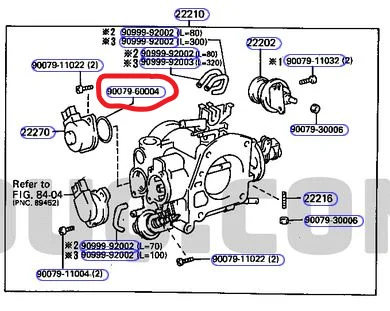

IIRC the O-ring (90079-60004) does not come with an OEM IAC (22270-66011), you have to order that separately. IME sometimes
aftermarket part come with the gasket or O-ring when Toyota you have to order it as a separate part.
Example: a Toyota water pump comes just with the water pump but the studs for the pulley and fan are already installed. The identical AISIN aftermarket waterpump comes with the studs unattached in the box along with the metal gasket.
FWIW
