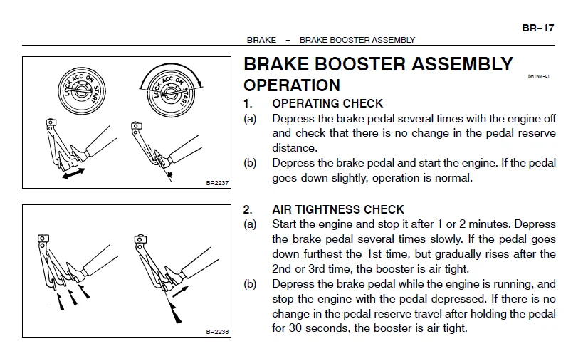

Brake Boosters can fail, but go through the FSM diagnosis check for it but it is more than likely a M/C issue..

Here is the FSM booster test...

Replace brake booster if pedal still slowly goes to the floor. Can often hear a hissing sound under dash or by booster of air.

2) A bad booster gives you a hard pedal, not a soft pedal. It's probably not that.

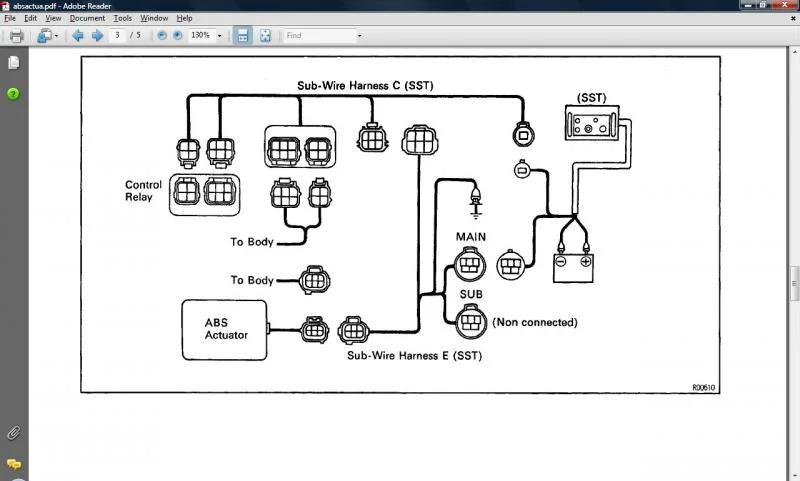

Activate the ABS and bleed the system. I’ve lived with spongey brakes since the beginning and replaced everything over the years and the only thing that fixed it right away was activating the ABS and pressure bleeding. I wish I started with this first.
