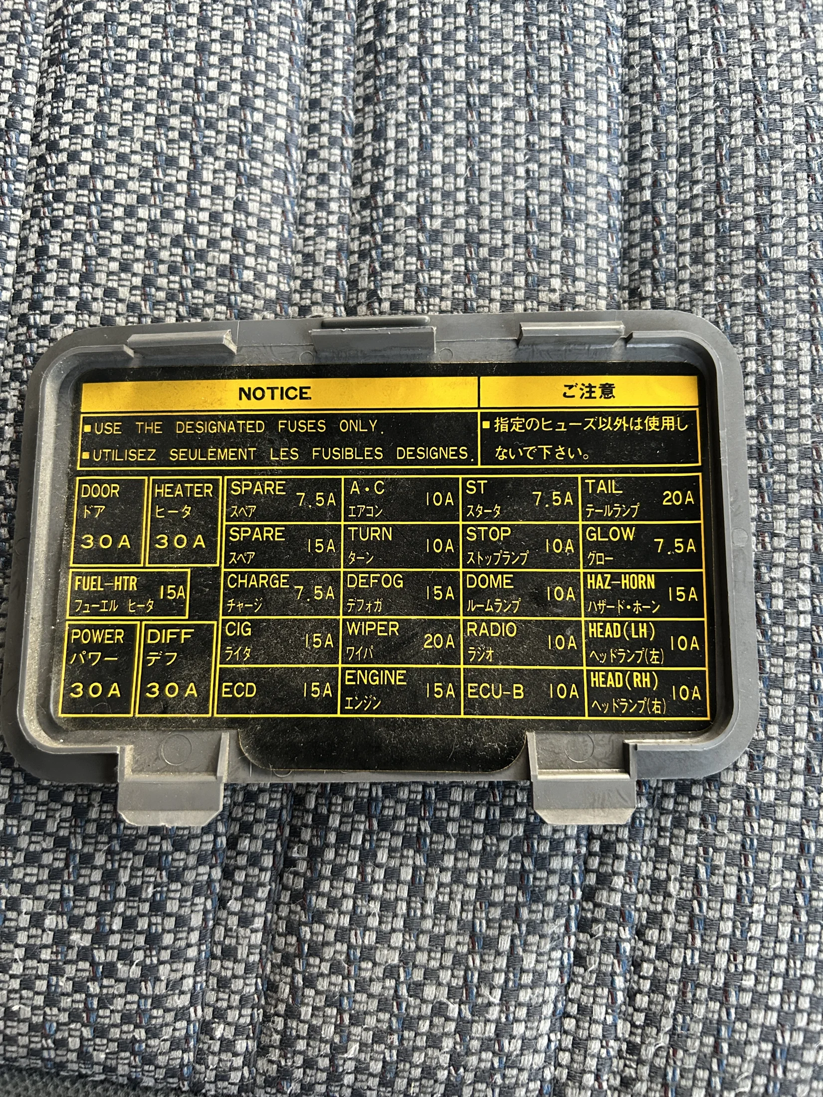

I have what appears to be a wiring issue behind my gauge cluster, actively trying to melt my instrument panel.
Anyone know what fuse will disable power to my gauge cluster? Stuck in a parking lot without tools, trying to get this thing home.
Hello,
There is no fuse for the gauge cluster. There are fuses for each circuit.
Your cluster gauge ground is failing.
There are several connectors in the gauge cluster. Two of them are bigger than the others. Both have a ground pin, number 2 from right to left if I remember correctly.
Juan
EDIT: it is right to left in gauge cluster connectors, not the other way around.
