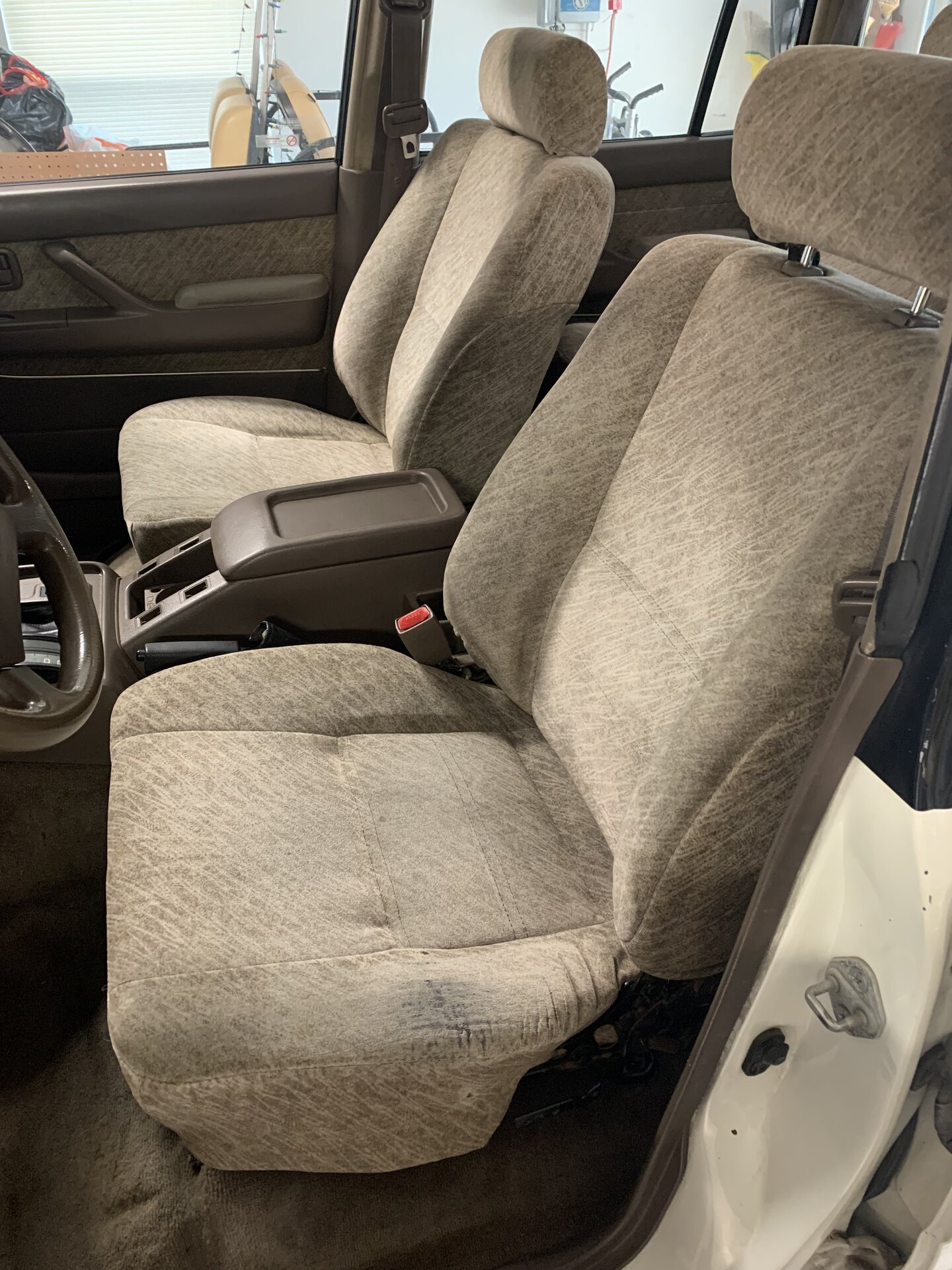

Thanks for the writeup. Just did this for my DS bottom cushion and this really helped. I have manual seats and cloth and there is only one electrical connector under the seat for the seatbelt connector. My cloth is still in excellent shape but I don't have any running boards and can't touch the ground so the outside bolster was shot from sliding out of the seat. Once done it looks and feels like new.

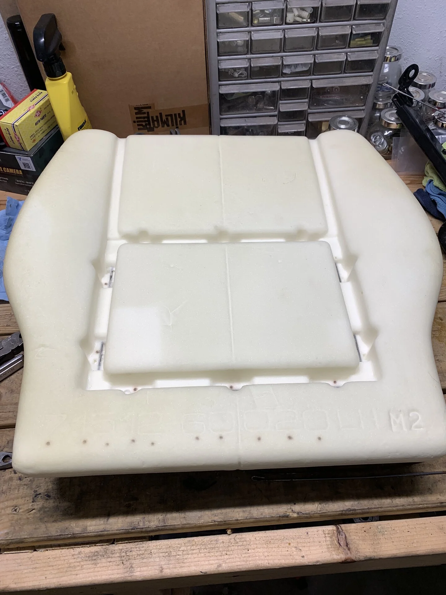

I just got my new OEM DS bottom foam today. Looking forward to sitting a little higher and more comfortably by this weekend.

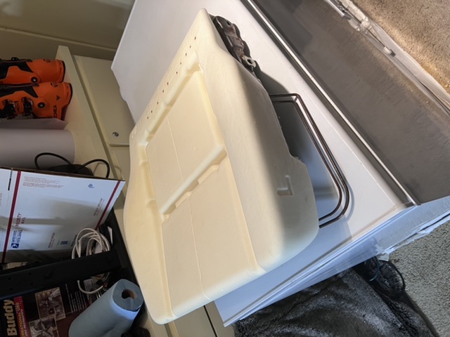

With enough beer and cutting, anything is possible. Barring that, the seat bottoms are not interchangeable to the best of my knowledge. The outside seat bolster (on each seat) has a steel bar to protect the recline switch. The seat foam is molded to fit over that bar. The seat bottom is molded specifically to the driver and passenger side.

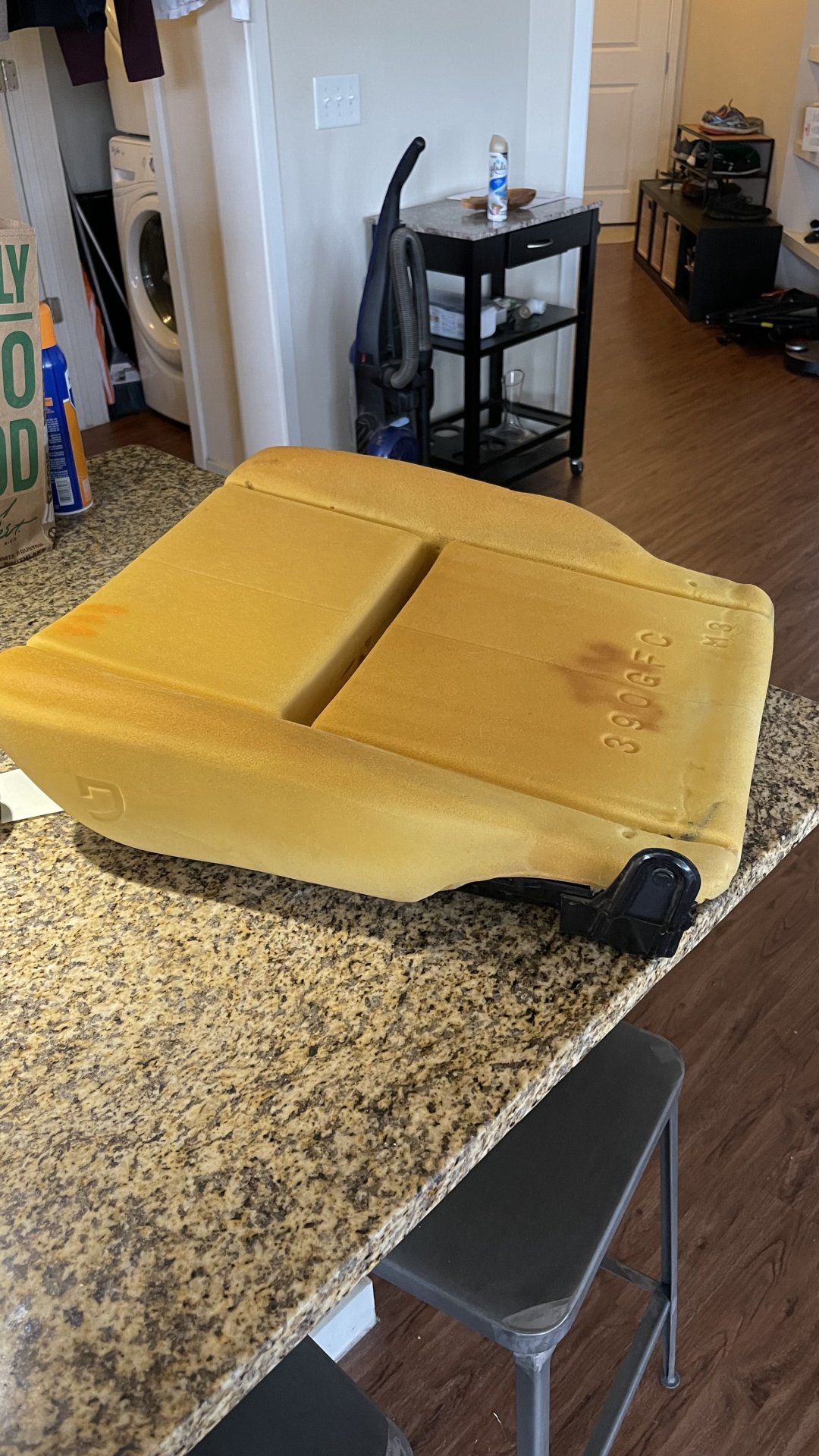

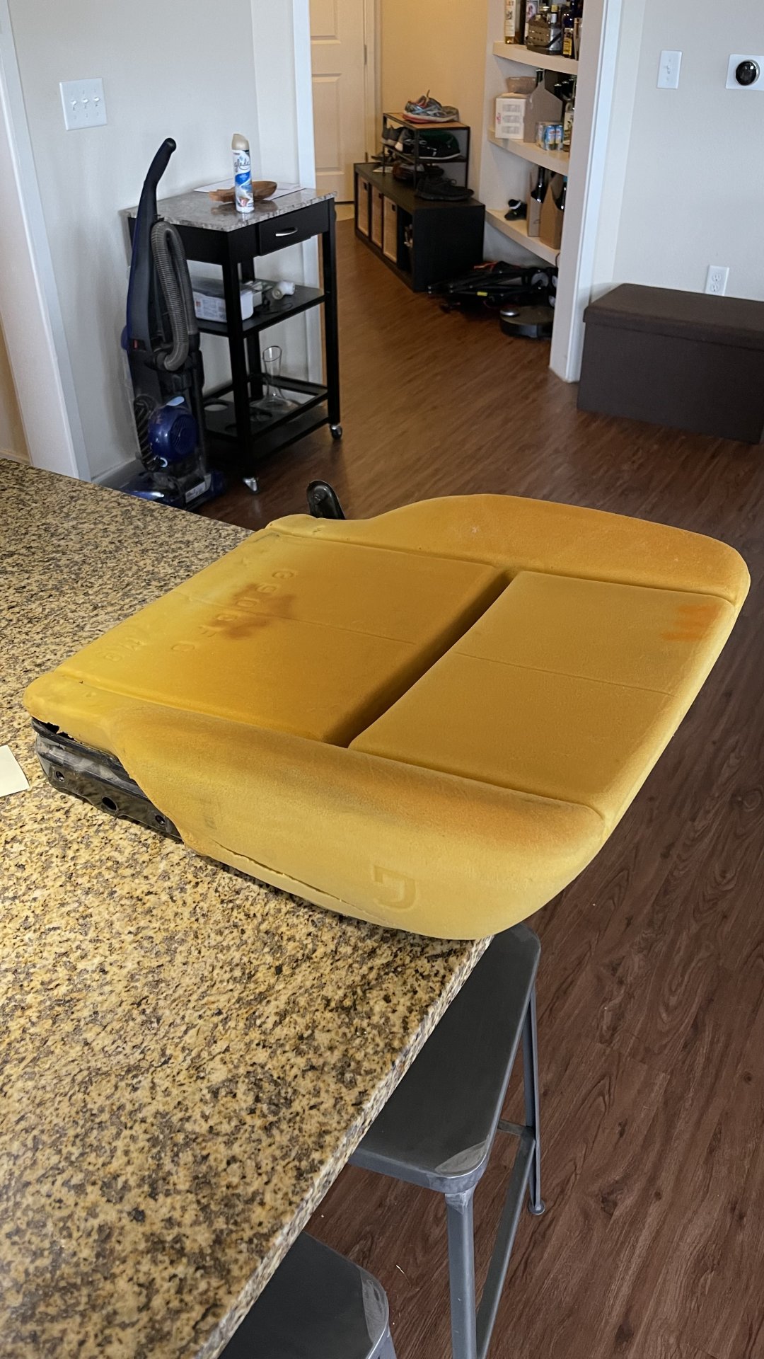

I just replaced the seat fabric from my driver side with a passenger bottom cover from a junk yard rig. Of course, the bottom foam for my driver seat is in thousands of pieces all around my vehicle, so I decided to put a SOR foam in. Everything people say about the SOR foams is true, much taller (I’m 6’1” and my head brushes the headliner if I am wearing anything in my hair) but also much more comfortable.
As far as the foam and frame on the donor seat, I don’t see anything special other than the post that the seat back hinges on. The foam bottom and the frame look totally symmetrical. Feel free to correct me if I’m wrong, but I’m going on what I see.

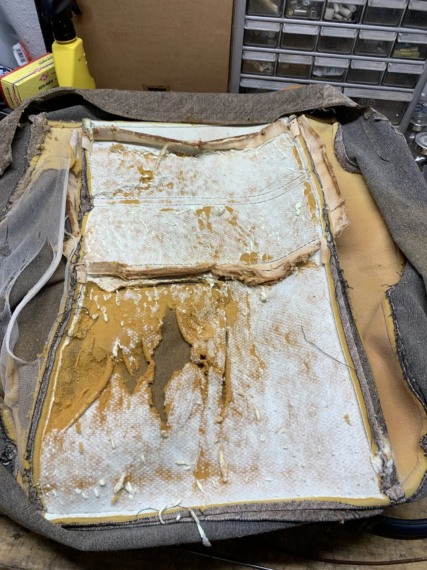

I just finished this job on my DS cloth manual front seat. This thread really helped on numerous accounts. I went with the zip tie route.

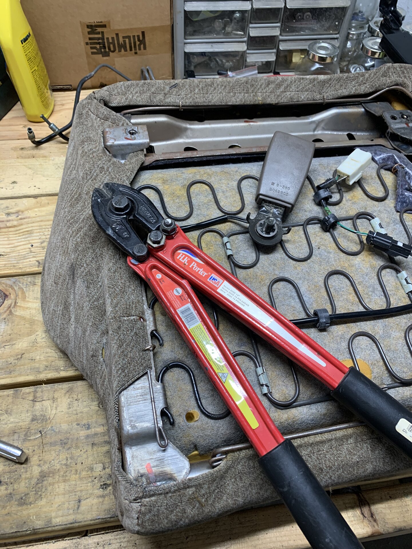

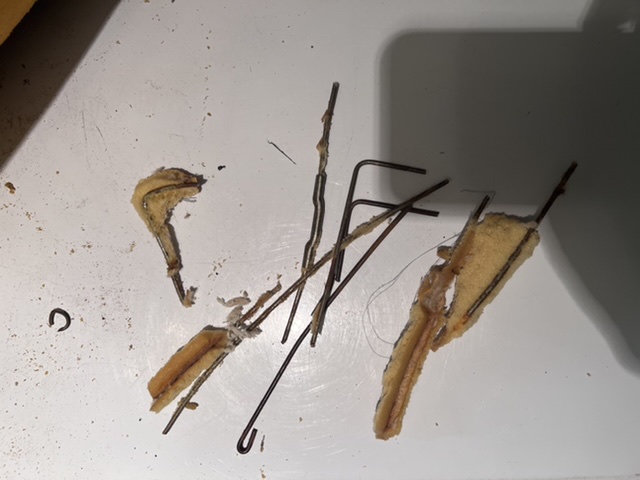

The job took me about 2 hours. I think I saved significant time by cutting out the metal wire in the old foam cushion in sections and sliding it out from the hog rings which remained attached to the cushion cover, rather than trying to open/ cut out each individual hog ring.

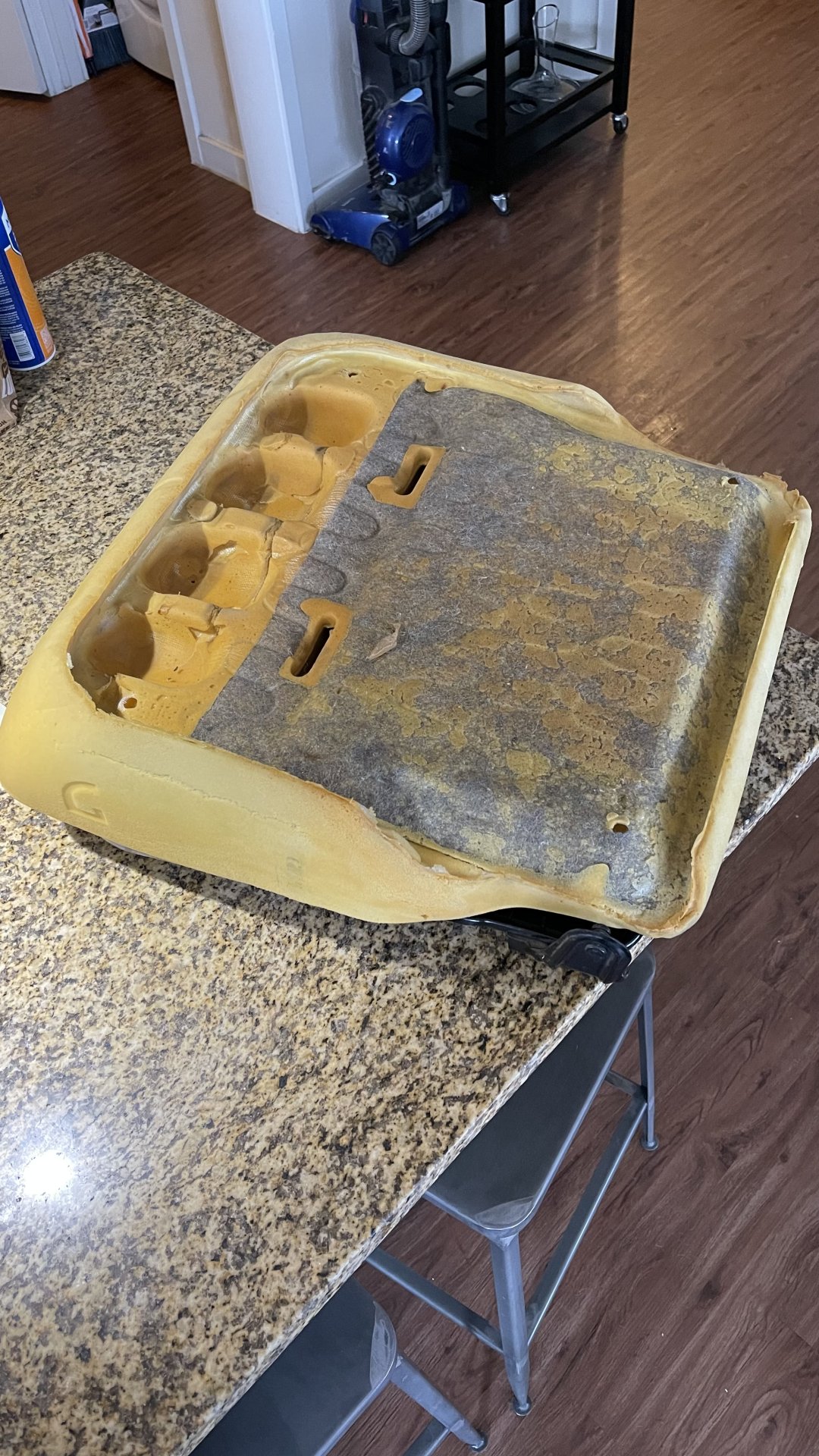

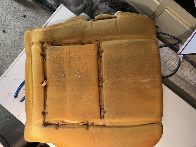

My old foam was annihilated so it was a pretty messy job. I had my shop vac handy as I did the work on top of our basement chest freezer, which proved to be the perfect height for me. Very easy to work on that surface.

Thanks for the tutorial. Did mine today. Took about 2 1/2 hrs. Foam from JDM Japan on EBay. Cut the old hog rings with side cutters. Reinstalled using cheap hog ring pliers from Amazon. Pliers came with hog rings.

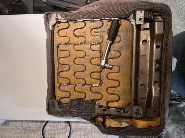

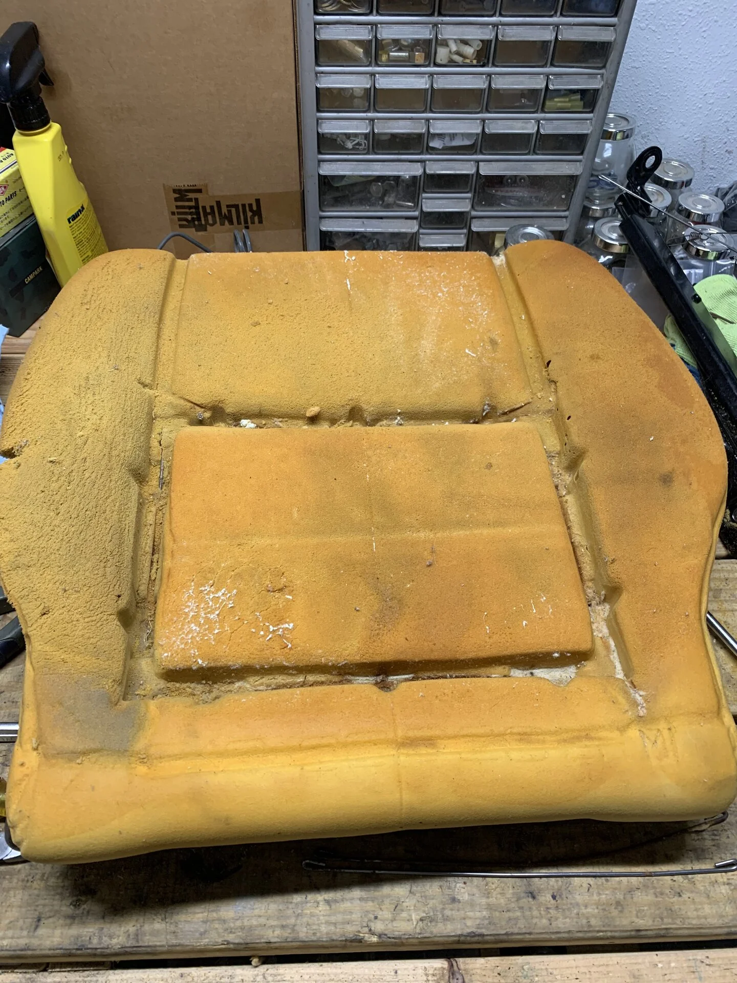

Knocked this out today on my 97, the DS seat bottom fabric is worn but still alive but the foam bottom is beyond burnt toast. I used some large wire cutters on the hog rings around the outside of the seat, needle nose on the inner rings. The foam on the underside of my fabric was in rough shape, I ended up removing most of it before washing the fabric. I used zip ties for reassembly which went pretty quickly, doing so allowed me to get them all in place before snugging them up and trimming. Overall, it came out pretty good, comfort is night and day.

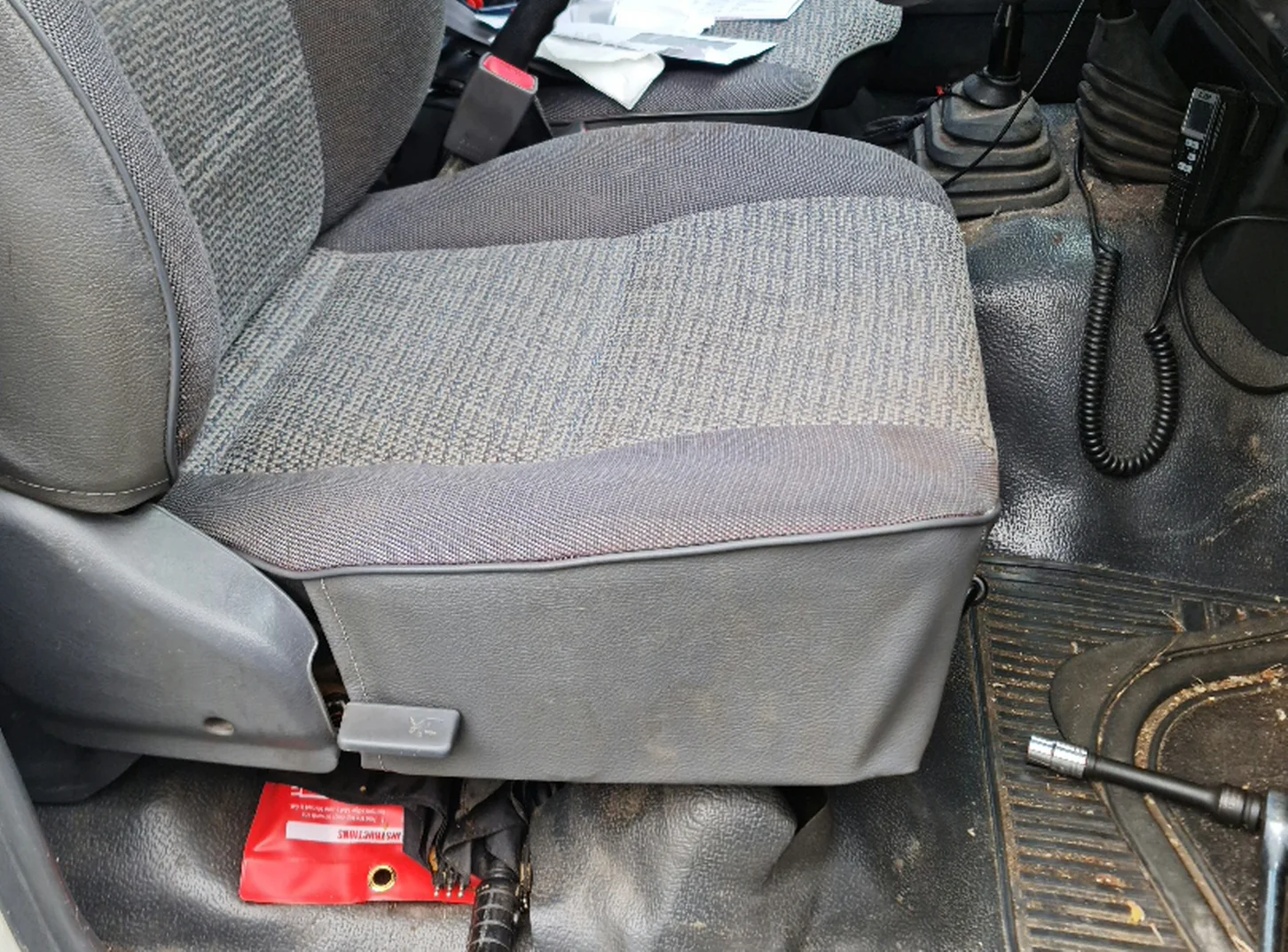

I should add a few things to this thread, I did a foam replacement for the drivers side seat of my HZJ80R a week or so, but I also repaired tears in the fabric by cutting out new cloth panels from a donor 80 series seat back, stitching it all up with industrial thread, and cushioning the metal wire edges around the seat to prevent "cutting into" the fabric when the foam gets worn, which is what caused the tears in the first place and seems very common.

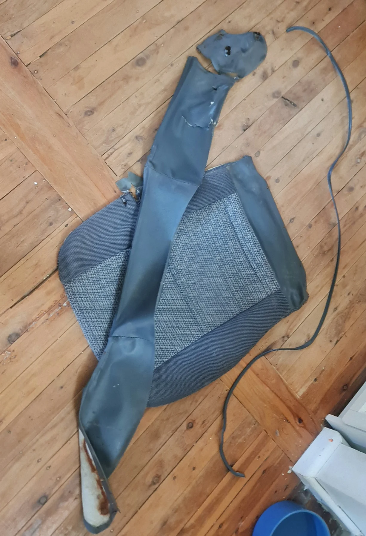

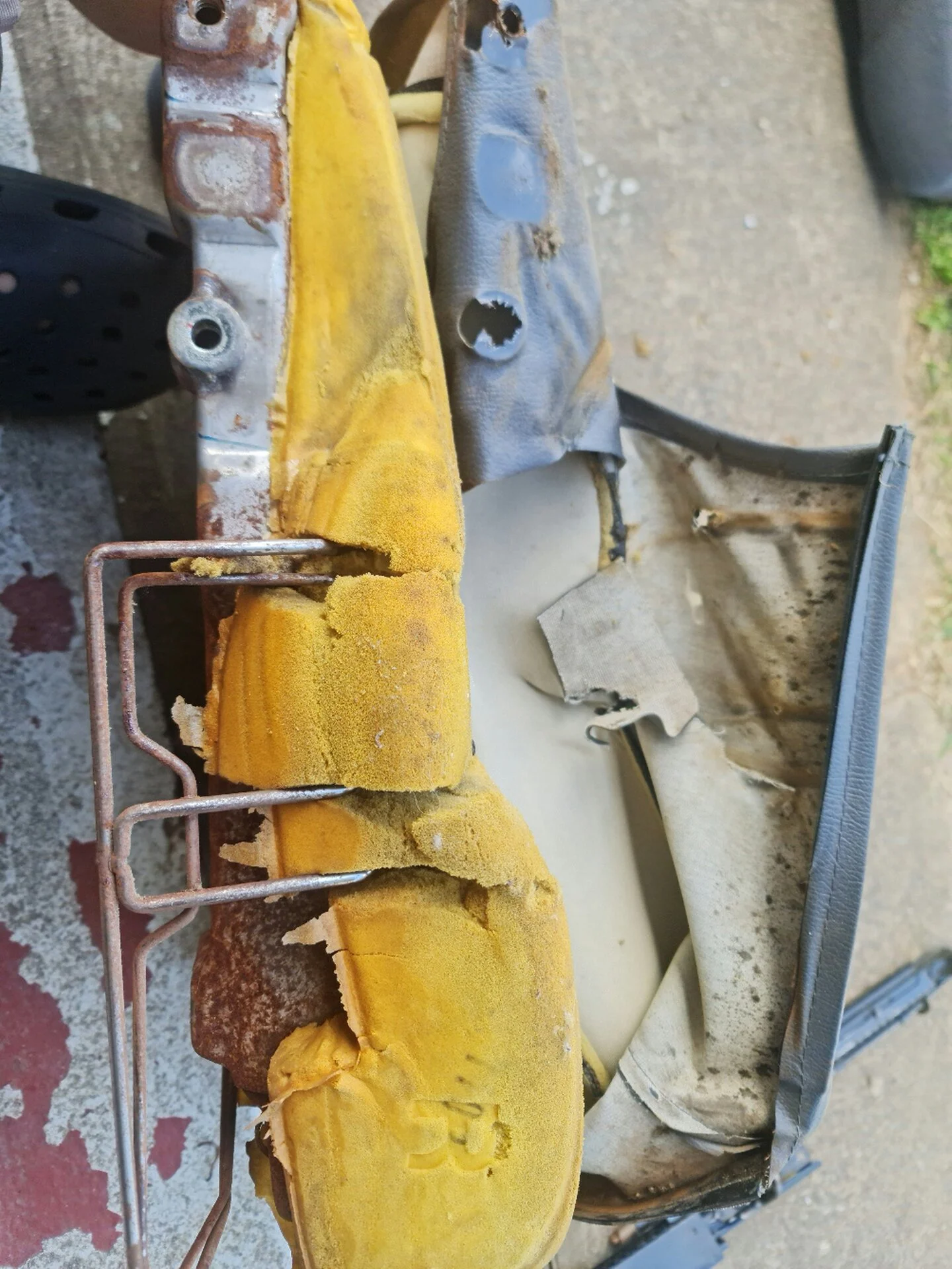

Ehh, I'll throw a few pictures in here now and the broad strokes. I thought I took a good "before" picture, but apparently not. There was a big tear in the vinyl side of the cloth seat on my 80, and a tear in the top fabric where it meets, and breaks in the piping on the edge. This is caused by the old foam breaking down over time, and allowing some thick support rods welded to the seat frame to cut their way through the foam and tear the fabric. You can see it a little on these photos:

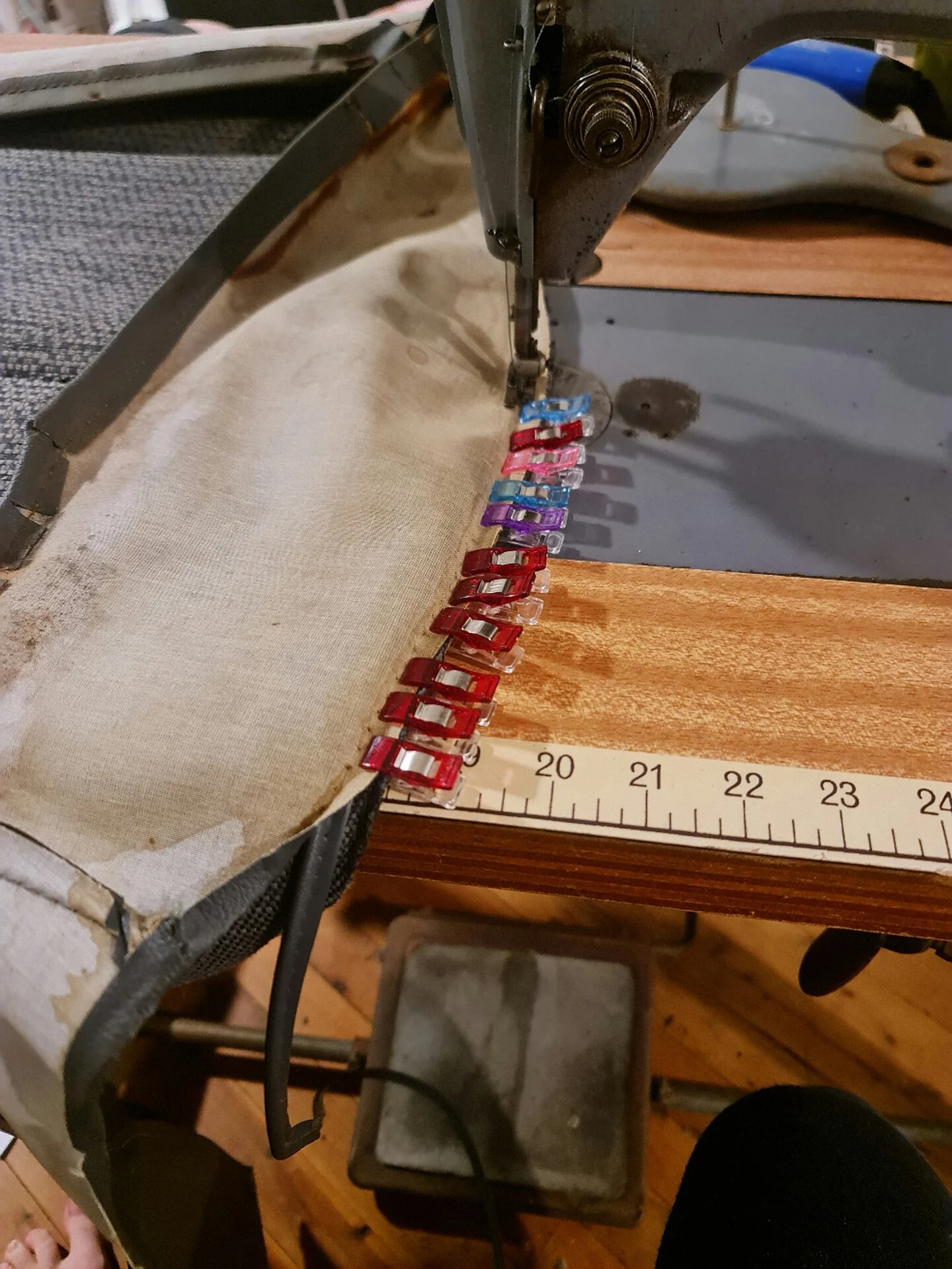

As you can see, after I removed the seat cover, I unpicked the seam all around the edge. I then unpicked the damaged sections, and used them as templates to cut out new peices from an undamaged seat back I had spare. I then topstitched the peices and sewed it all back together using an industrial sewing machine that's twice as old as I am:

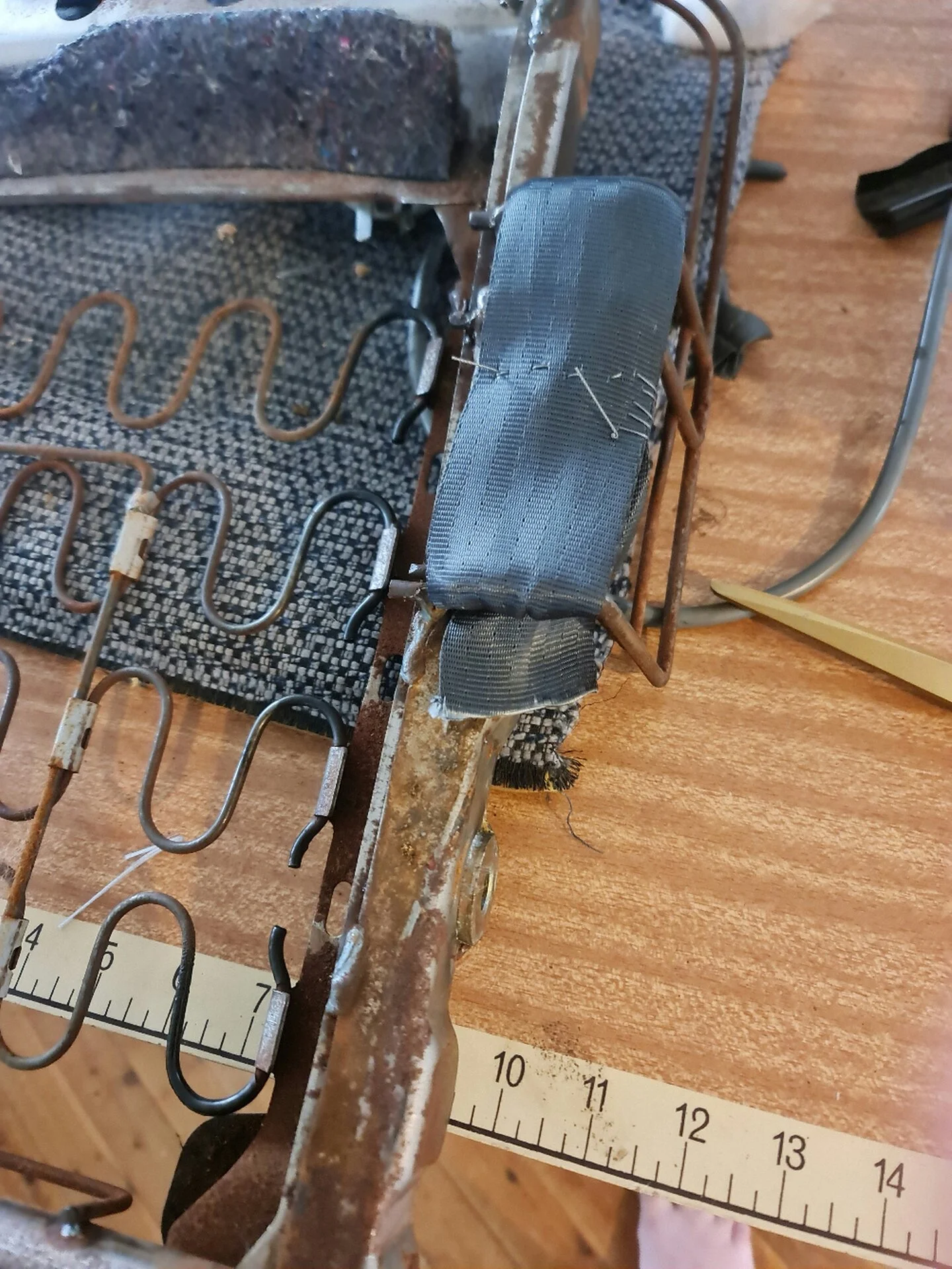

To stop this kind of tear recurring, I took some seatbelt webbing, wrapped it around the top edges of the support wire where it contacts the padding, and did a dodgy hand stitch to keep it together:

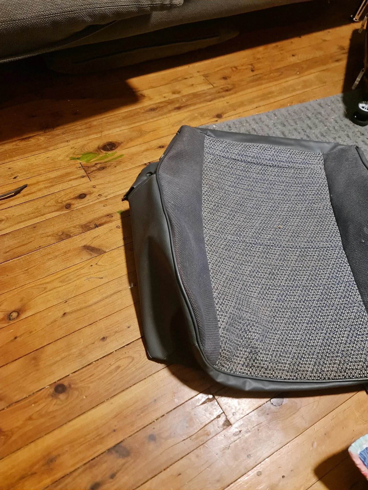

This distributes the force in this area over a wider area under the foam, so that it shouldn't be able to cut in like it did before. End result:
