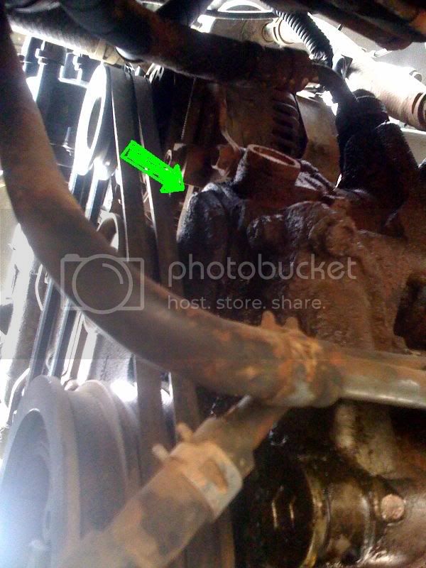

Sounds more serious to me than the oil pump seal and/or the front main seal. You need to post up pics showing where the leak is coming from. 1qt per 100 miles should be spurting oil everywhere.

the only seriously wet area is the front right at the cover... I mean, the steering gear box is leaking and so is the front 3rd... but engine wise... only up front. I've had BAD rear mains before and never lost much if any oil from that... But the pump cover makes sense to me, since under pressure on long trips when the oil gets crazy hot it will pump it out... It only looses it on long trips, not in the driveway or no smoke...
The arrow shows the upper most wet part of the block... nothing wet above that...
Eric, if that seal lets go completely your engine will be toast.
