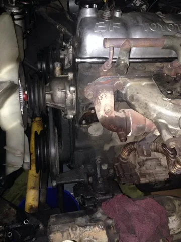

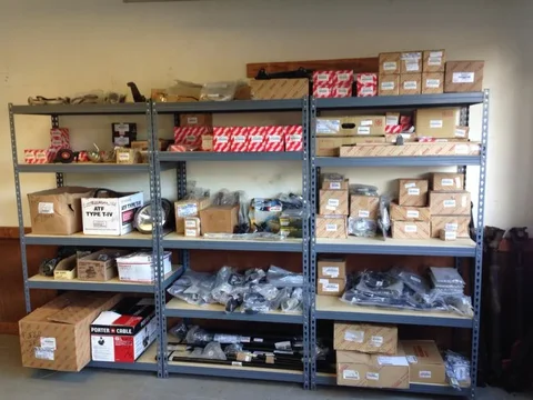

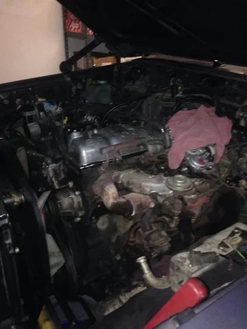

ImageUploadedByIH8MUD Forum1390953612.382283.webpImageUploadedByIH8MUD Forum1390953628.253690.webp
But I also have all of these parts waiting.
My 60 is 10/1985 build.
Would it be easier if I plan for the vehicle to be down for a couple of weeks to pull the grill and radiator. This way I would have plenty of room to work. Honest opinions gents. I don't mind a little extra work to save me a bunch of hassle. Also since I don't plan to de-smog it and all that STUFF will be in the way.

no fixing just replaced, I plan to keep the old one gutted and used as a pully once I get it smogged, so every two years I'll put the working pump on for a smog test
