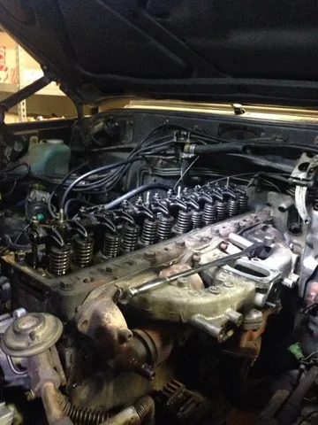

Beno, do you find that air- cooling your valve springs gives an appreciable horsepower gain?
