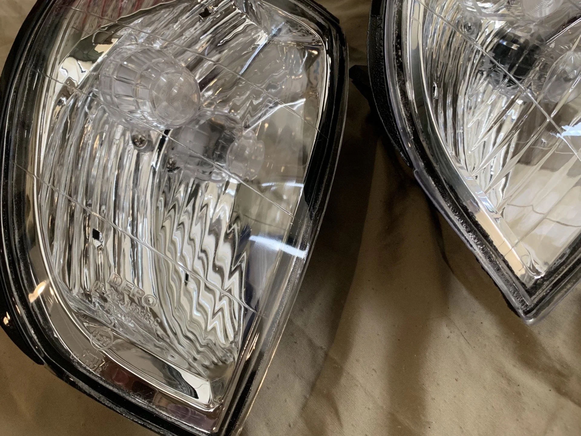

I also saw that DEPO made the clear corners too. Although they aren't Chinese made (they're Taiwanese), they're cheap, and from my experience with various cars and parts, DEPO makes acceptable fitting parts, so why not? Well, they're not as abundant as you would think. After multiple searches on eBay, I found that the cheapest set of DEPO corners would ship from Lithuania. It would be only $58 shipped, but the con was that it would take 3-4 weeks to get as they're not stateside, and was the cheapest shipping option.
Here is the exact ones I bought

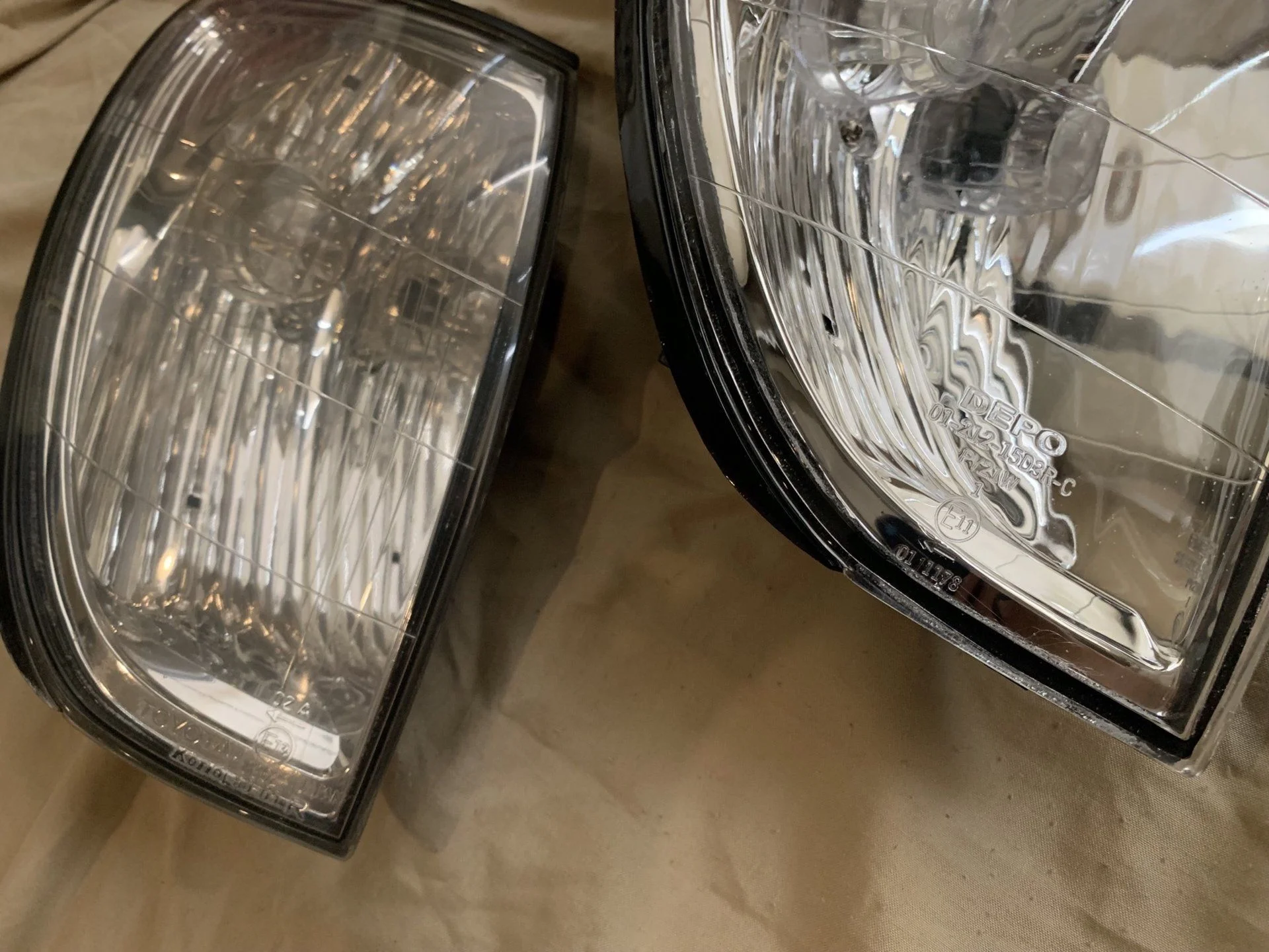

When my DEPO lights finally arrived, I figured it was just a matter of minutes to swap housings and bulbs, right? Nope. Well. Sort of. The housings themselves do install easy, but the issue was the light bulb socket.

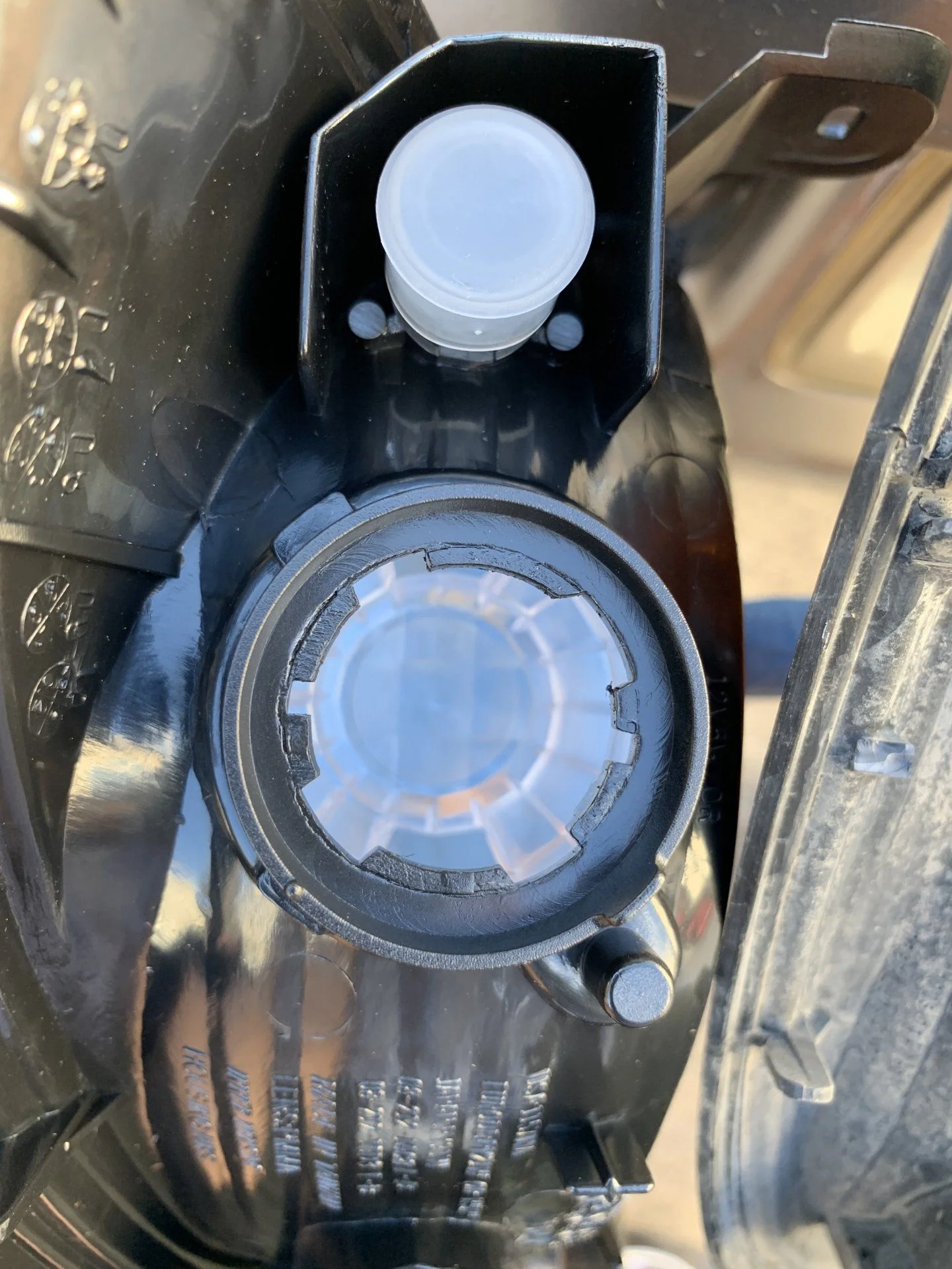

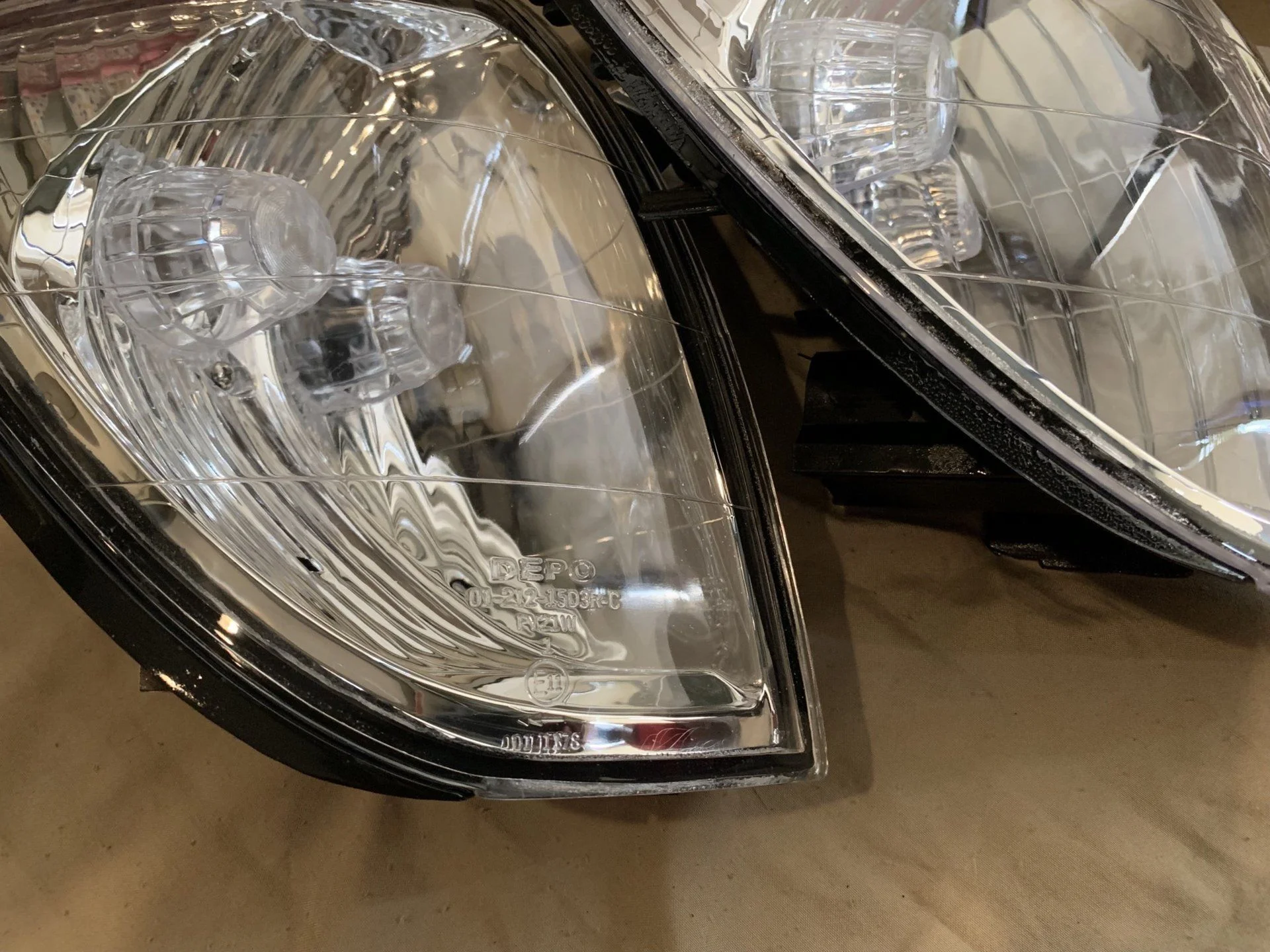

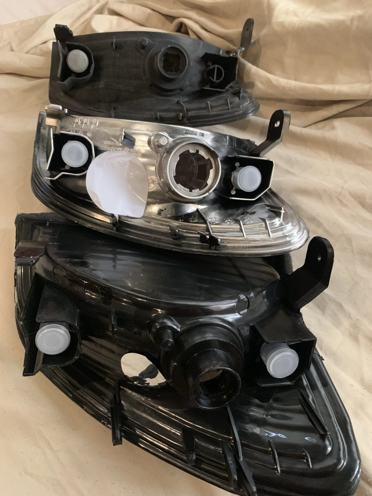

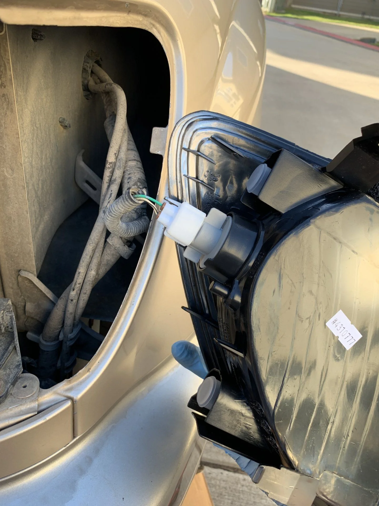

Here is the back side of the OEM Lexus LX470 corner light housing:

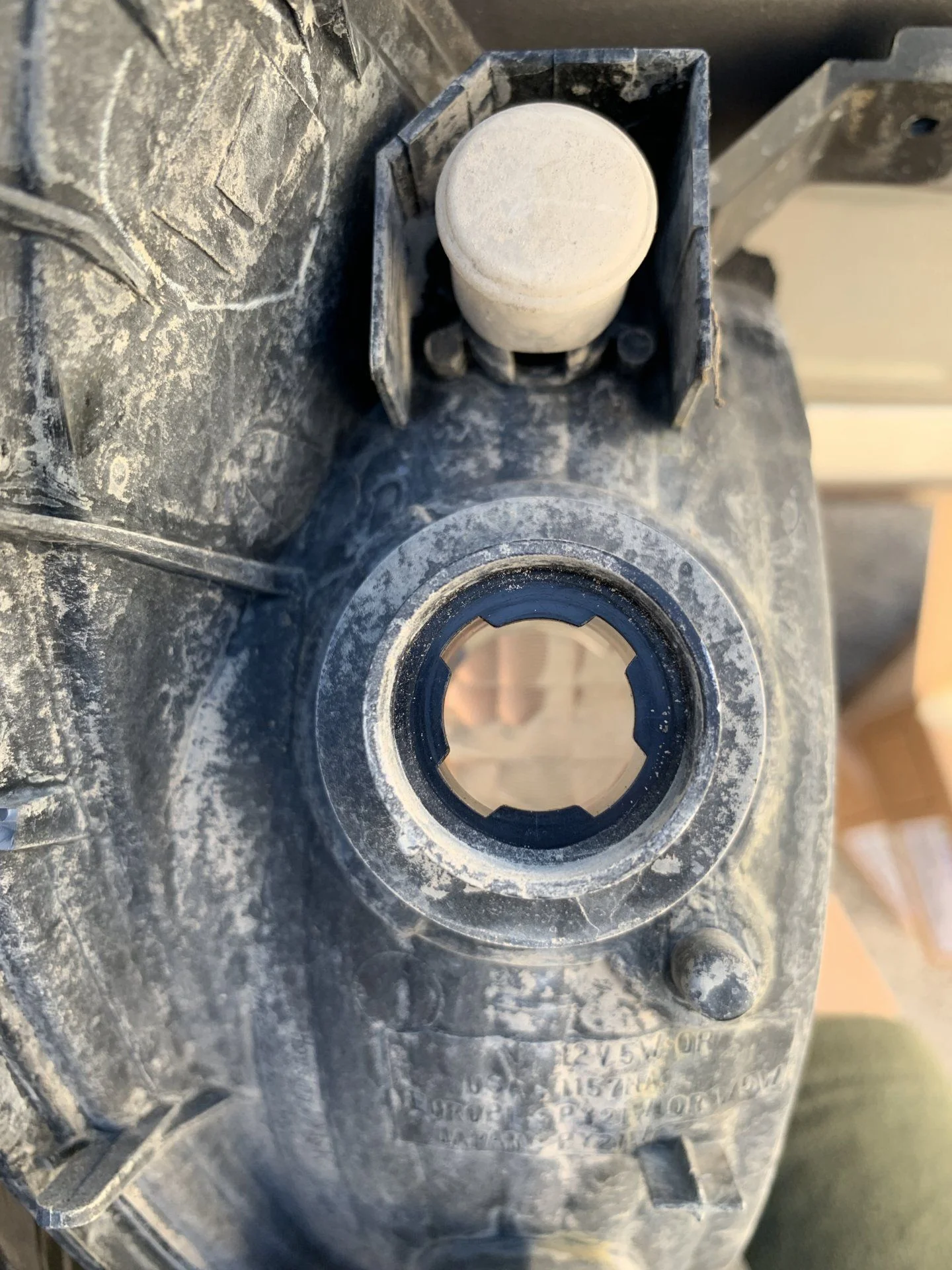

And here is the back of the DEPO light

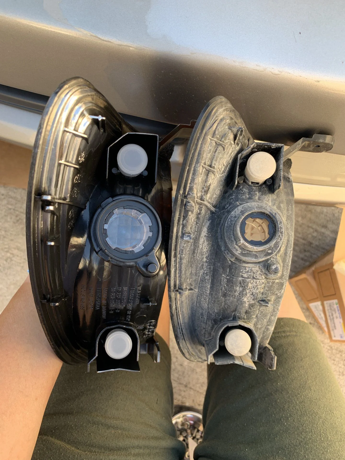

Side by side:
So as you can see, the light bulb socket sizes are completely different. Why does this matter? Well for one, the OEM Lexus bulb socket connectors just fall right through with no way of holding it in place, and for two, this would be a real issue once moisture is present, as there is no way to seal the lights.

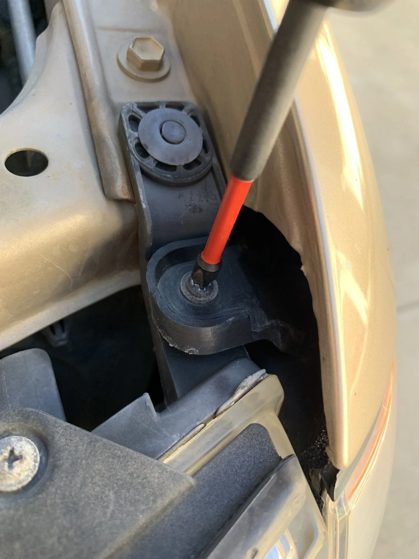

1. Pop the hood
2. Locate the one philips head screw near the front of the fender, next to the headlights.
3. Remove this screw, and do not throw away, you will reuse the same screw at the end of the installation of the new DEPO light

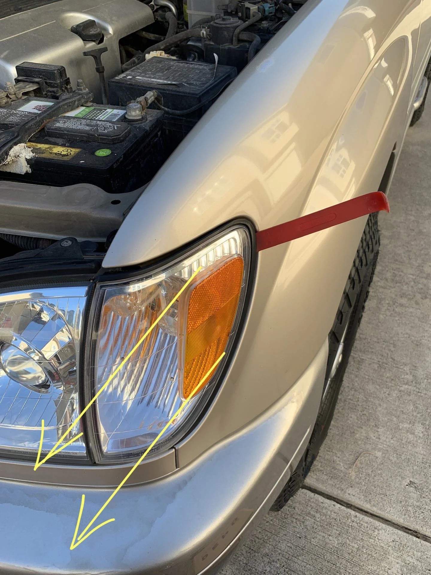

4. Using a little pressure with your hands, you will press the side of the large part of the corner light housing inwards (towards the center of the truck) and at the same time, slide the corner light forward (towards the front)
If it's not budging, you can use something like a plastic interior removal tool to wedge between the fender and light housing to help you push it towards the front so it can slide out easier.

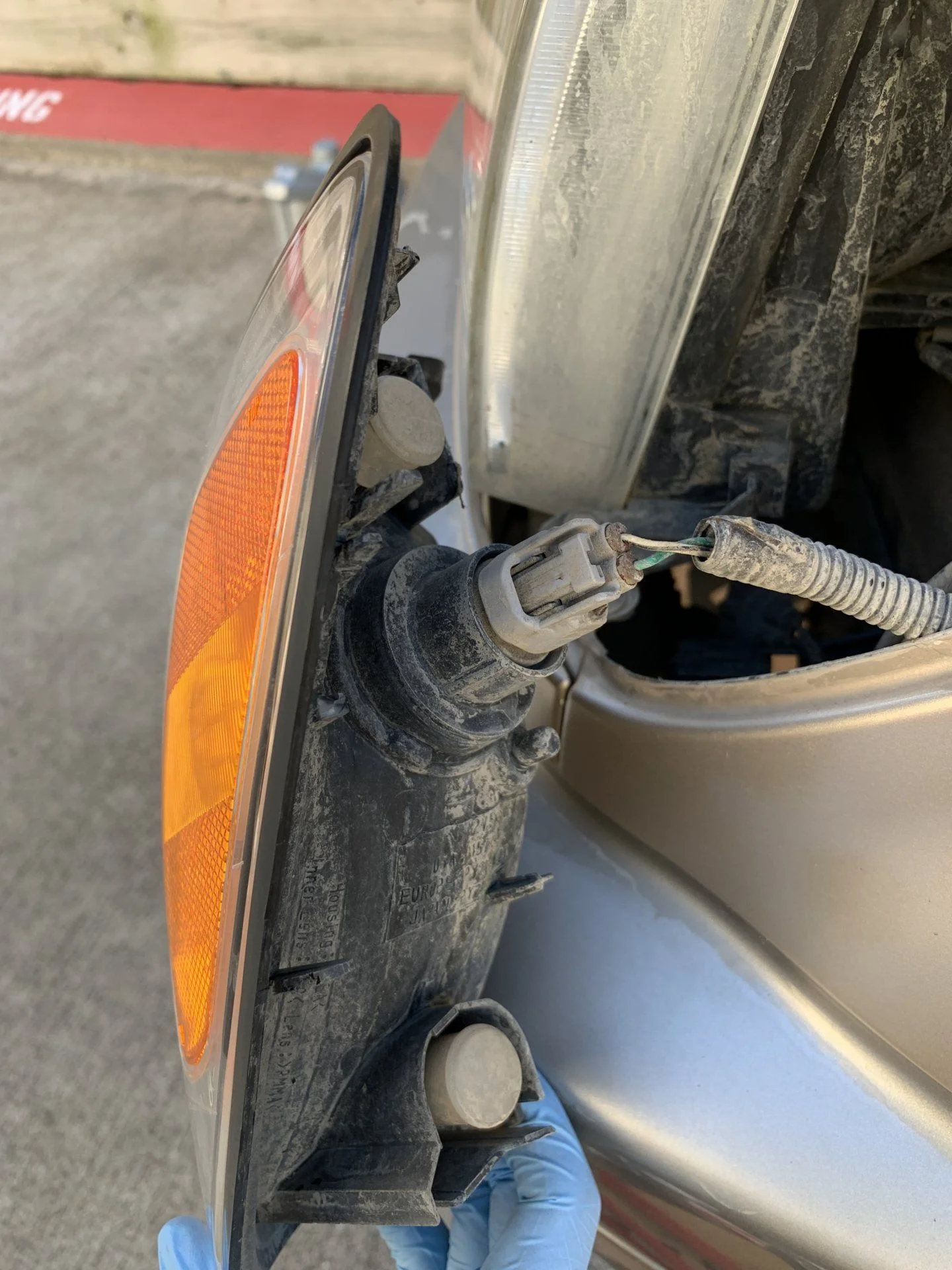

5. You may have to twist the light around a bit to make the top plastic tab where the screw was to slide out without damage.

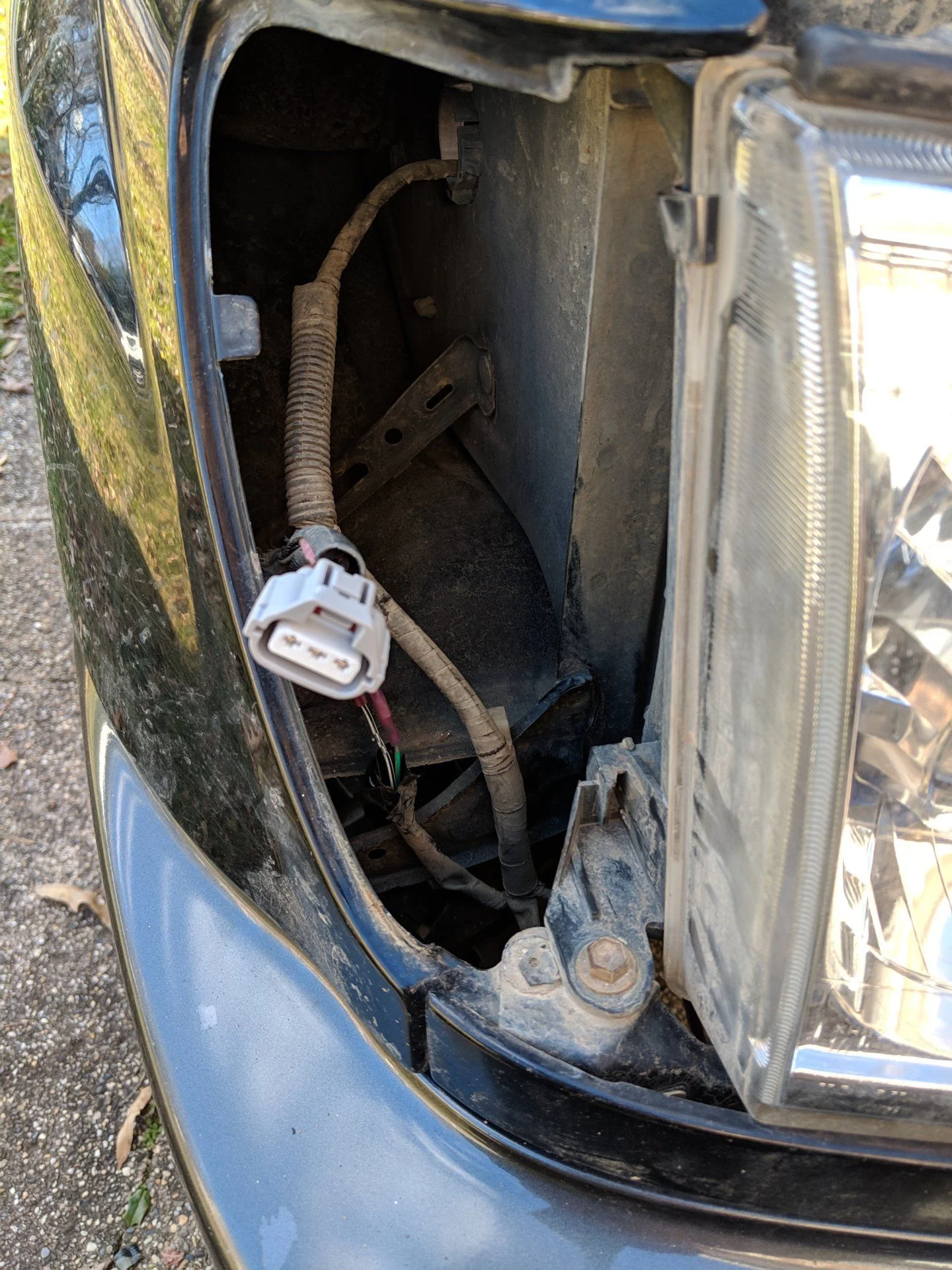

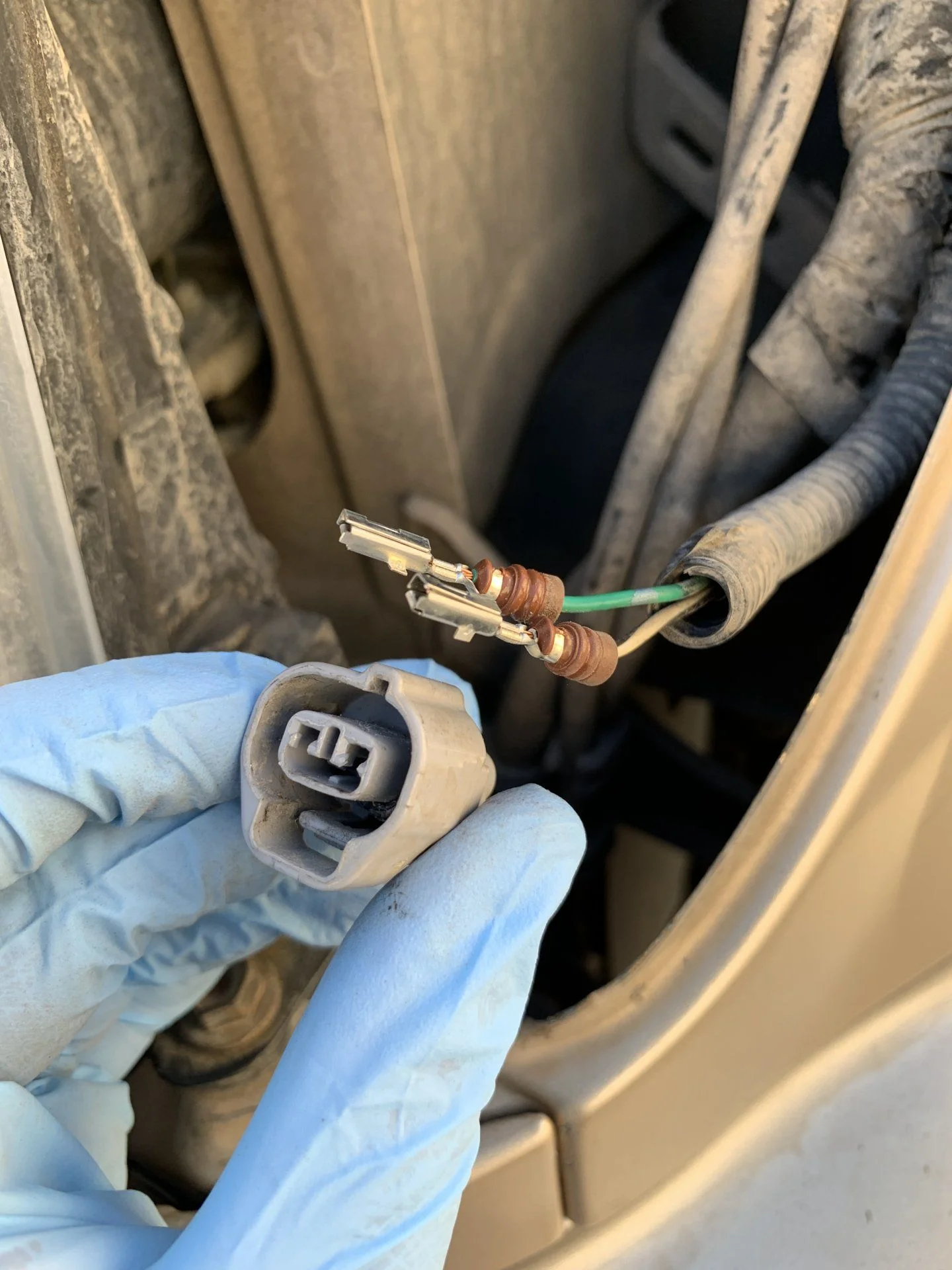

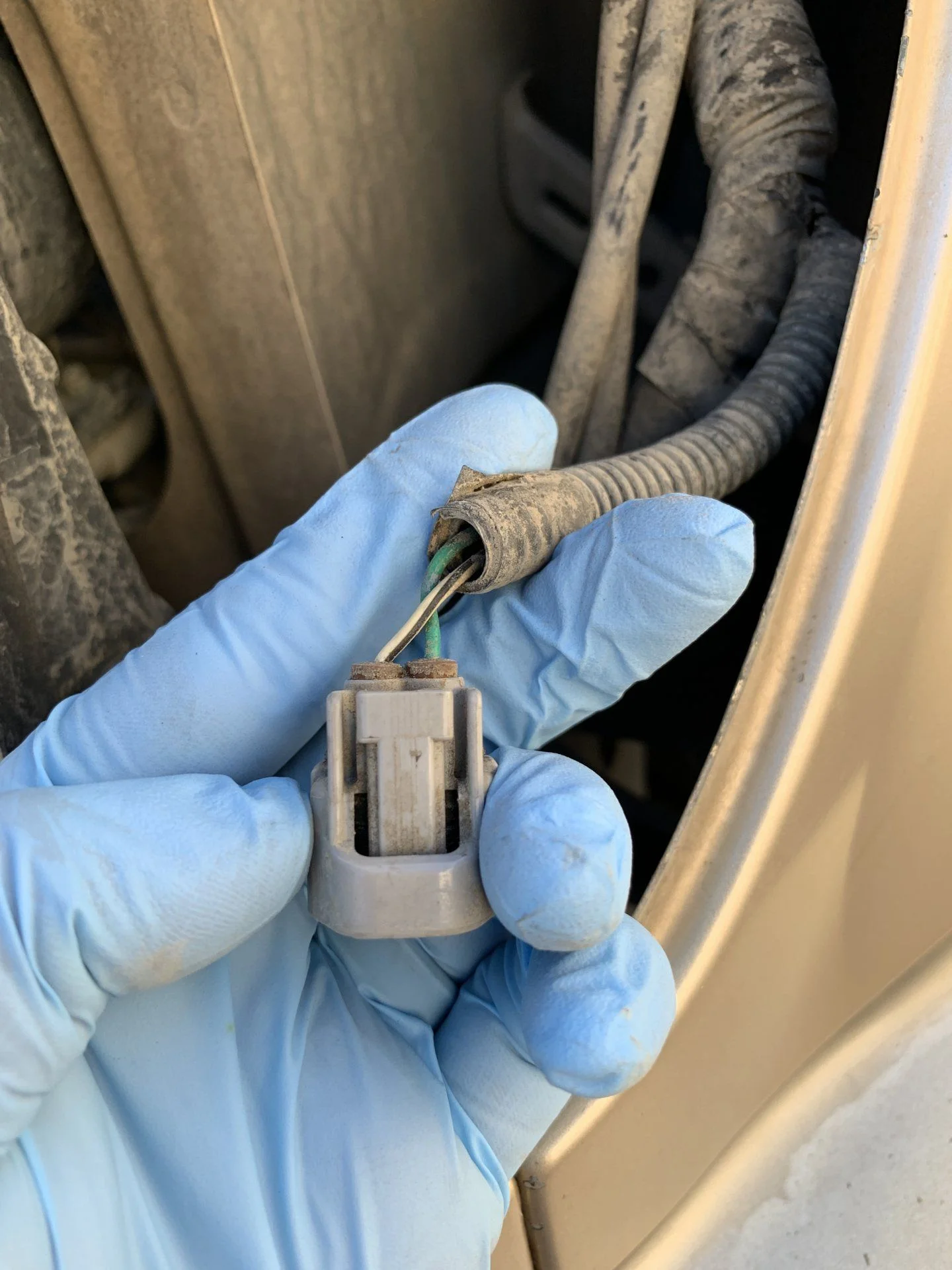

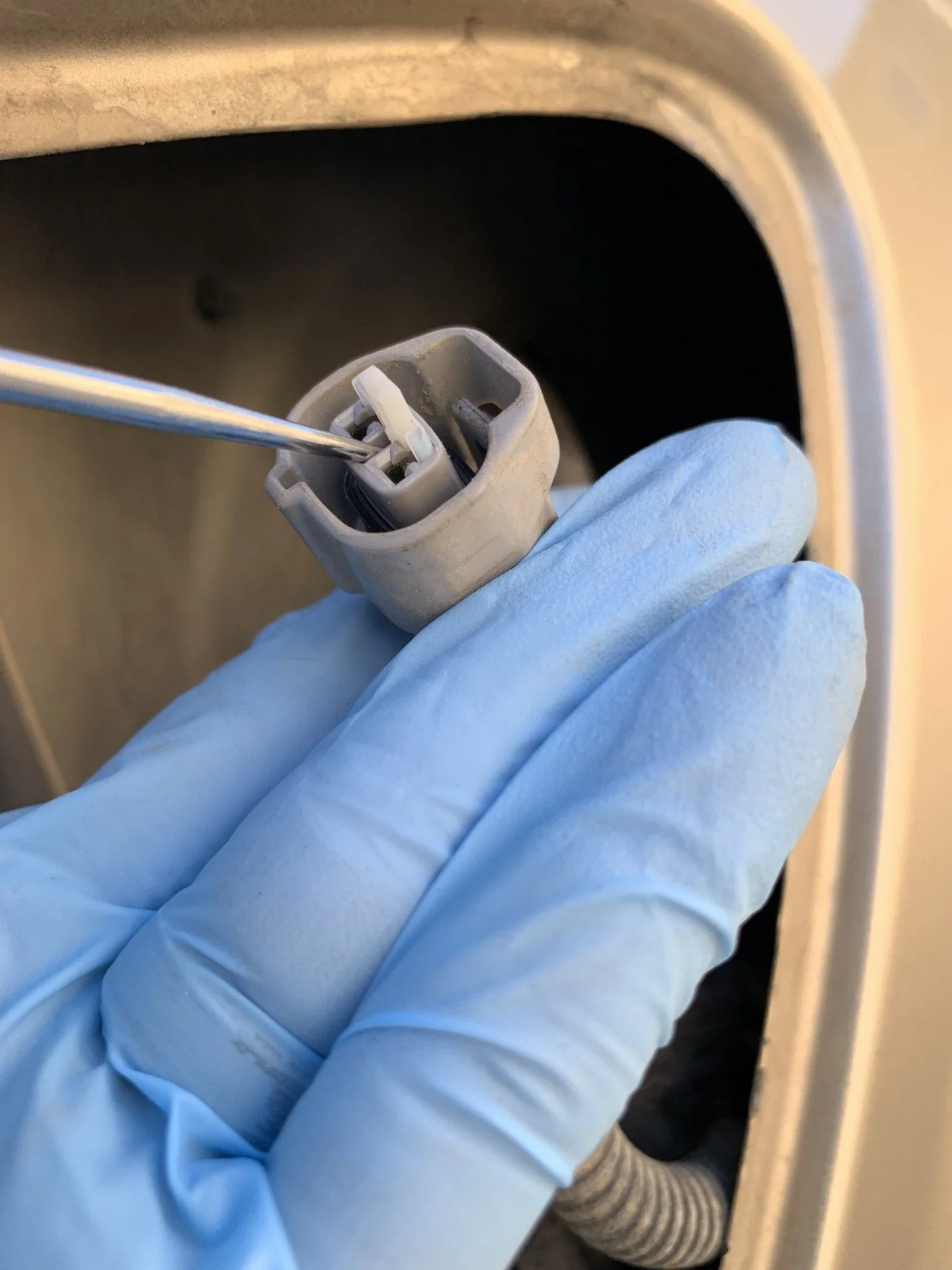

6. Undo the connector that connects to the light socket by pressing in the grey plastic tab while pulling it away.

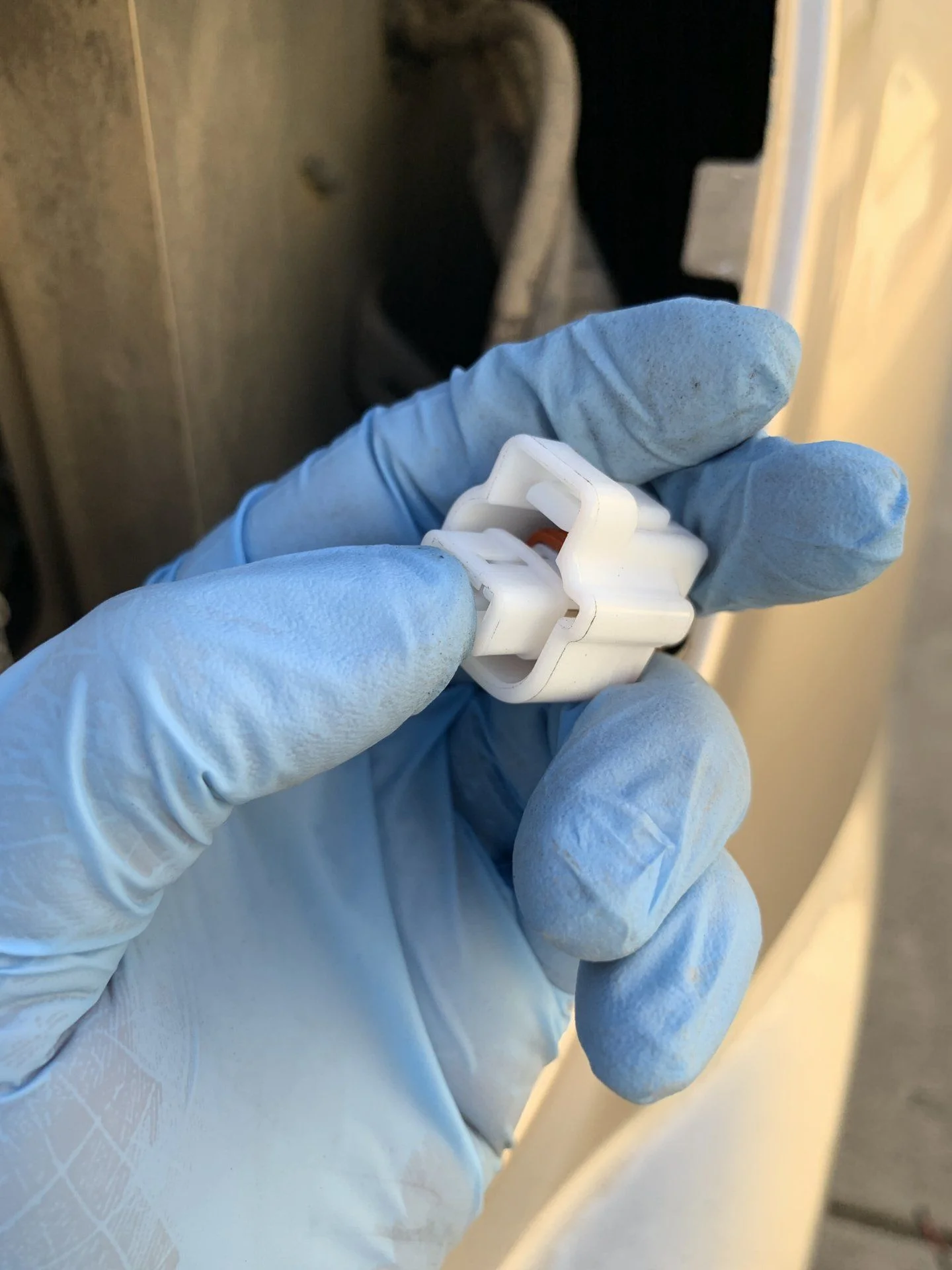

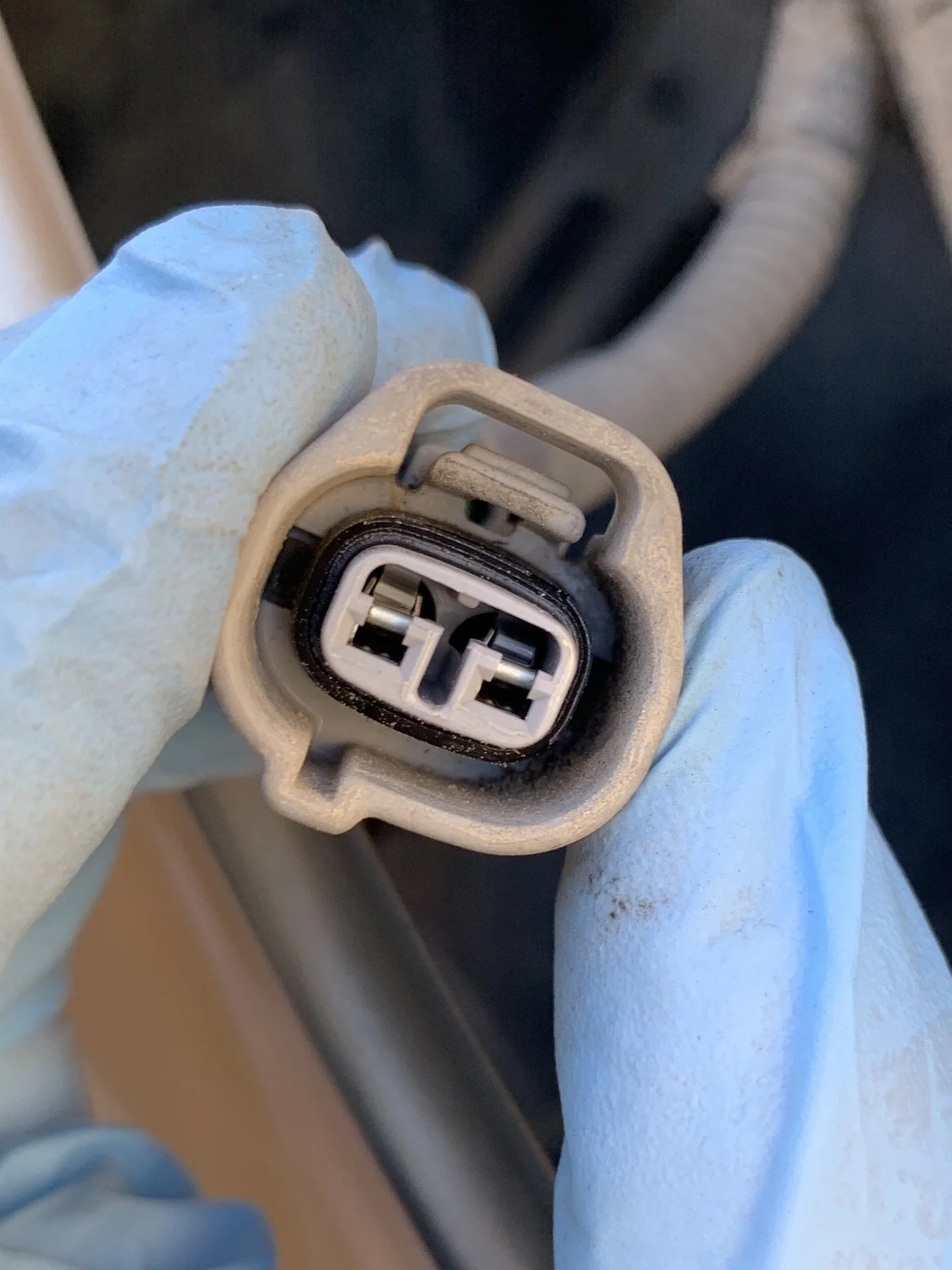

7. Isolate the connector and use your pick to remove the white plastic part from the inside of the connector.

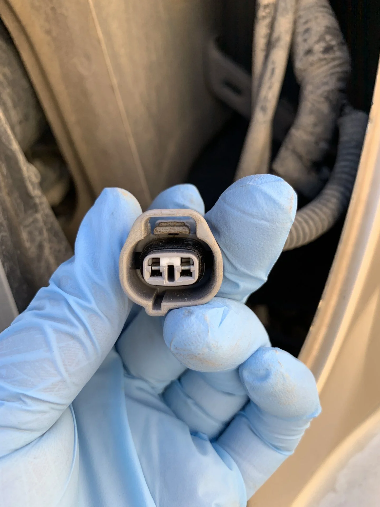

8. Here's the tricky part. (or at least tricky for me to explain) Look straight into connector and locate the two holes where the metal contacts reside. If you are looking at it in the orientation i'm holding it in the picture, you'll see tiny plastic tabs that are right above where the metal contacts are.
9. Using your pick, you will need to PULL away this tab which holds the metal contact in place. At the same time, you can either gently pull the back of the wire or you can wedge the pick in a way that pulls the plastic tab away at the same time pushes down on the exposed metal section of the connector. Repeat for both wires

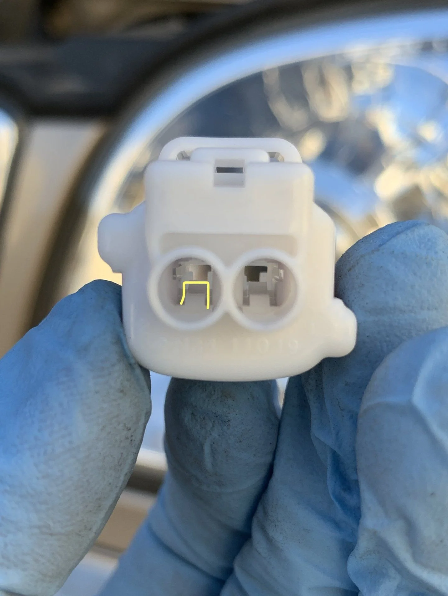

10. Grab your new housing connector (the white plastic connector 90980-11019), and face the back of the connector towards you. Notice the orientation of the holes. Guide each metal pin connector into each hole, noting the orientation of the pin connectors to match the plastic connector. If done correctly, you will feel and hear a solid "CLICK". Double check it's in place.
11. Looking at the other side of the connector now, you'll see a rectangular face that can now be pushed back into the connector to lock everything into place. Again, you'll hear a solid "CLICK".

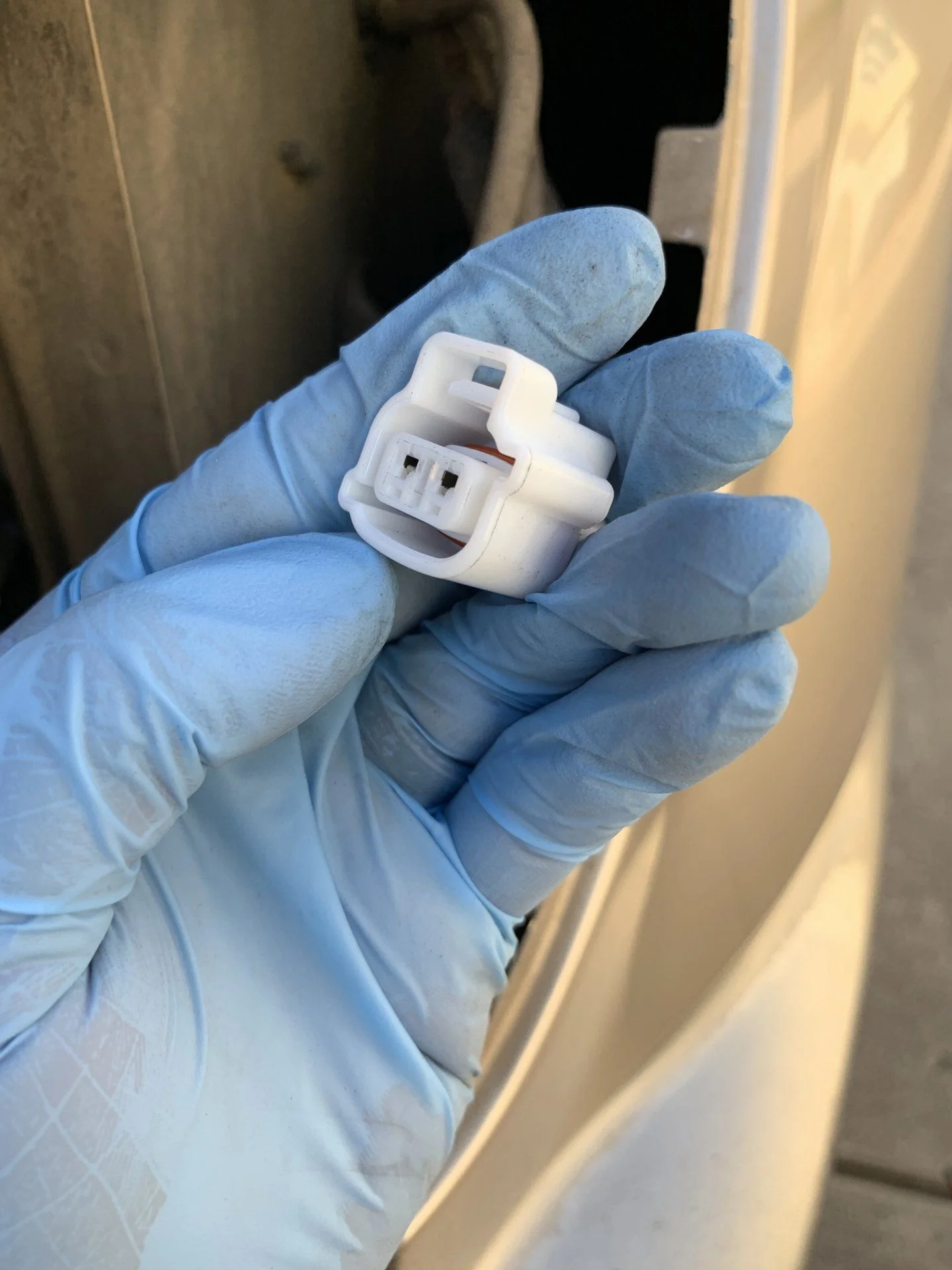

12. Put your 7057 bulb into the new light sockets (the grey plastic sockets 90075-60006) by twisting and locking into place.
13. Insert the new socket into the DEPO corner light, twist to lock into place.
14. Connect the new white plastic connector to the new grey plastic socket.

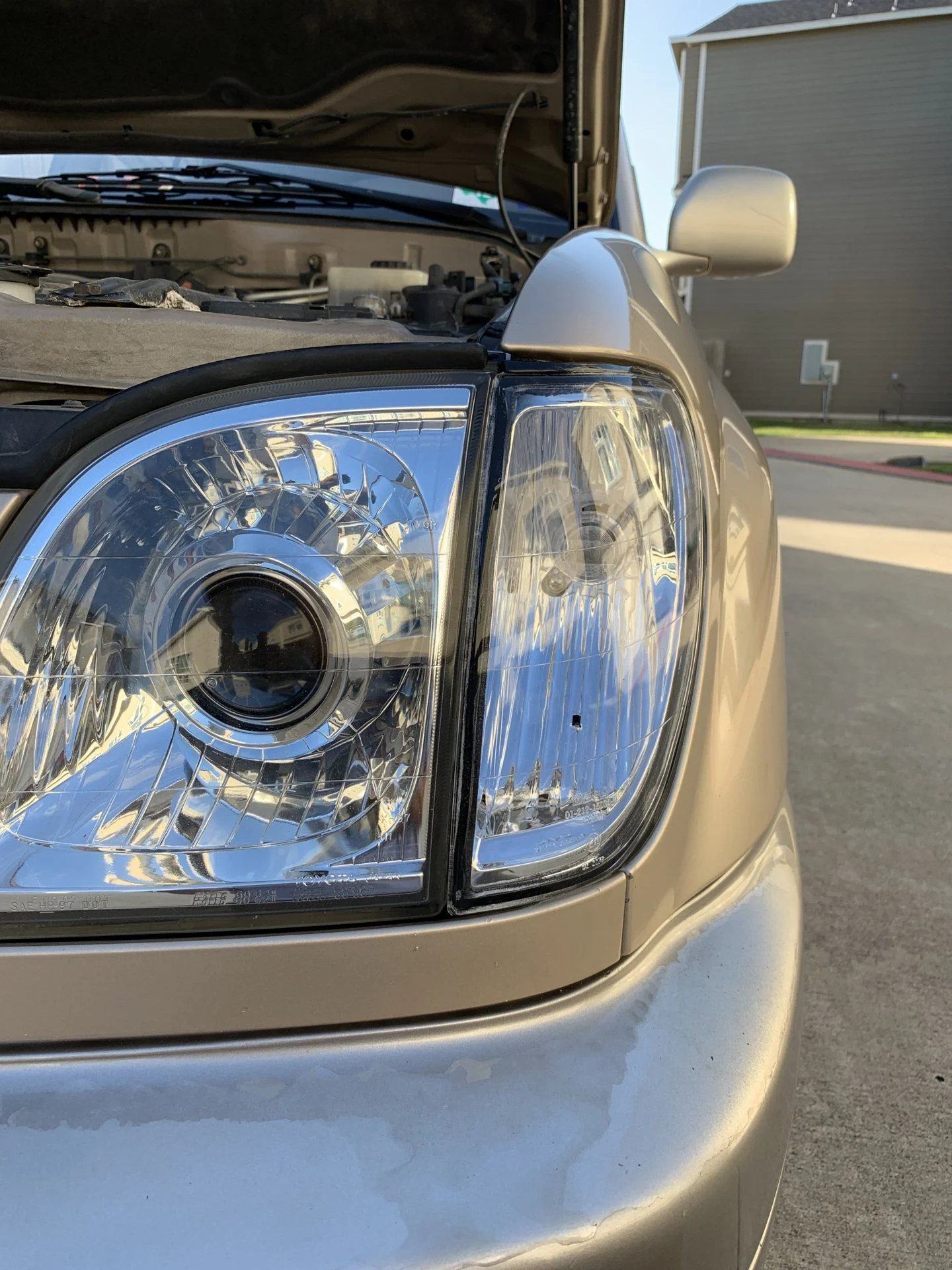

15. Turn on your parking lights to test that the lights come on
16. Slide the DEPO light back into the fender, taking care to tuck the wires back in, and avoid breaking the top plastic tab where the old screw goes into.
17. Make sure there are no gaps anywhere, and then install the original screw back into the top plastic tab located near the fender and next to the top of the headlights.
18. Repeat for the other side
That's it! Next up will be installing neon underglow lights, Yosemite Sam "Back Off" mudflaps and a footprint gas pedal!
Although this is a write up for a DEPO light to an early model (1998) LX470, I am pretty sure it works on the JDM OEM Toyota corners, but I have no idea what needs to happen on a Land Cruiser or even possibly a late model version as I know some things have changed.
Hope this at least helps out ONE person out there in the future!

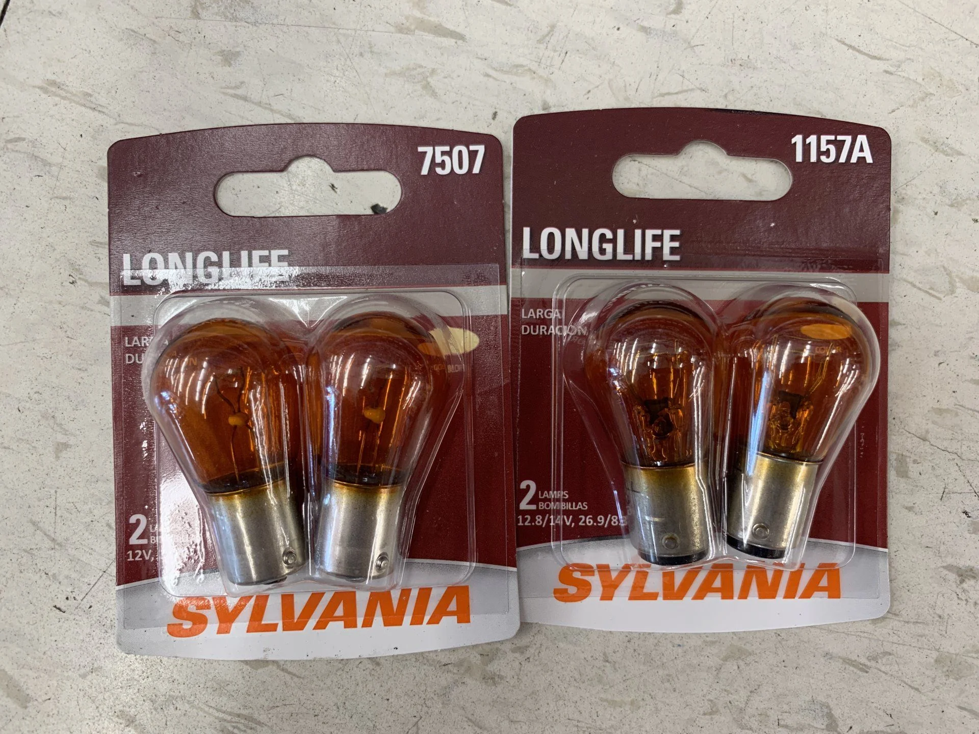

So according to that thread I mentioned in my first post, the TOYOTA bulb part number is 90981-15009, which is an amber bulb you can get on Amazon for about $7. The OP mentioned that it is a 7057 bulb which looks just like that OEM Toyota version. As you said, a 7057 bulb is indeed 21W and is intended to be used as a turn signal and less a parking light. A 1157a bulb uses the same base (will fit the same), but is dual filament and only uses 8.3W. I think it should work just fine either way, but for simplicity’s sake I said 7057.
I went to an AutoZone near my house and actually compared all of the bulbs to see what would work.
Here are the 7057 and 1157a bulbs next to each other.
I myself am waiting for an 1157a LED bulb to show up today from amazon and will see how that works and update accordingly

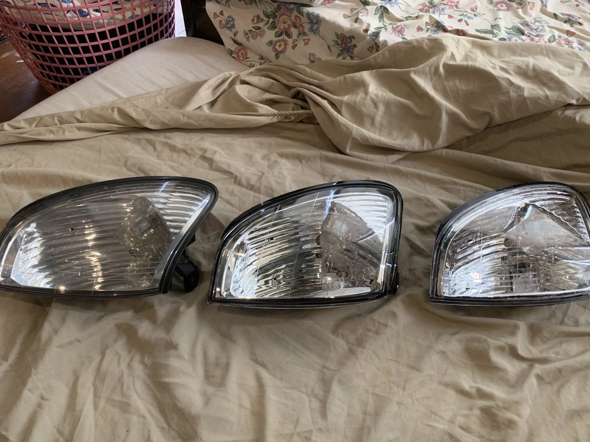

To those who do not wish to re-pin and change the bulb, the Chinese ebay version has the smaller hole cutout for the LX470. The quality however is worse than Depo which is already lower in quality compared to the OEM Koito lamps. The Depo ones fit mine really well, it stays clipped and the fit is good. I haven’t tried the Chinese one.
Left: OEM Koito
Middle: Depo
Right: Chinese lamp from ebay
Left: OEM Koito
Middle: Depo
View attachment 2092072View attachment 2092073View attachment 2092074View attachment 2092075View attachment 2092076
Can confirm the chinese ones have the smaller holes that match the LX470 socket. They are poorly made tho and I had a really hard time to get it to sit right. Mostly waste of money.
