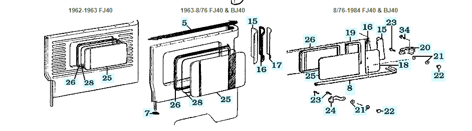

I hope this is in the right place. I don't think I have posted on here but one time. I have been occasionally looking for a hard top for my 72 fj40 project and have found one 8 hours away but he doesn't know what year it is. Can I somehow identify the year from pictures? I've had this project for three years and its time to finish it up this summer.

Pictures would go a long way towards giving it the year range of a hard top.
The guy only has one picture for now and I'm having trouble finding it. If I do, how do I post a picture. I'm not good at computer stuff Lol
If you check out the SOR website, it looks like there are three variations on of the hard top.
The easiest way to determine which is which is probably looking at the window configuration on the sides.

that is a later, ambulance door hard top, the vent windows make it 1978?
and it looks like 1 of the vent windows is missing
