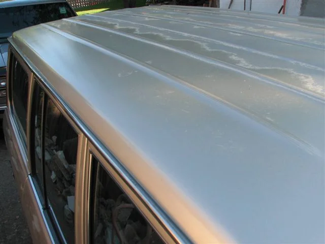

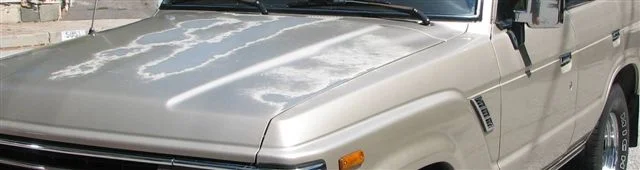

Thanks to everyone for their thoughts. I am in the process of hopefully purchasing a cruiser with a few paint issues and was just looking for estimates. I appreciate all the input. The body is solid on the truck, no rust, just clear coat issues really. I'm not looking to get the truck to show quality and if the burned out clear coat doesn't cause a problem and promote rust, I could probably go years without even thinking about it. Thanks again.
If you are not looking for show quality, there is the Rustoleum option. and no i am not kidding. look in the paint section for it. it has been done before with decent results.
You might get away with wet sanding the hood and roof and having a new coat of clear put on it. My 60 series hood was starting to look that. I used Meguire's Diamond Cut buffing compound on it and got it pretty good and then I painted the center hump. Flat black is pretty common in the Cruiser world for the hood. I of course had to be different and painted a US flag on the hood.
