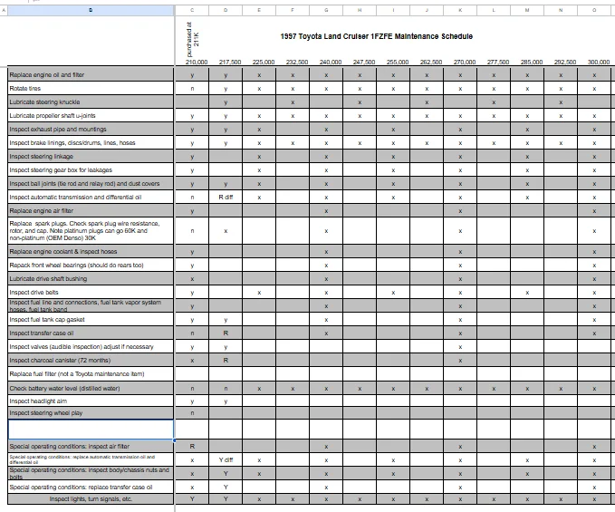

Every 7500 miles I follow the above PM schedule.
I'm just past the 285000 mile mark. It takes me anywhere from a morning to an entire day to complete the check list.
For the high intesity PM cycles it might take a couple of days or even a couple weekends.
I'm already gathering parts for the 300K cycle and I'll be going through the front of the engine to elimiate oil leaks.
There are things that I do every 7500mi that aren't on the list; such as grease the rear brake slider pins, and check the soft break lines for craking; blow out the axel vents and confirm the air lockers are working correcly. I check wheel bearing play and tire wear patterns.
I have converted to an AGM battery, there is no water to check.
So... a couple days per year for PM. Its my daily and I put about 11,000 miles/year on it.

Do you happen to have a better resolution for this or a the spreadsheet itself to share?
