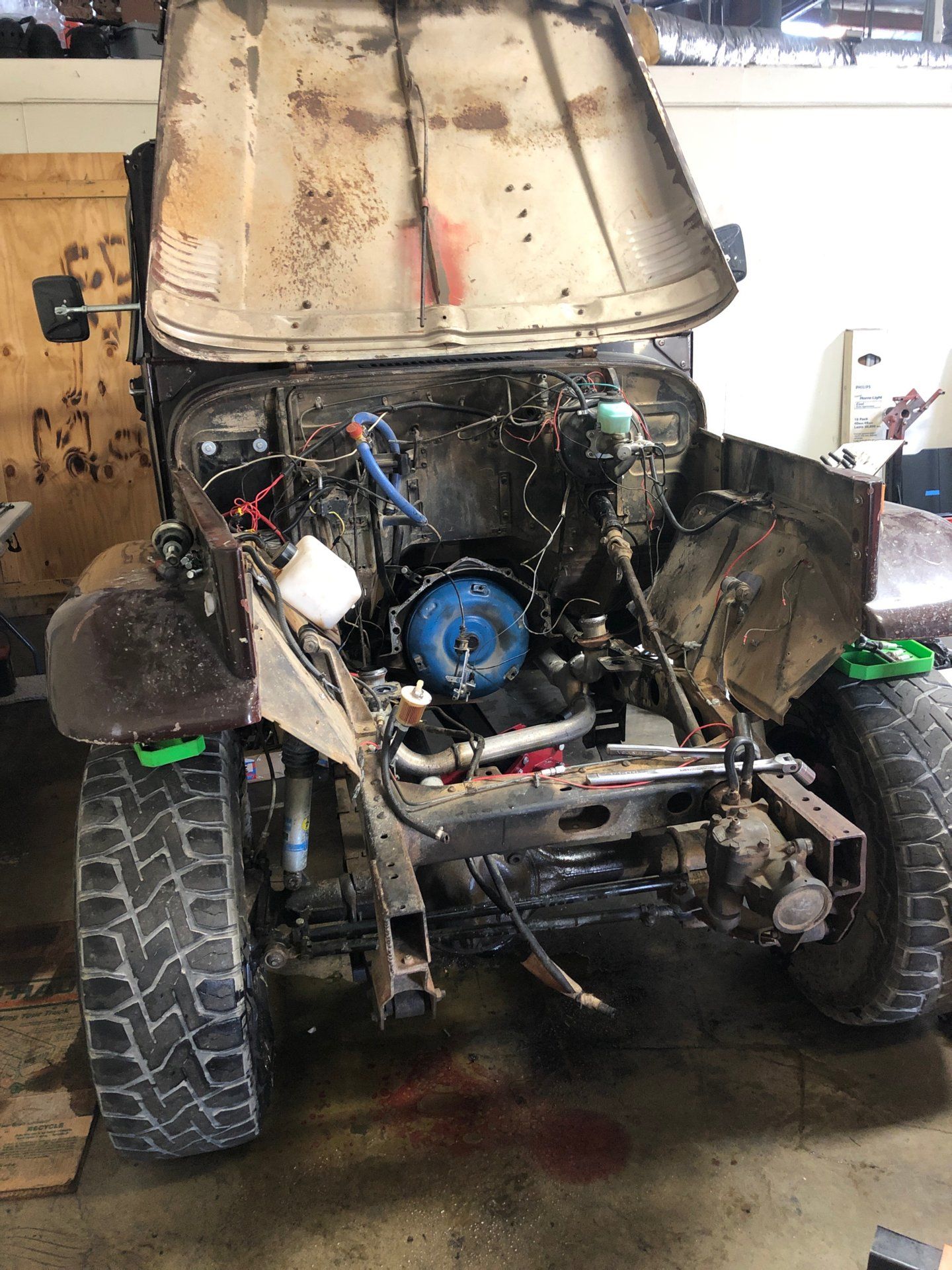

@BrianSanDiego - custom exhaust by local shop, will need tweaking as I’m going with a different set of headers (existing ones are funky and prevent mounting power steering pump). Happy to take more pictures and post if helpful.
I guess when I read your original post #1 above I skipped over the TH350 auto tranny. Now that I looked at your photo in post #14 above, I see you are running an automatic, soooo I wouldn't be overly concerned about doing drivetrain damage since that big blue torque converter is "drivetrain cushioning" at it's finest (fluid drive).
What has my curiosity though is the motor mount pads in the photo, they look rectangular, and laying perfectly horizontal (for SBC ???). The other thing that has my curiosity is the red thing shown below the exhaust pipe, what is it ???.
