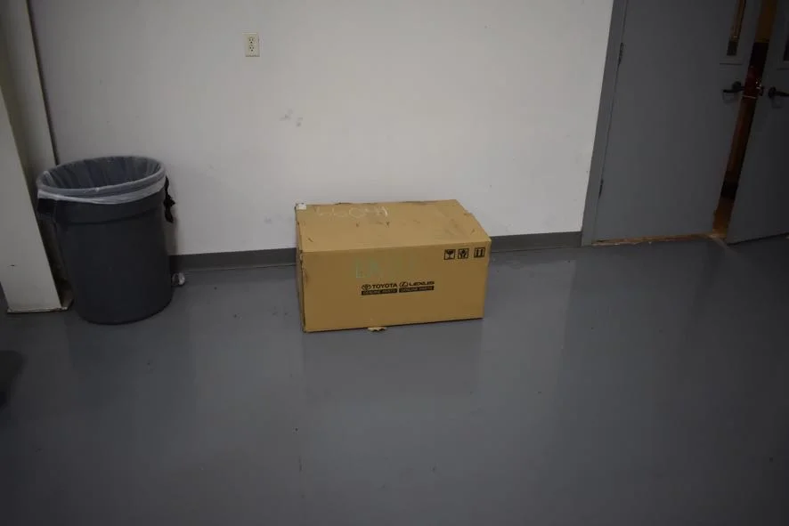

My local Toyota parts department shows a new OEM short block from Toyota 11400-66041 at $3644.51. There's no way I can rebuild my engine for that much in parts, let alone machine work. Right?
I just checked Megazip for piston prices, $81 each (~ $500 total). Then you got, rings, main bearings, rod bearings, cam chain, slipper and tensioner...
My gut tells me that assuming your cylinders just need a hone that the short block might be a tad more expensive. But, your time might be more valuable, if you factor that in, then the short block is the way to go.
Full disclosure, I rebuilt mine because: It was working fine so, I wasn't worried about any damage, and though I believed it would need to be bored out, it didn't. And, I wanted to do the work - get into the guts of it, so to speak. Cheaper? Maybe a little bit. I'm not motivated to calculate it. Certainly not extreme one way or the other. Now if a dealer wanted to charge, say, $6 grand for a short block, then, that's a no brainer. Or, if the shipping or pickup was expensive then that's something to consider as well.
happy trails
Rebuilding an engine requires a lot more than decking and boring, the piston rings on the 1fzfe are 2 mm wide, those old thick piston rings were not so kind to the cylinders. You'll still see the crosshatches, measuring with a bore gauge you will see the wear and tapering of the cylinders. The water jackets are going to be gunked up with rust, the only way to clean that up is to put it in an oven and then into a shot pean, once you do that you'll have to remove all the oil galley plugs to blow out the oil circuits. The plugs are stainless steel bowls that have been inserted into the block, you need to use a TIG welder to get them out, which is a lot of fun. Then you'll need to check line bore and rods for roundness and clearance. Since it went through the shot peen and the oven you'll probably have to replace the idler bushing. And if you get everything right you better hope and pray that you got every piece of machined particle out, if not you can kiss your engine goodbye. Now to get somebody to do all this for less than a few thousand dollars and not fck anything up. You think you can do all this and be under $3,600. By the way the short block only comes with pistons, rods and cranks, you'll still need to purchase timing chain possibly timing cover, oil cool cover. You might also need a oil cooler if the old engine left any debris in the oil circuit.
