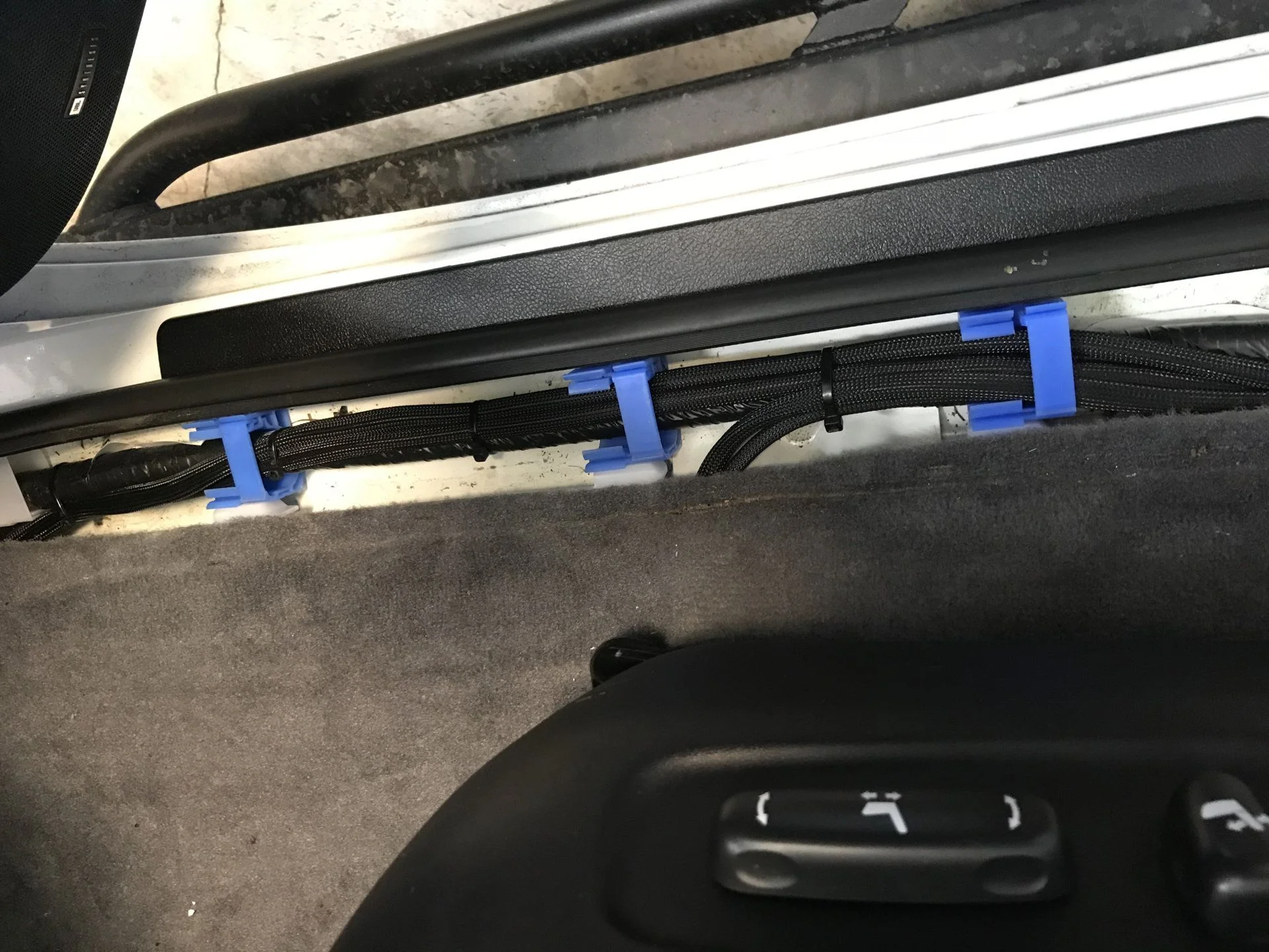

Just pull off the lower B-pillar trim. 14mm bolt and a wire clip and it's off. Then you have all kinds of room. The 200 is the easiest vehicle I've ever wired.
I have 2x 6ga, ham speaker, ham mic, ham display, 4x16ga all with mesh loom. No problemo. Ham speaker is mounted directly in front of overhead rear entertainment. For that, do not route down the B-pillar or you will block the side curtain air bag. Instead, route along sunroof, under PS visor, and down A-pillar in front of the handle.

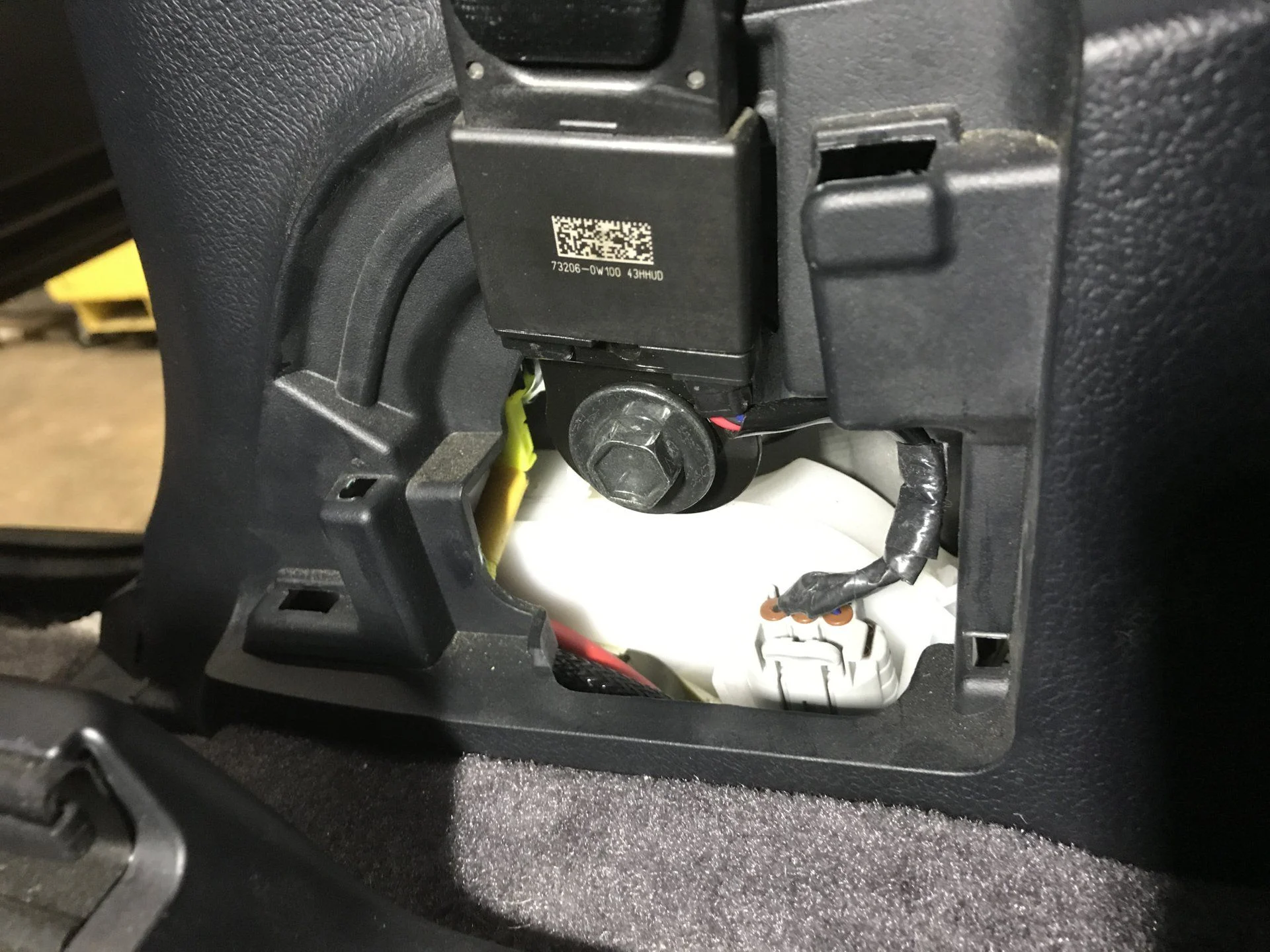

The little trim piece just slides up. Here you can see the clips and seatbelt bolt:
Thank you guys, I made it :)
Removing the pillar trim was the trick. I couldn’t make it work with just the door sill. Hopefully I’ll have the arb fridge up and running tomorrow night
